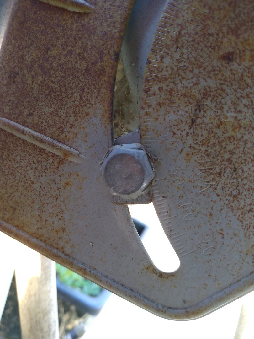

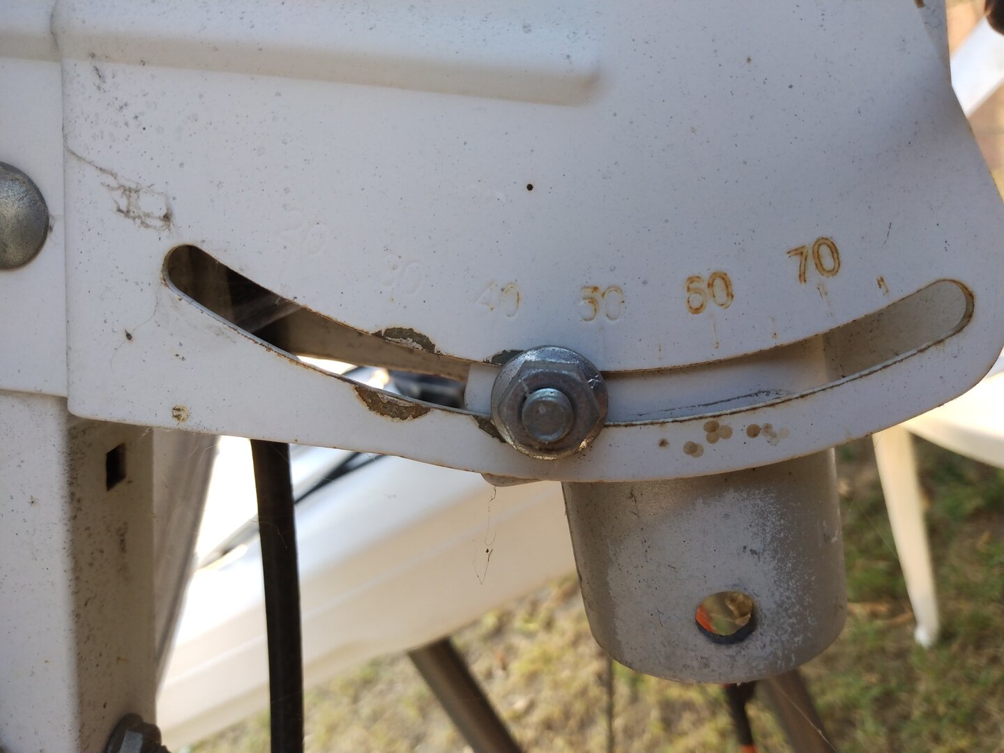

I saw a video on YouTube on how to correct a bent GeoSat Ku dish.
"Warping" is NOT the same as "deliberately bent due to kicking the $ hit out of it"... IMO anyway.The "shake it like a baby"-video?
If the warp is created with more force than a 'normal warp', maybe this method will work also (or even better):
Is this considered warped?
Greetz,
A33
That's the video that I saw. I'll give it a try this Saturday. Hopefully it'll work.The "shake it like a baby"-video?
Greetz,
A33
