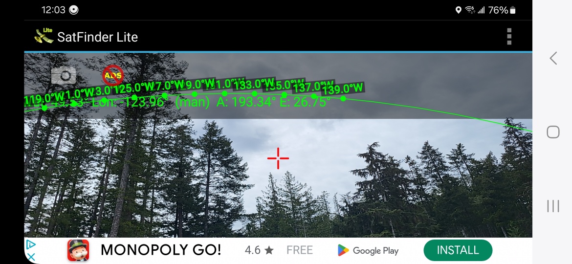

I like the apps called SatFinder Lite and Satellite Director on my phone. The first uses augmented reality to allow you hold your smartphone to the sky and "see" the satellite arc on your phone. Again, these free apps aren't the most accurate but they give a sense of what satellite you can receive.
