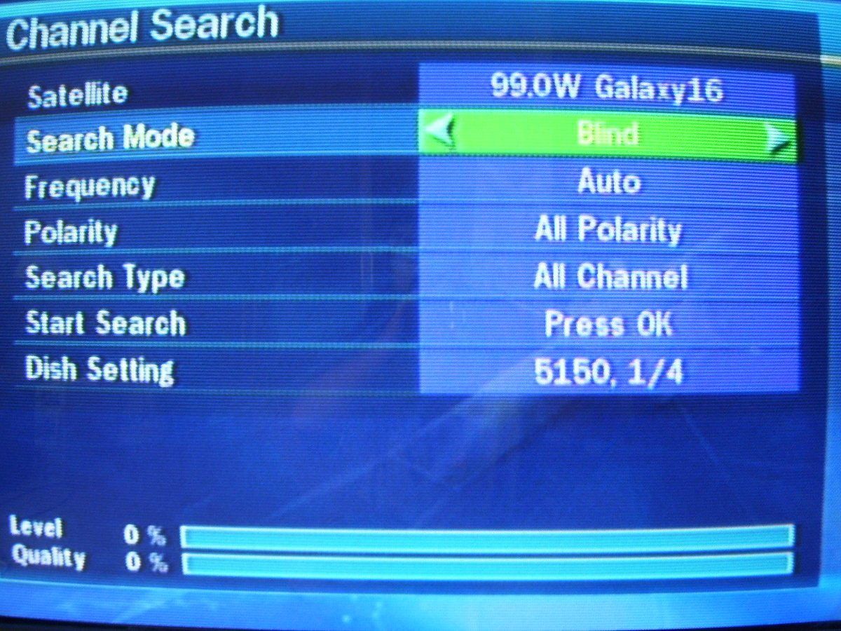

So I figured lets try a blind scan. The box claimed blind scan so lets see if it can live up to it (since we know some boxes claim blind scan only to either not have it or not work). You have 2 options
Auto-Scans the whole band (3400-4200 on C-Band) or Manual (allows you to select a frequency range). So I left everything as is (both polarities, show all) and hit scan. The neat thing is the last option is “Dish Setting” which shows what LNB LO and Diseqc (if applicable) its set up for. Scroll to that and hit “OK” and it goes back to the first menu we were at. The box now started blind scanning. One really cool feature is it shows how far in percentage the blind scan is done. The one thing I don’t like is it doesn’t show what transponders it picked up until the end. So I don’t know if it picked up no transponders or 40. Once the blind scan is done, then it scans those TP’s and logs the channels. So you can see what new transponders it picks up. The blind scan is rather fast. Not as fast as a Coolsat but much faster than my Pansat or Fortec. The Visionsat is also accurate and picks up all transponders (the Coolsat has been known to skip TP’s). Once the scan was done it tells you how many channels it logged (both TV & Radio). Hit OK and it goes to the first TV channel which in this case was CBS. I repeated the above info with G10 and got the channels all logged in. I did try a TP scan originally on G10 and it got most everything. The transponder list is pretty current. One minor drawback is right now there is only one satellite listed per slot. So if there is C & KU on a satellite (like G10) it lists both C & KU frequencies. Don’t worry. If there is DBS & KU (like 129 or 91) those are 2 different satellites.

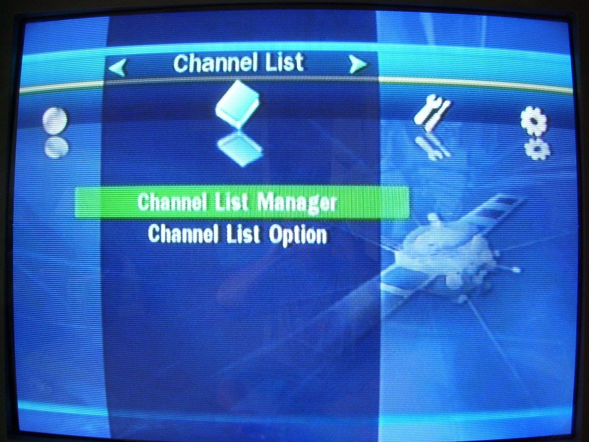

Hit OK and it shows the channel list. What is nice is at the bottom it lists the TP/Satellite info. Channel change is rather fast. Hit “Info” and it shows the channel info plus PIDS in the middle of the screen. The signal meter looks true unlike some boxes. I have seen everything from 26% to 90% Also it seems to hold the lower quality feeds better than some other boxes. Channel editing options are rather easy. One screen gives you the option to move, change, lock & delete. To delete, select the channel you want to delete and hit OK. It puts it on the screen into the right column but doesn’t delete it until you say delete. You can also scroll through the list on the “soon to be deleted” channel and rescue one if you screw up Editing names is very easy as is moving them around and sorting them by satellite. You can do this with the remote or use the channel editing software for it (it does not work with ChannelMaster but their channel editing program works pretty slick). I hooked up my 8x1 diseqc to see if it could handle it. Set up my G10/G4 setup, a feed from the motorized and a line from 119. I used ports 3,5,7 on the switch. The Visionsat handled it flawlessly including the port 5 22k on that G10 is on.

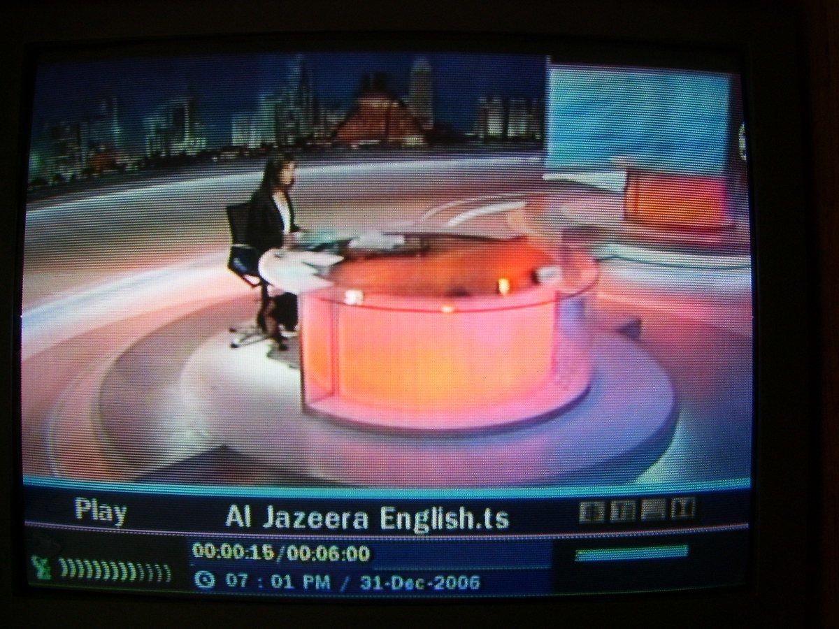

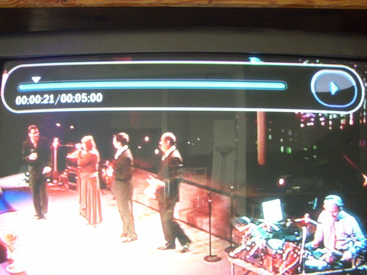

Now that I have channels logged in and USALS set up, now lets try out the PVR. It does not come with one but takes any Flash Drive or external hard drive as long as it has USB 2.0. The unit will accept a hard drive up to 500GB. This is nice compared to other boxes that have a PVR built in. Those you’re limited to a specific drive size or in some cases it will only accept a specific drive. This will work with ANY 2.0 compatible drive so you can go to your local computer shop/big box retailer and get the hard drive you want.
I didn’t have either handy so I went and purchased a 2GB flash drive that was on sale. I figured why spend the money on a hard drive if it didn’t work? (I’ve been burned before) so I’ll try a 2GB flash drive first. Here is where the fun began. Plugged in drive and it wouldn’t accept it. So I powered unit off, plugged in the drive and powered back on...nothing. By the way to see if it works its an option in the menu to format it. Since it was greyed out it wouldn’t give me that option. So after a few different tried I finally figured out how to make it work.
1. Turn the unit on
2. Shut off with the switch
3. Insert drive
4. Turn back on with switch
This was the way I got it to work. So I formatted the drive and started recording stuff. That 2GB drive gave me a 1 hour recording time. Recording is easy. See what you like, hit record. It says “recording begin” and in the corner it shows that its recording. Press info and it shows how far its been recording. You cannot change channels since it’s a single tuner but you can start at the beginning of the program while its recording. So if you start recording the game, go do some laundry and come back up and you missed a good play or a home run, you can go back and watch it and it will still record. You have full PVR functions while its still recording. One press of the info button and it shows how far “behind” you are. Press OK and it shows at the top of the screen the record length and in a percentage of how far behind you are. I recorded a couple channels. To bring up the record list, press eject button (don’t ask me why) and it shows on screen the list of programs. It lists it by channel as logged on the channel list. You can rename the show if you’d like (so instead of it saying “KLMN” I changed it to “Cops”. You can replay from here and have a full PVR function (fast forward, pause, rewind, etc). The good part is I’ve worked with other boxes that stutter when playing back the program. This one doesn’t. It plays back nice and clean. So you can record it to a DVD or if you have the correct program on your computer, you can play it on your computer. It uses a .ts format.
I also went in and set a few timers to see if they would record. The clock is bang on which is good if you want to record. Just go in, set the times and channel. Select “play” if you don’t have a drive hooked up or “record” and it will record to the drive. I tried it on a fixed system and a motorized and both went off without a hitch. I did find out the minimum recording is 5 minutes though.

-Blind Scan-8.5 (I’ll explain more)

-Channel List-7.5 (I’ll explain more)
-Ease of moving/changing names/deleting-9

-the blind scan. I already mentioned it above but on KU if you leave it at auto it scans from 10700-12900 which just makes scans go long. So you have to change it to manual and set from 11700-12200. Nuisance factor for me is a 1. Its no biggie. Just one extra step to do. Some people may not like it.
