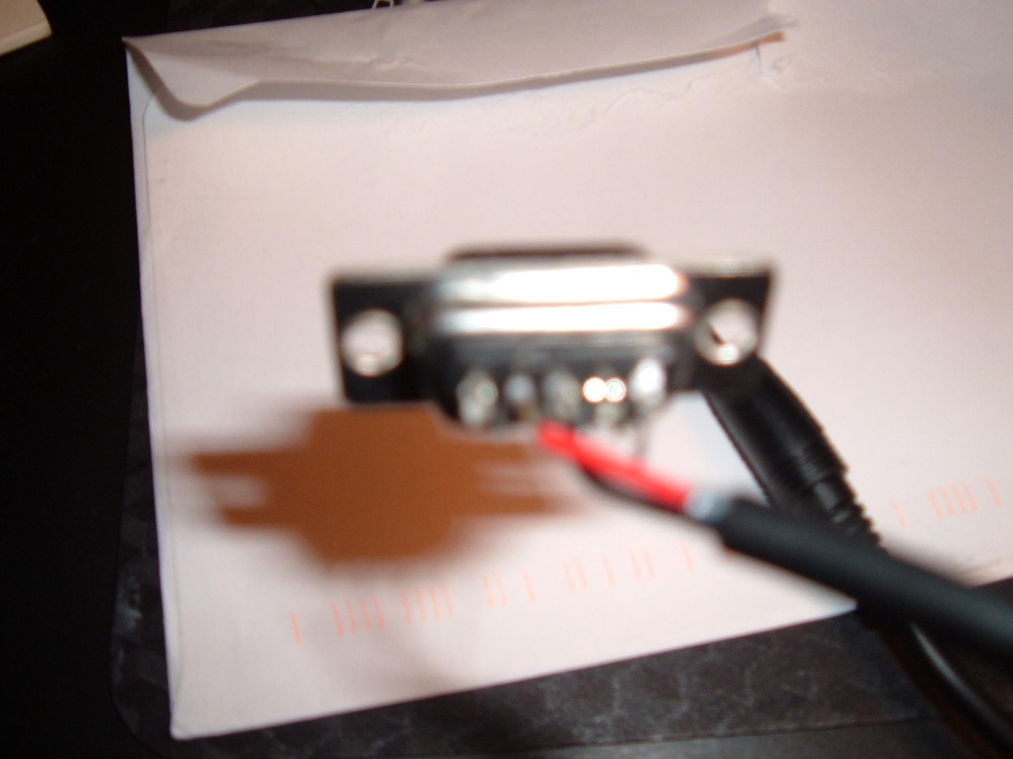

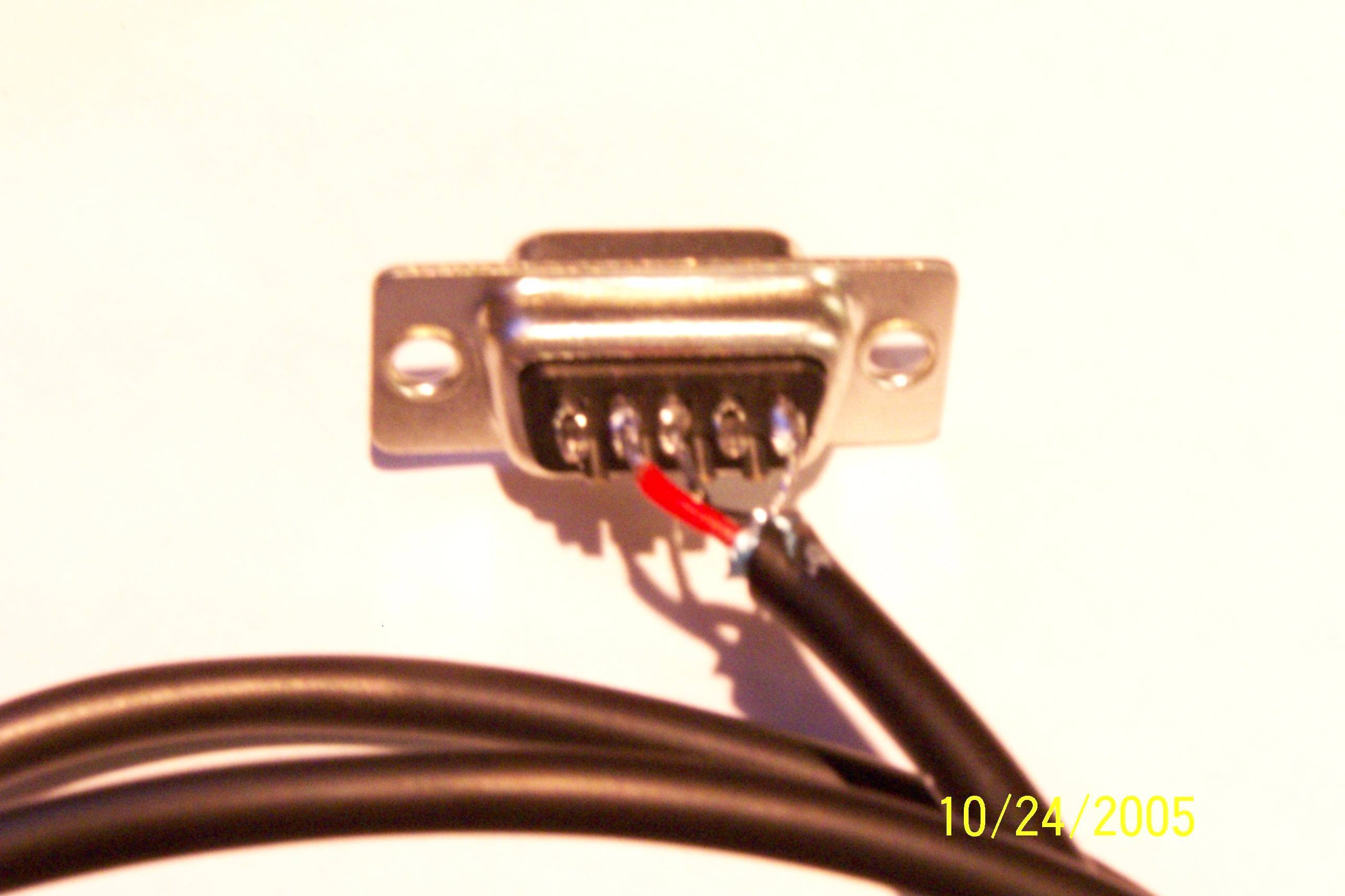

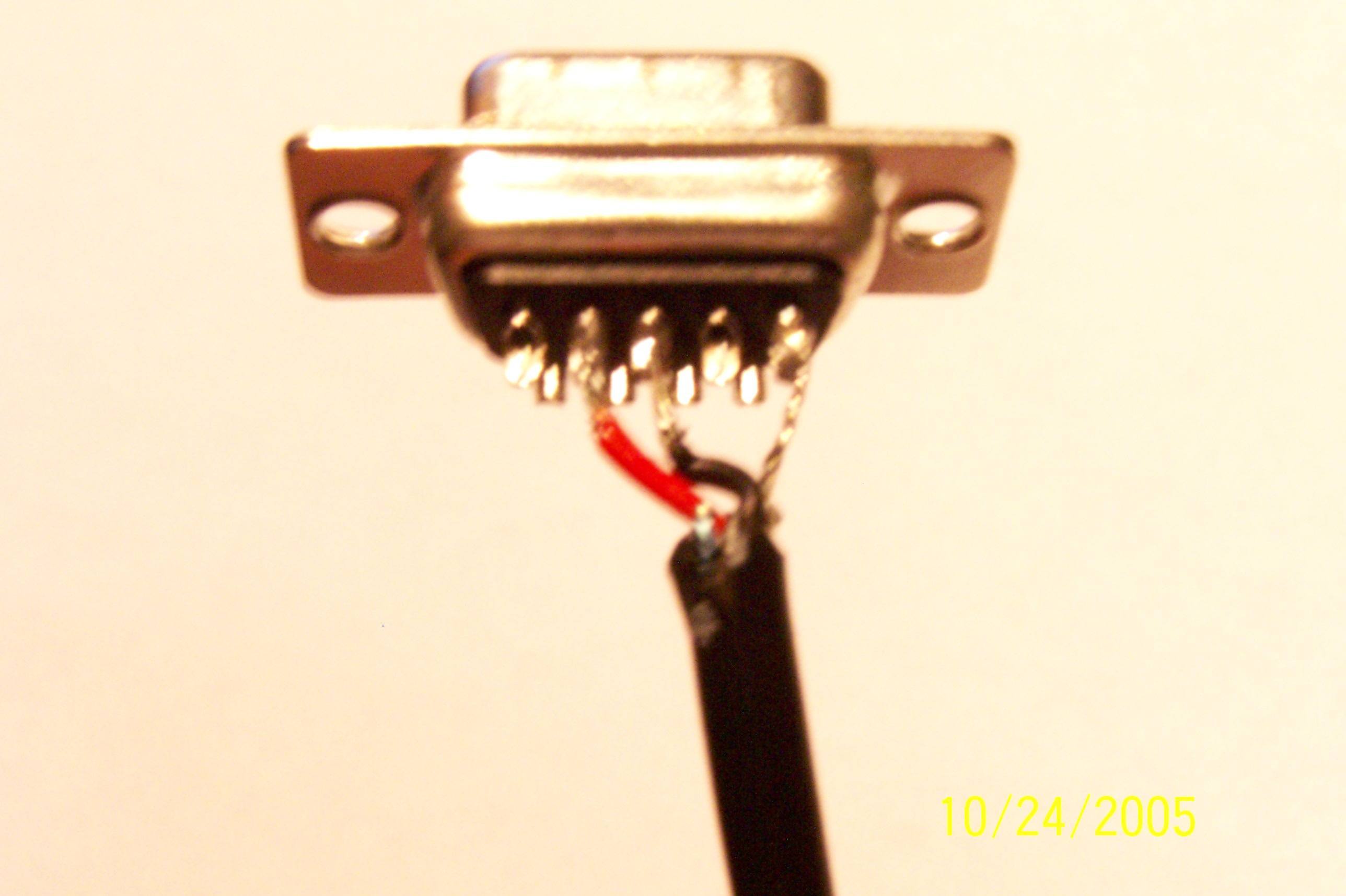

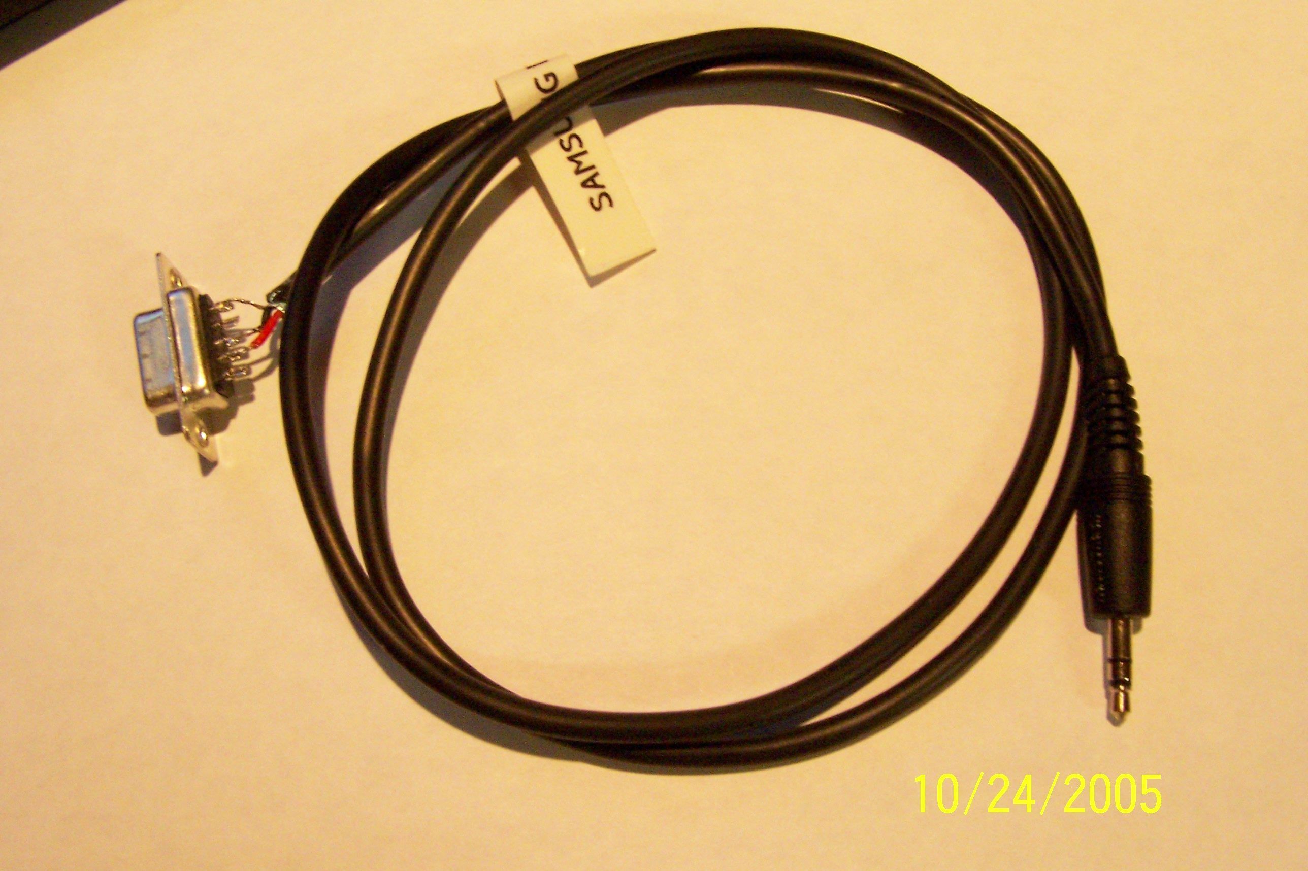

Wow! You've got guts, talrudeboy. How did you make the cable? Can you give me the specifics, as I've been trying to figure it out but I can't seem to get the PC and TV to connect. What parts did you use? Maybe I'm using something wrong.
Guts is right! But I did not spend $599 for the TV so It was not that bad but it was Scary!
Watching the % go from 1- 100% complete is a rush.
Note- If you ever have a blackout while doing this you are screwed!

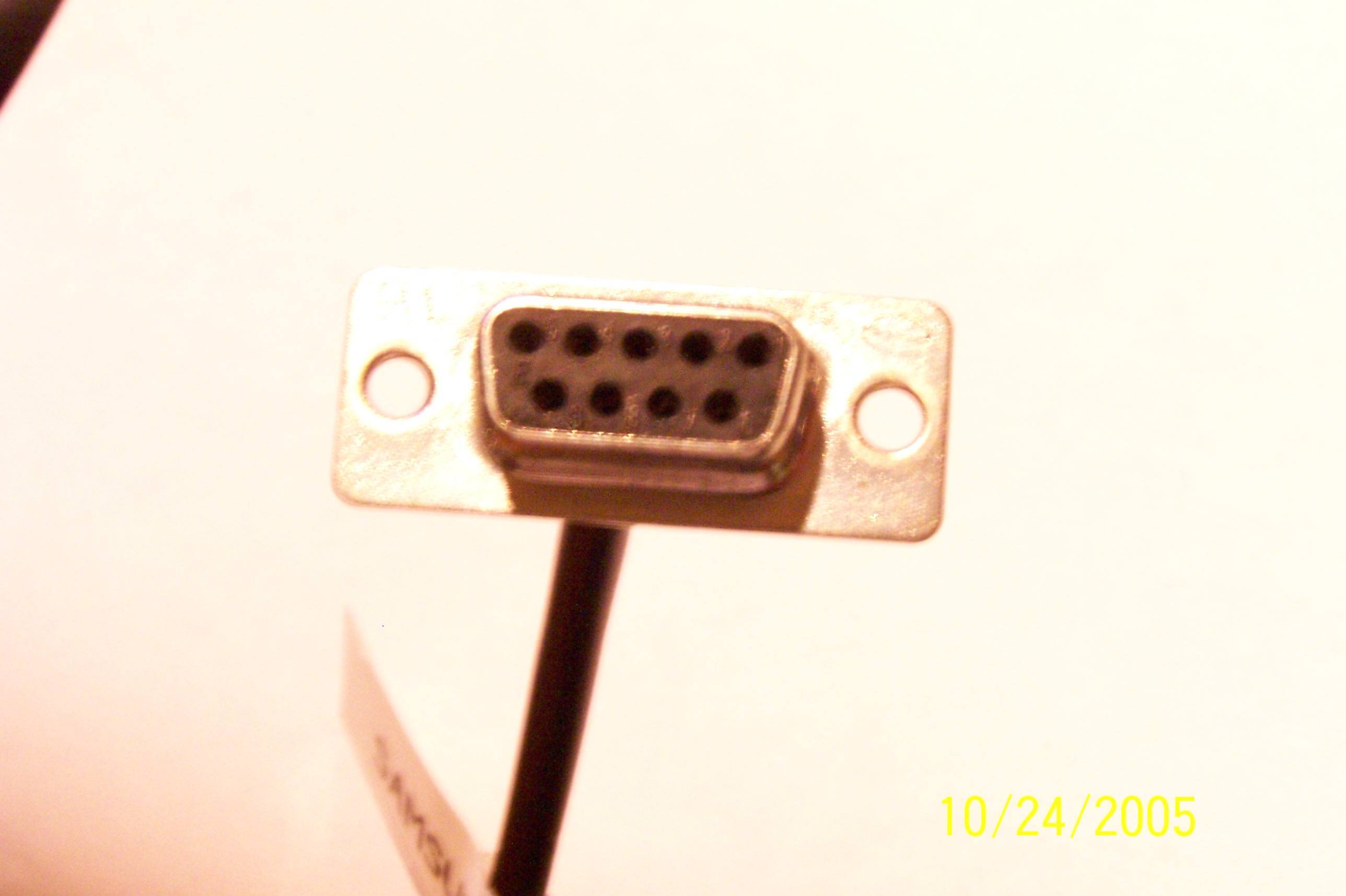

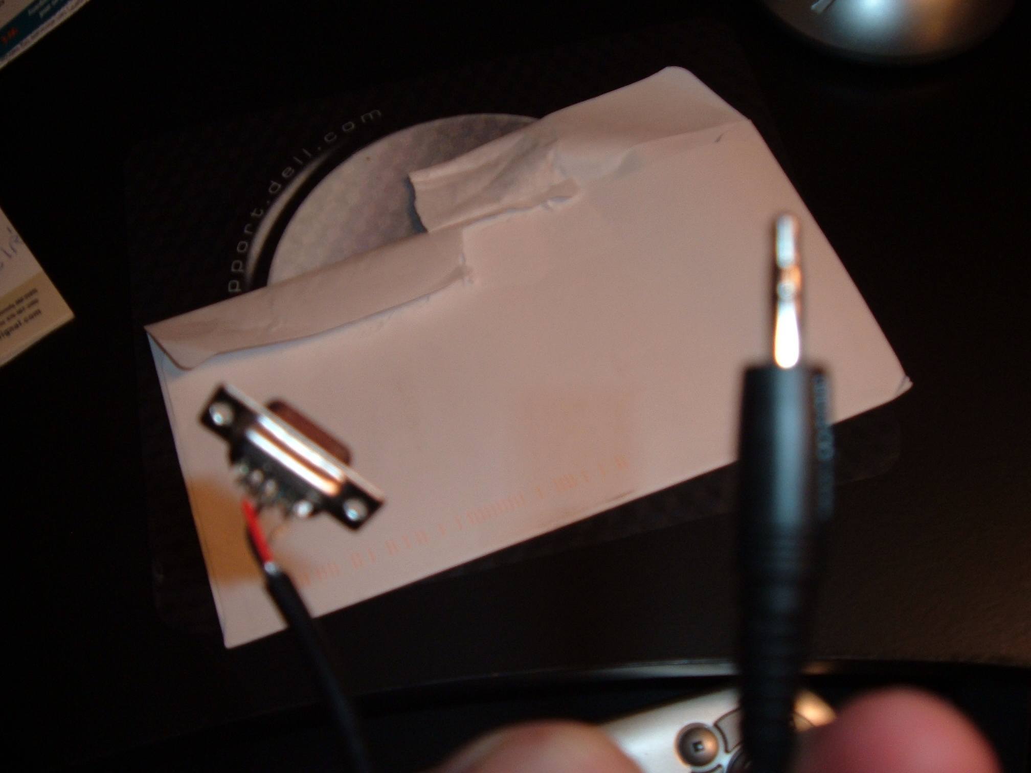

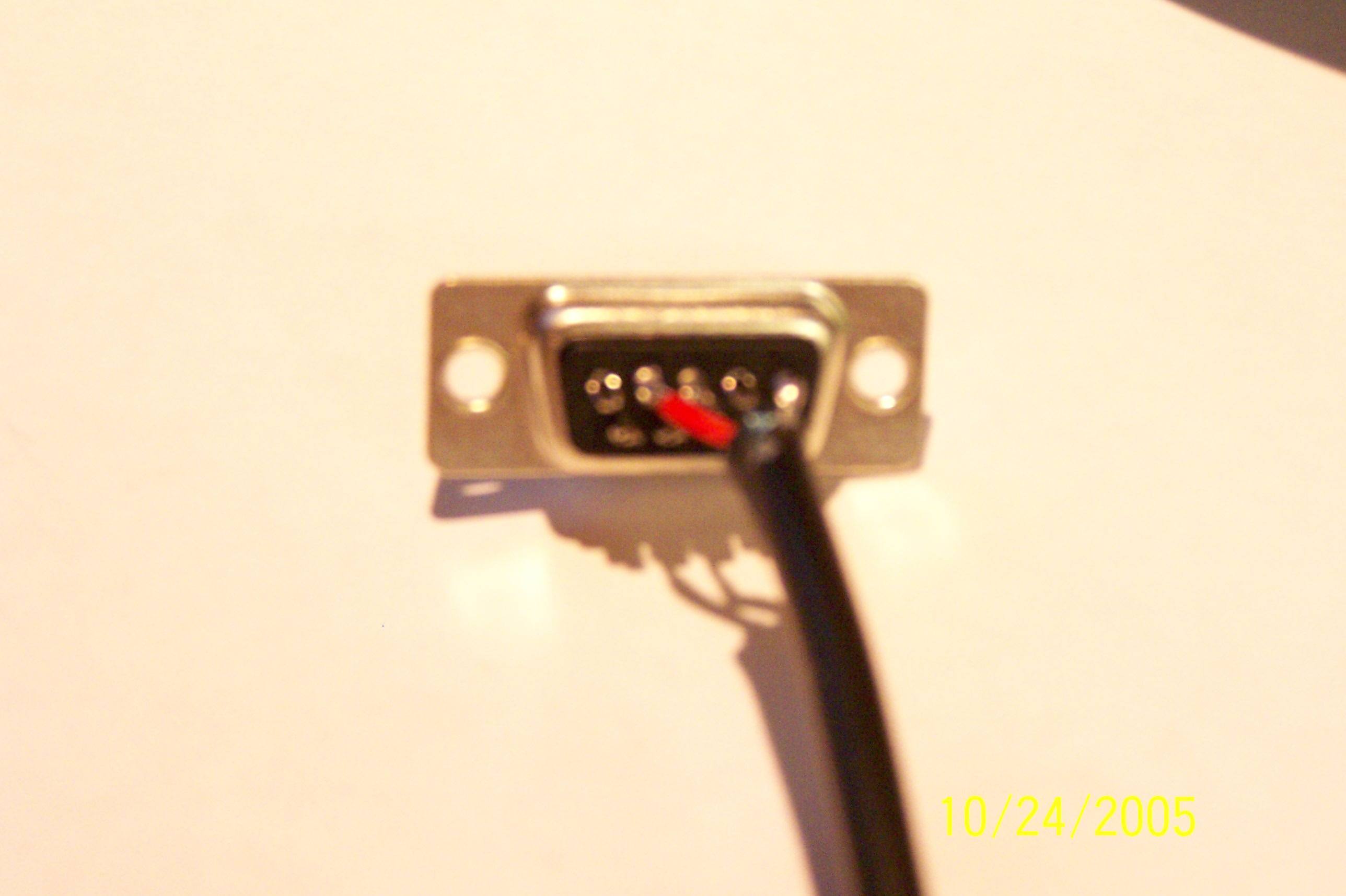

Parts:
Radioshack
1. Shelded Male 6 feet headphone jack.
2. Femal DB9 connector (No wire attached)
Tools
Soldering Iron
Instructions.
1. Cut the Headphone wire in 2
2. Solder The Red wire to Pin 2
3. Solder the Black wire to Pin 3
4. Solder the silver wire to Pin 5
Thats it! 5 Mins
Pics attached!
Reference to the instructions that came with the Firmware. (Read carefully)
The batch file defaults to Com1 so be aware of that!
It took me 2 tries. errors connecting.

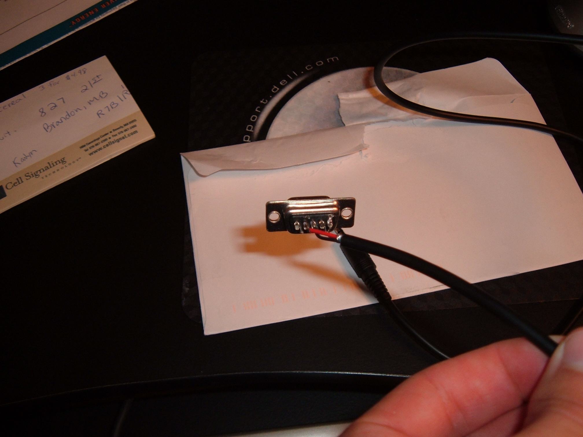

Telseth,
Do you have a snapshot of the cable you used. I'd be interested to see how it looks like. I made my cable and had unfavorable results upgrading my TV set. Thanks in advance.
Spica
telseth said:
I did the firmware upgrade on my TX-P2670WH and now can get HD over basic cable. (autoprogramming gave me some grief as it found more channels than there were...) but, I got it fixed now and couldn't be happier. I also could get NBC HD over the air (which I couldn't do before).
Thanks!

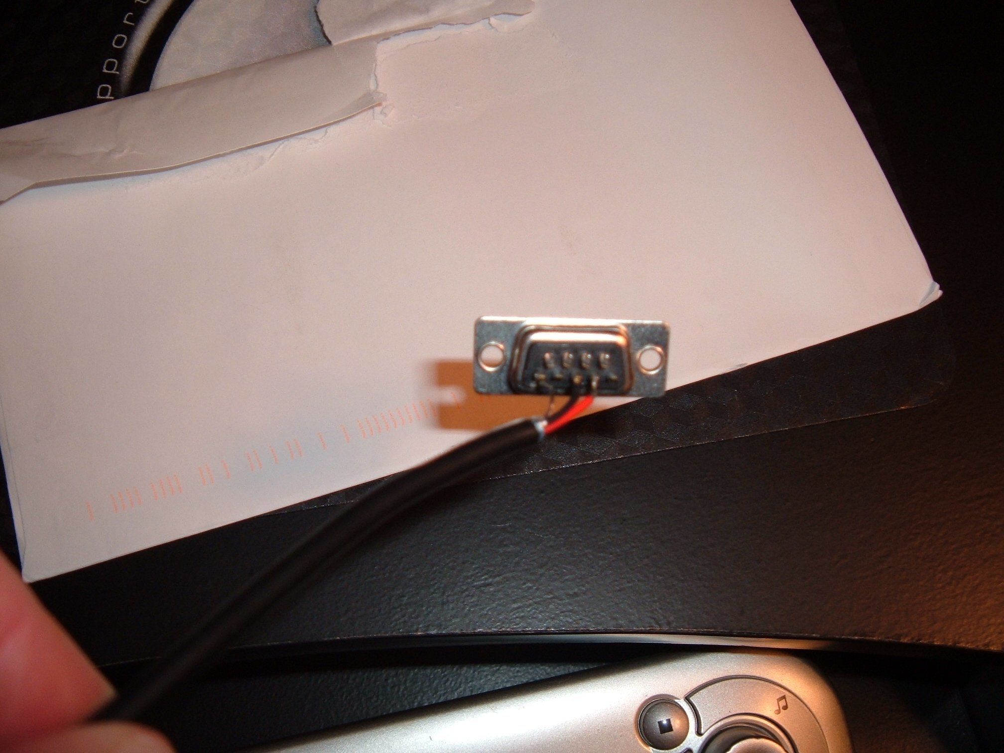

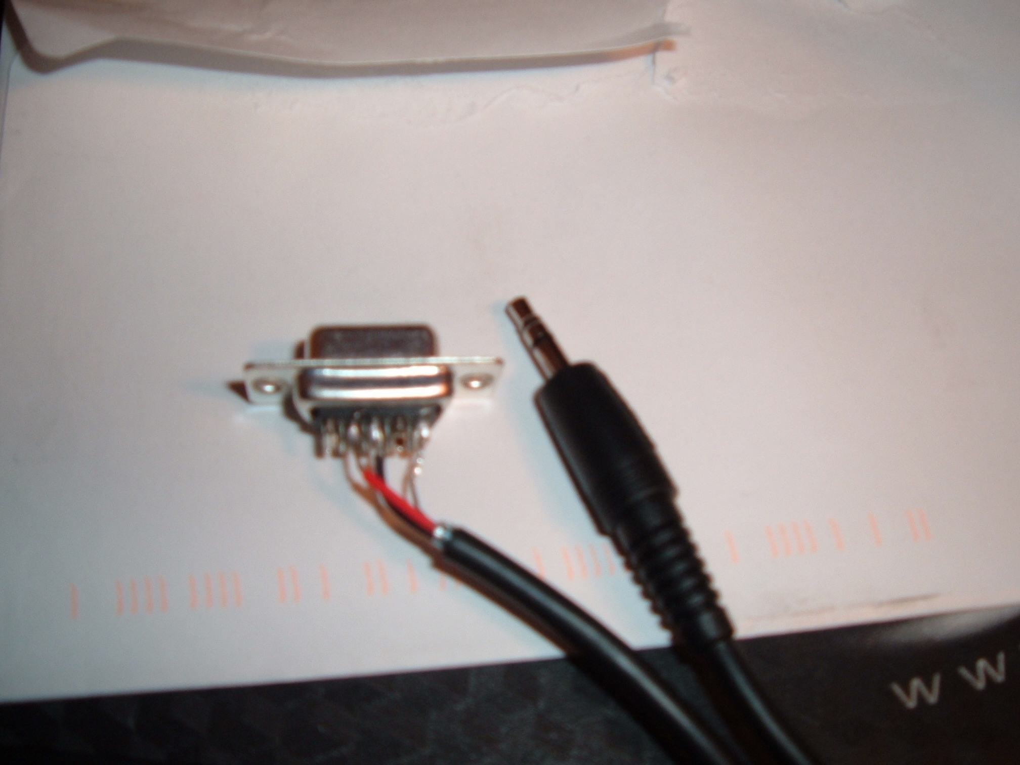

Yeah, my camera doesnt like to do closeups but, I followed talrudeboy's directions.
1. I got 6 feet of 1/8th inch stereo headphone cable.
2. Got a female D9 Connector and
3. Cut the cable in two and stripped the wires.
4. Numbering the back like so:
1 2 3 4 5
6 7 8 9
soldered
a. Red to two
b. Black to three
c. Silver (ground) to 5
I also included a photo of the tv playing the Pen ST / FSU game in HD to prove it works.
