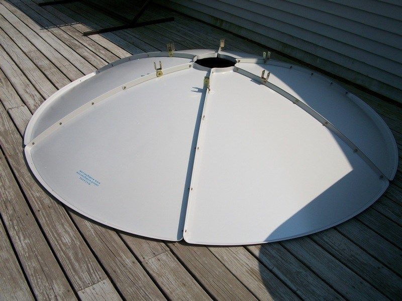

• Dish arrived in good shape and was well packaged.
• Robby from WS International provides excellent service and support.
• Dish assembled easily even though the 1 page manual lacked detail.

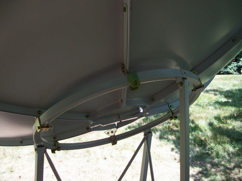

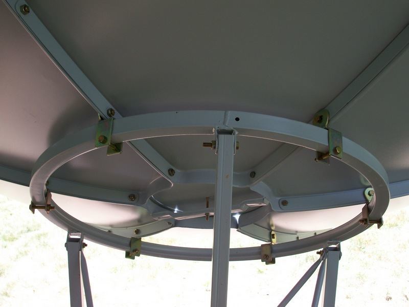

• 12 reinforced plates came with the dish that adds greater support to the panels. (Please note that the manual now only shows 6 reinforced plates)

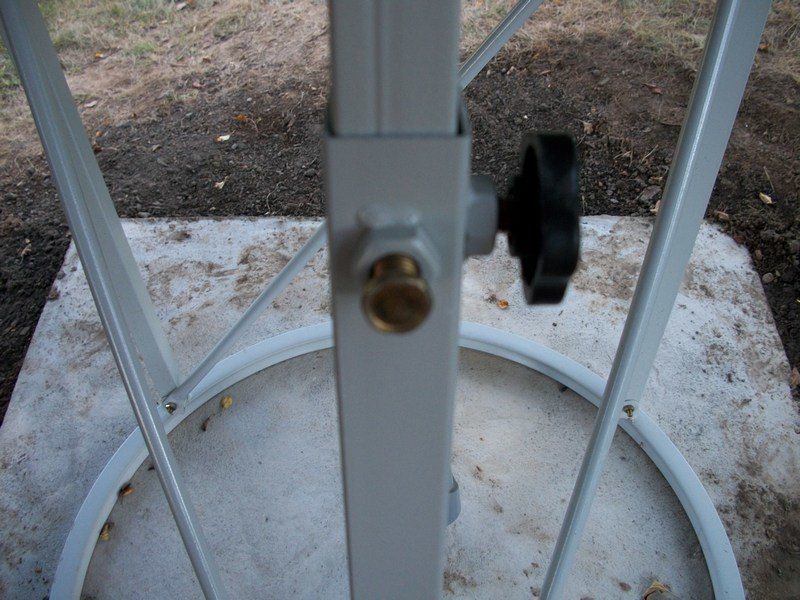

• Elevation bar has an additional bolt in addition to the knob bolt to firmly secure the elevation adjustment. (Please note that the manual no longer shows an additional bolt)

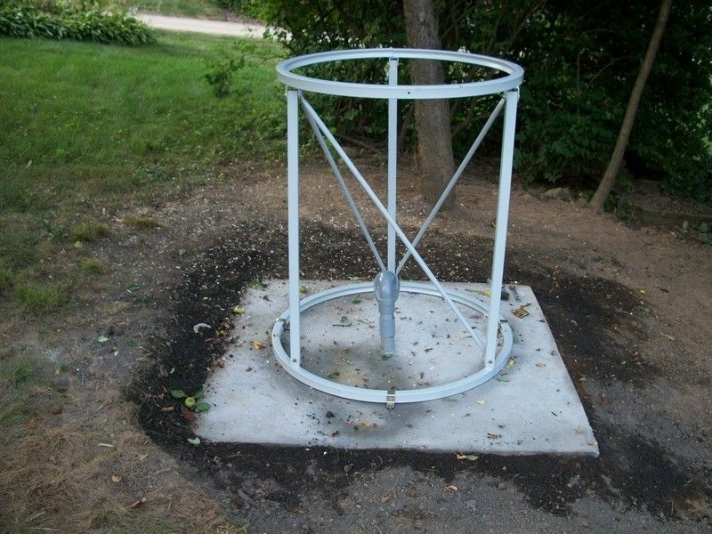

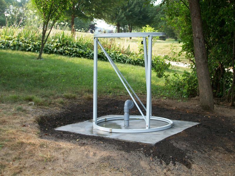

• Base is well designed and is made of heavy gauge steel.

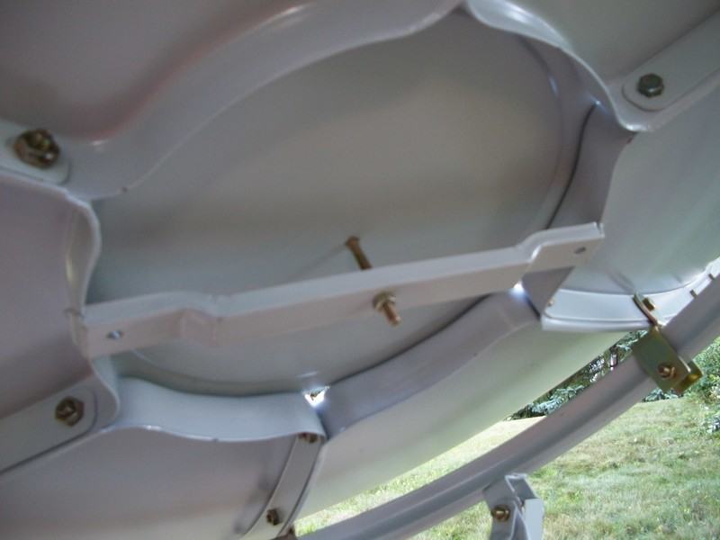

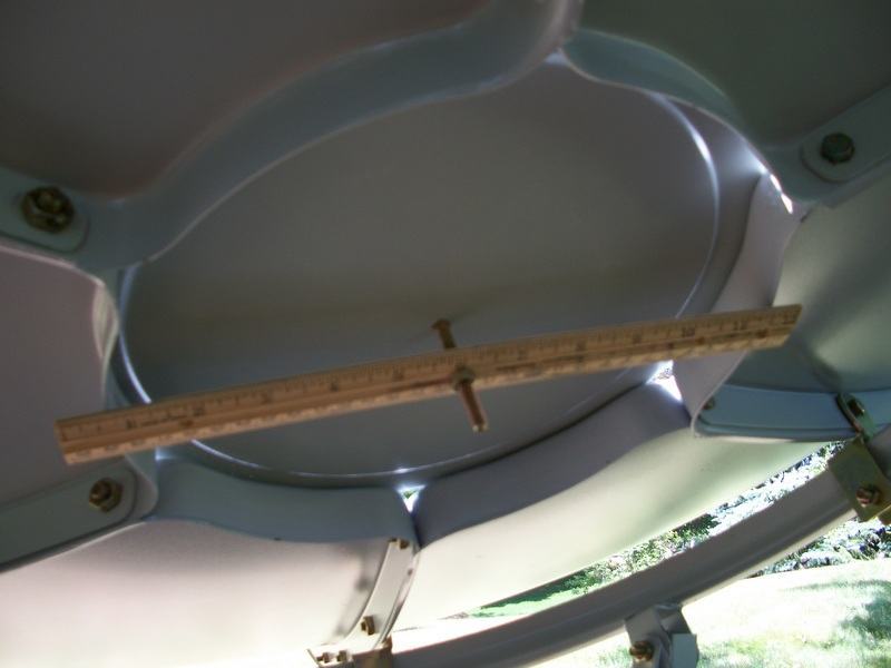

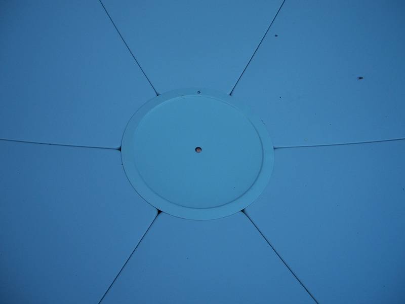

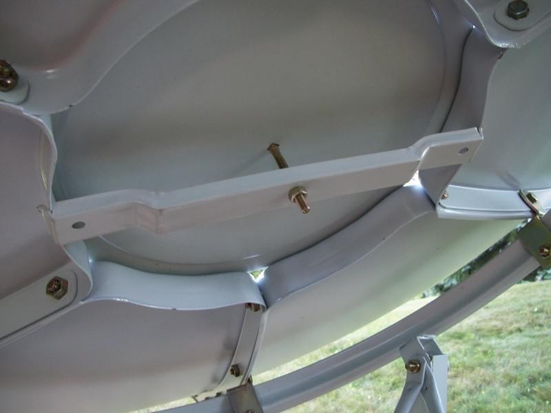

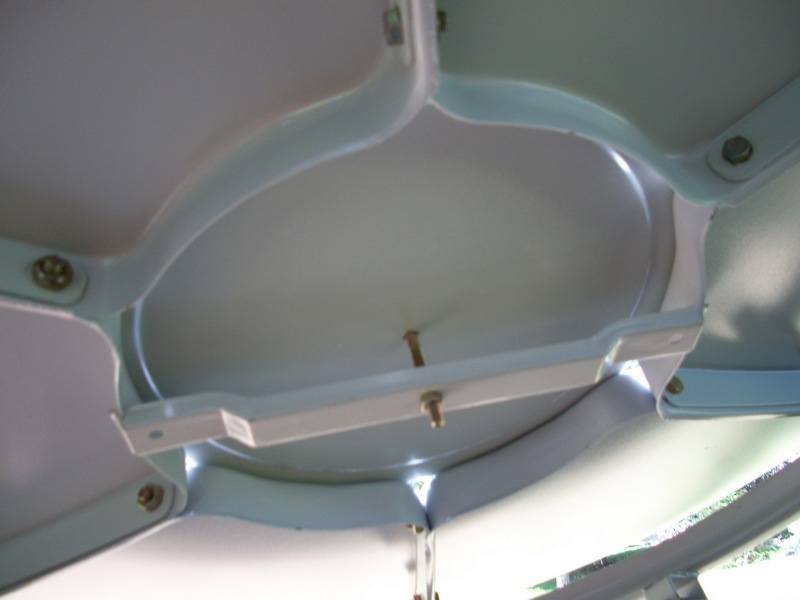

• Center panel stabilizer is too short and is difficult to install. I had to bend the ends out in order to secure. Please see the attached pictures.

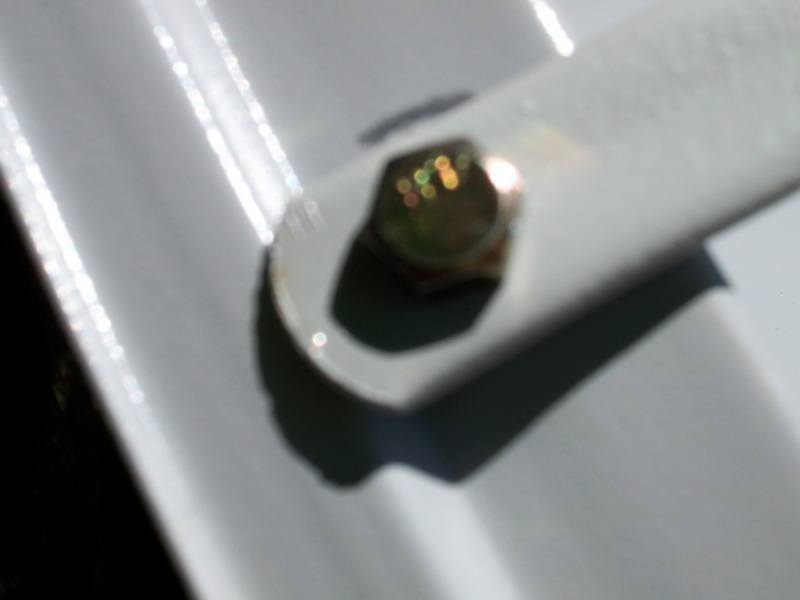

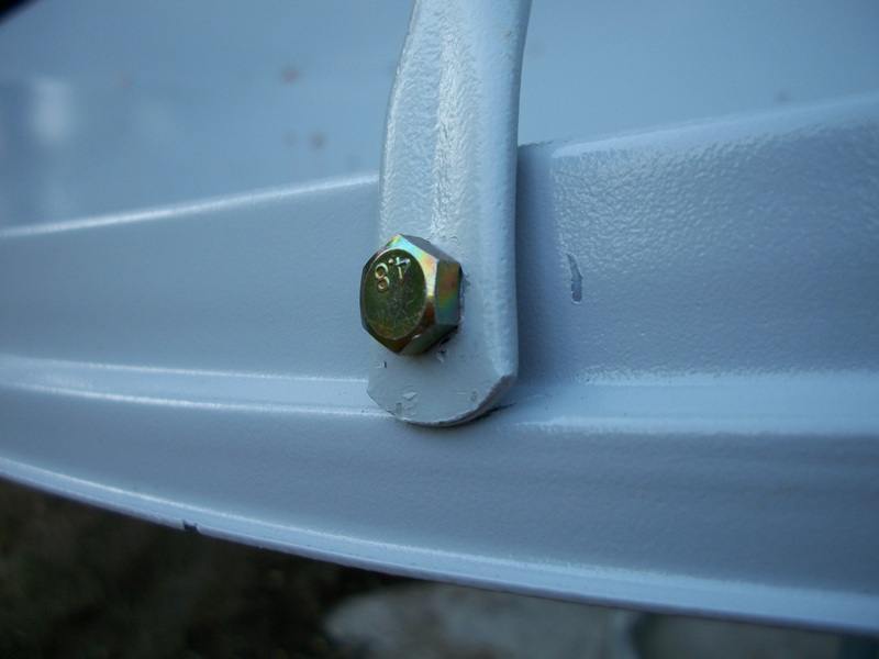

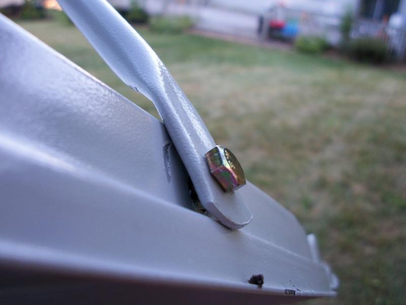

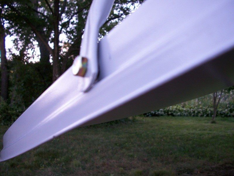

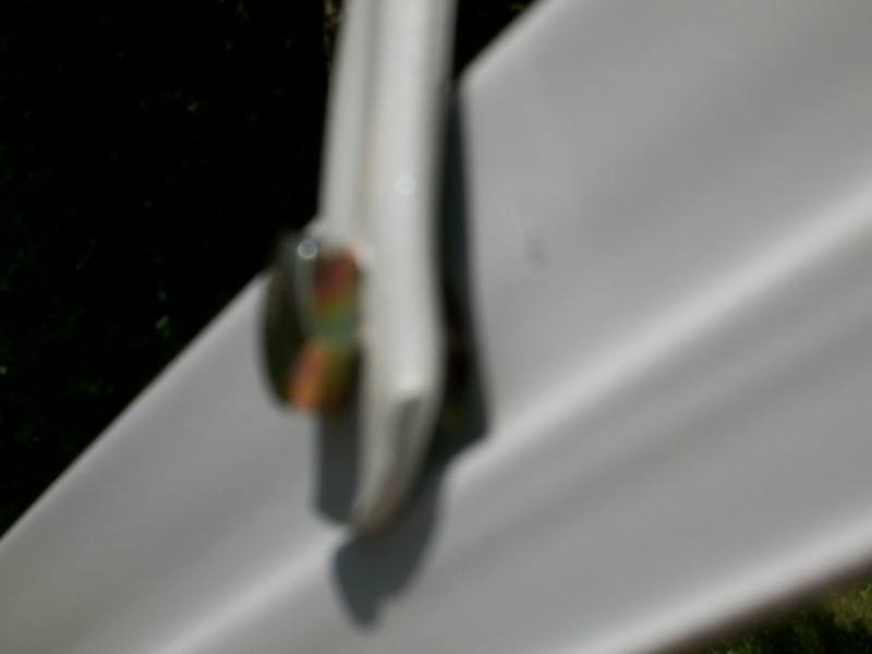

• Feed support arms should be bent near the rim of the dish in order to fit correctly. Mine arrived straight and had to be bent in order to curve around the rim of the dish panels. They also overlap on the raised rim of the dish panels making it difficult for the short hex-head cap screw to be secured with the nut. Attached pictures show the gap this creates.
• Three mounting clamps were provided. I feel the base should be secured using at least four mounting clamps for added strength during high winds. (Please note that the manual now shows 4 mounting clamps) Robby was kind enough to provide me with additional mounting clamps for my installation.

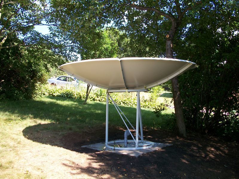

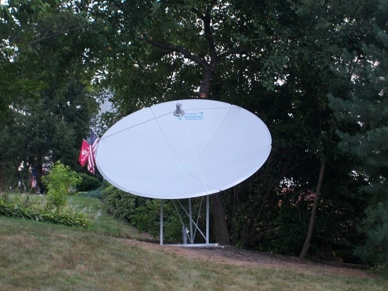

Final Thoughts:

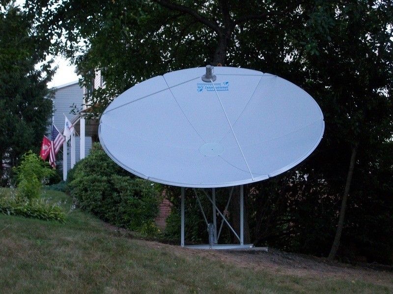

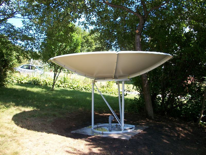

Even though this dish has a few weaknesses, it has many strengths that make this dish a great value and I recommend it highly to anyone looking for a 240cm dish antenna.
