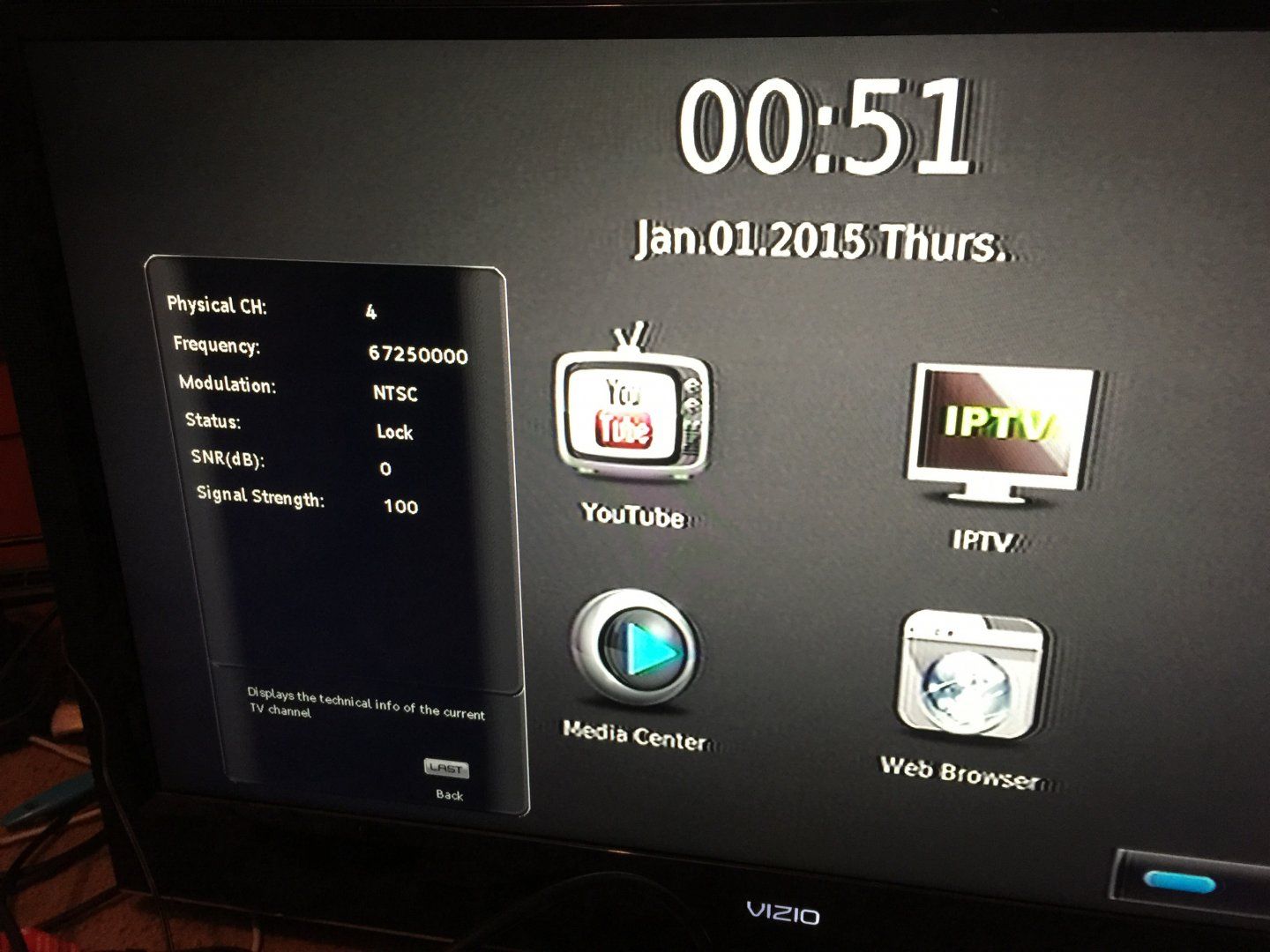

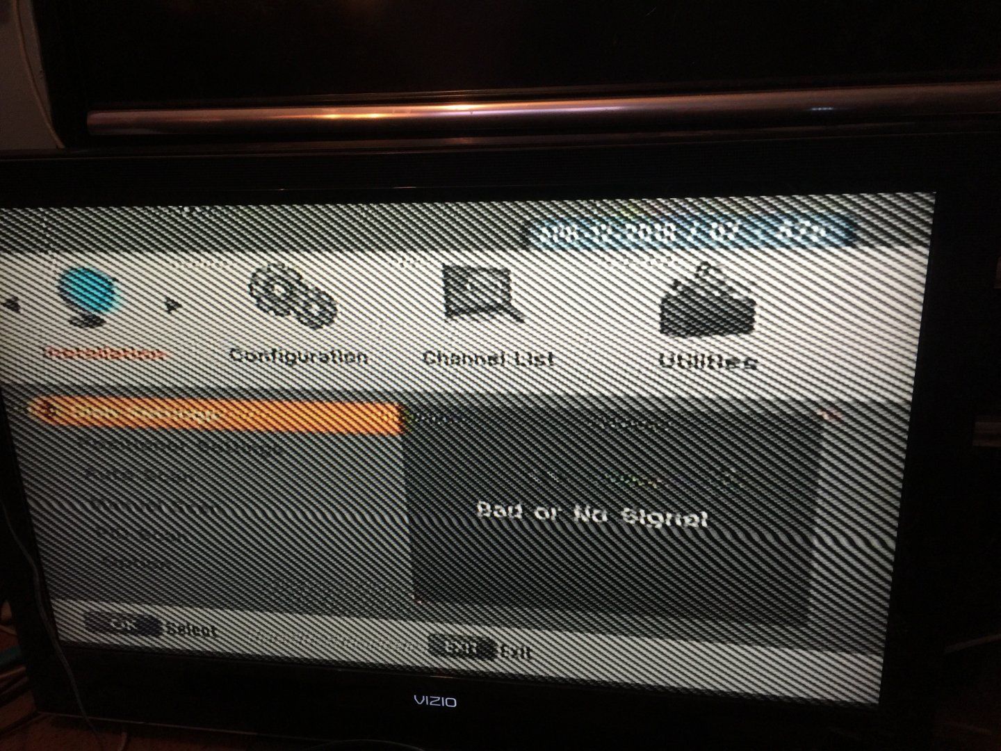

hello i need help with something and i really hope that im in the right spot and if im not im sorry and just let me know where to go and ask.
so heres what i need help with. i have two rf modulator 3/4 channel type and want to combine the two together. one signal on channel 3 and another on channel 4. when i use a splitter backwards it seems the channels bleed over onto each other. it seems i only can run one or the other cant run both of them at same time. looking to be able to change channel on tv from 3 to 4. first pic is on channel 4 second pic is on channel 3. im thinking i need a filter of some sort? thanks

Generally speaking analog channels that are adjacent never worked very well.
I'd suggest that the "General Home Theater Discussion" forum would probably be best for this kind of question since analog modulators introduce more problems than they solve in modern cable TV and satellite setups.
Those cheap rf modulators are very wide so they tend to bleed to adjacent channels so just buy a external modulator and put one on a different channel.
