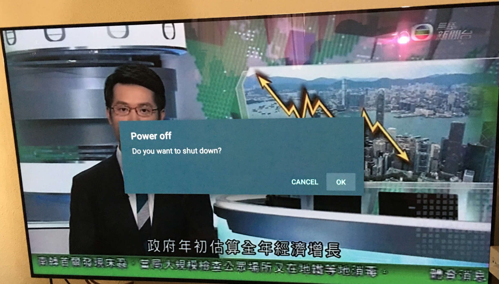

Interesting. With the 50.0 and 52.0 since it has a independent TV Power button so I can keep the TV on when pressing buttons on the remote and in SAT mode, nothing happens when I press the power button on the left for more than 1.5 seconds and release. On the Hopper, if I press and release the power button, nothing happens but if I press the power button for more than 1.5 seconds and release, I get this popup but the live tv still in the background but not the screen saver with a menu like you did.
