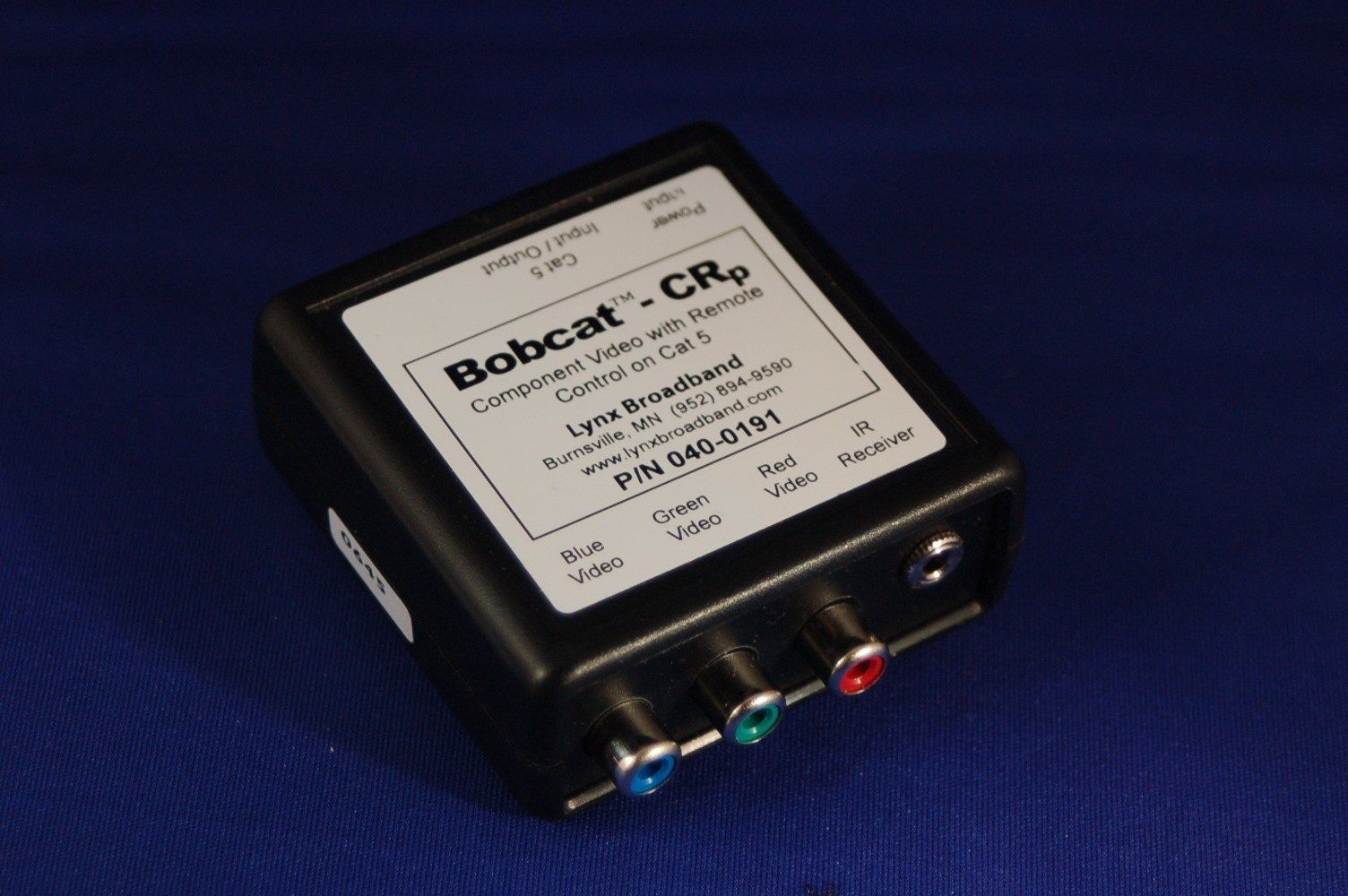

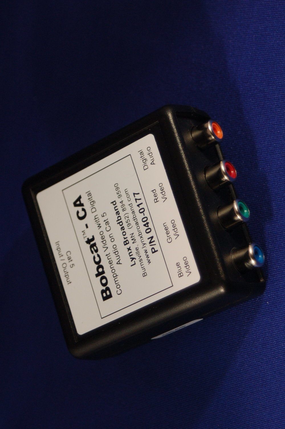

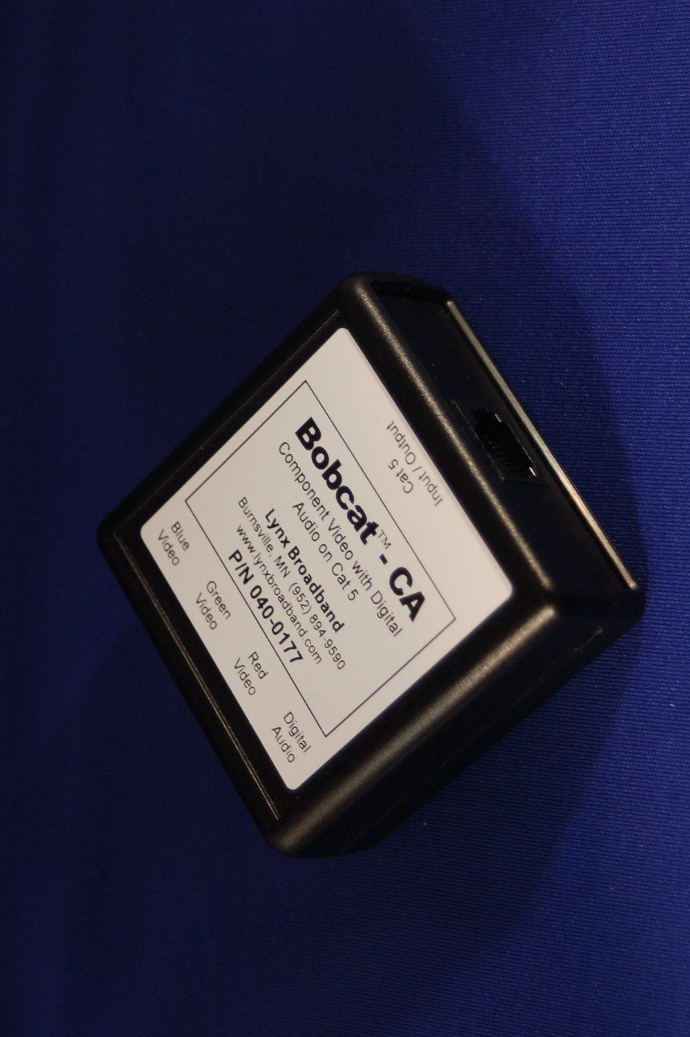

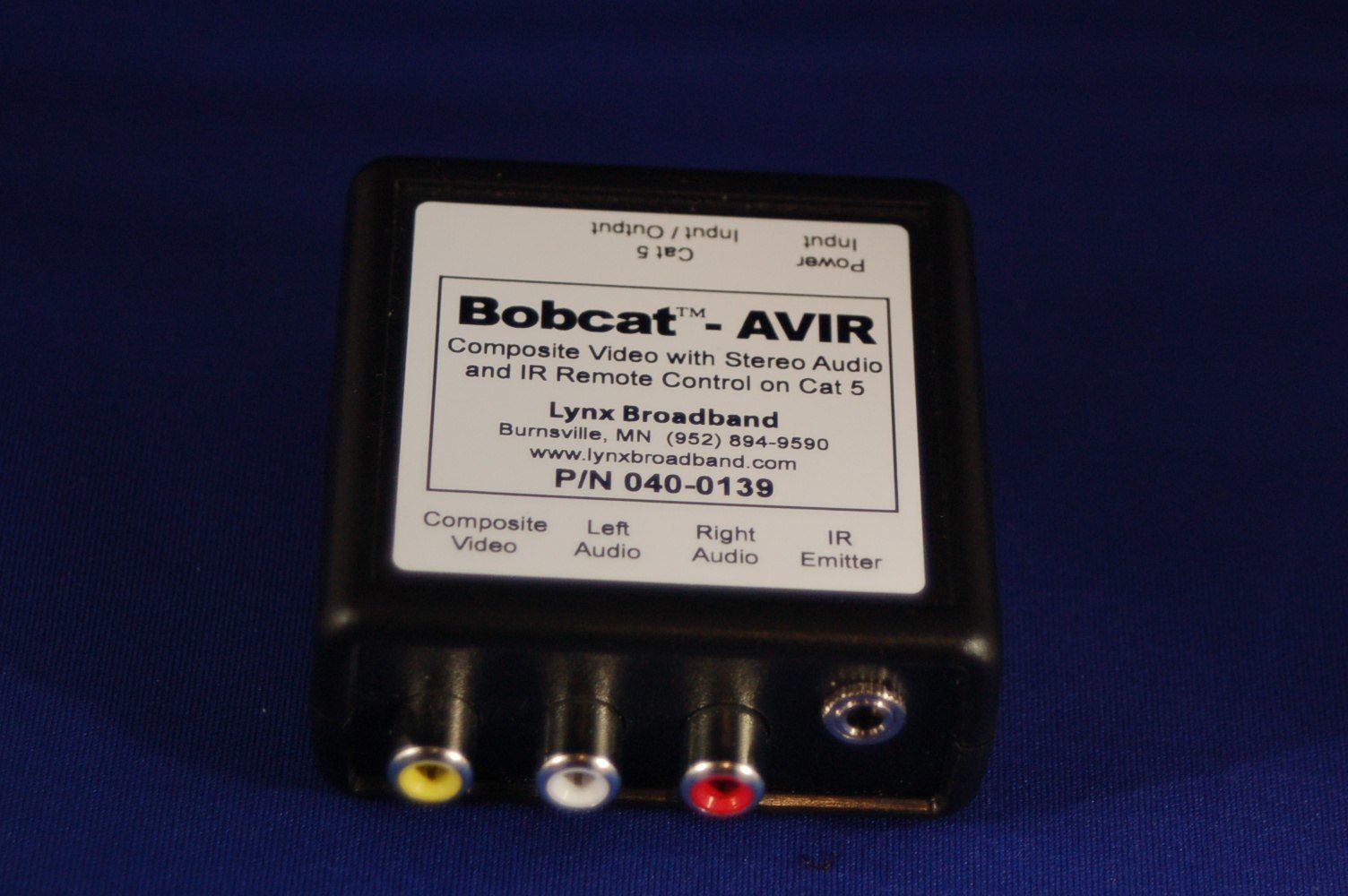

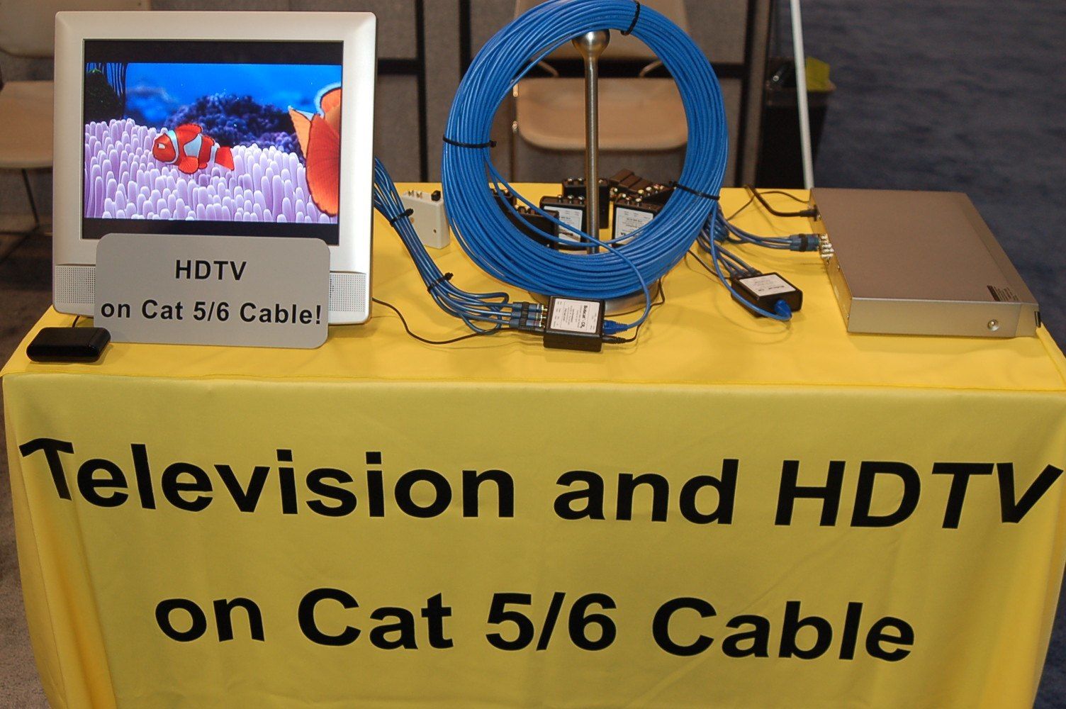

Here is a great way for you to get HDTV in a place where you dont want lots of wires or even satellite receivers.
Imagine taking your HD receiver (or even non HD receiver) and putting it somewhere, now you just need to run one wire to your TV, and that is a cat 5 or 6 network cable. Well the future is now.
Introducing the Bobcat from Lynx Broadband, who makes and sells these dongles which converts almost any video signal and send them over to cat 5/6 cable. On the other end of the cable you attach one of the converters which changes the signal from Cat 5 and into a usuable format for your TV.
There are many models available some will even act as an IR repeater if you unit you want to control does not have a UHF remote.
Amazing technology, yet it seems almost too simple!

vince, I notice the connector says "cat-5" not "ethernet". I suspect a dedicated cable is still required.

Still needs 2 cat-5e runs boxes if you want sound & video.
Each box basically does 3 lines. Since each line requires 2 wires from the cat5e line, for signal and return, the cat5e run caps out a 4 (4 pairs).
This in turn requires 2 cat-5e lines for component (3 pair for video, 2 pair for audio).
All these boxes do to change an RCA connection to a twisted pair line, with something added to balance and attenuate the line.

I've been using these for the past 2 years. Work great. If you just run the one cable and plan on using analog audio, you can run a mono audio cable. The digital RCA can handle composite video or audio. I did have some interference over a long run (over 80 feet). But overall, they are pretty nifty items.
