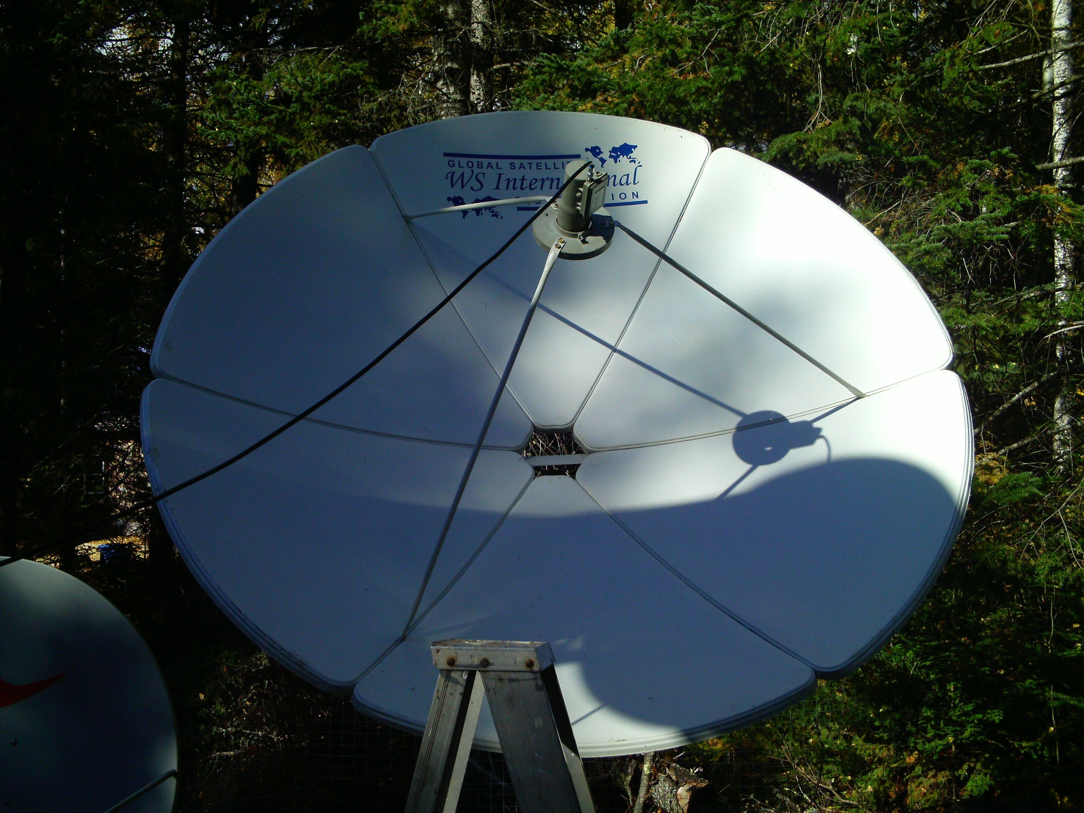

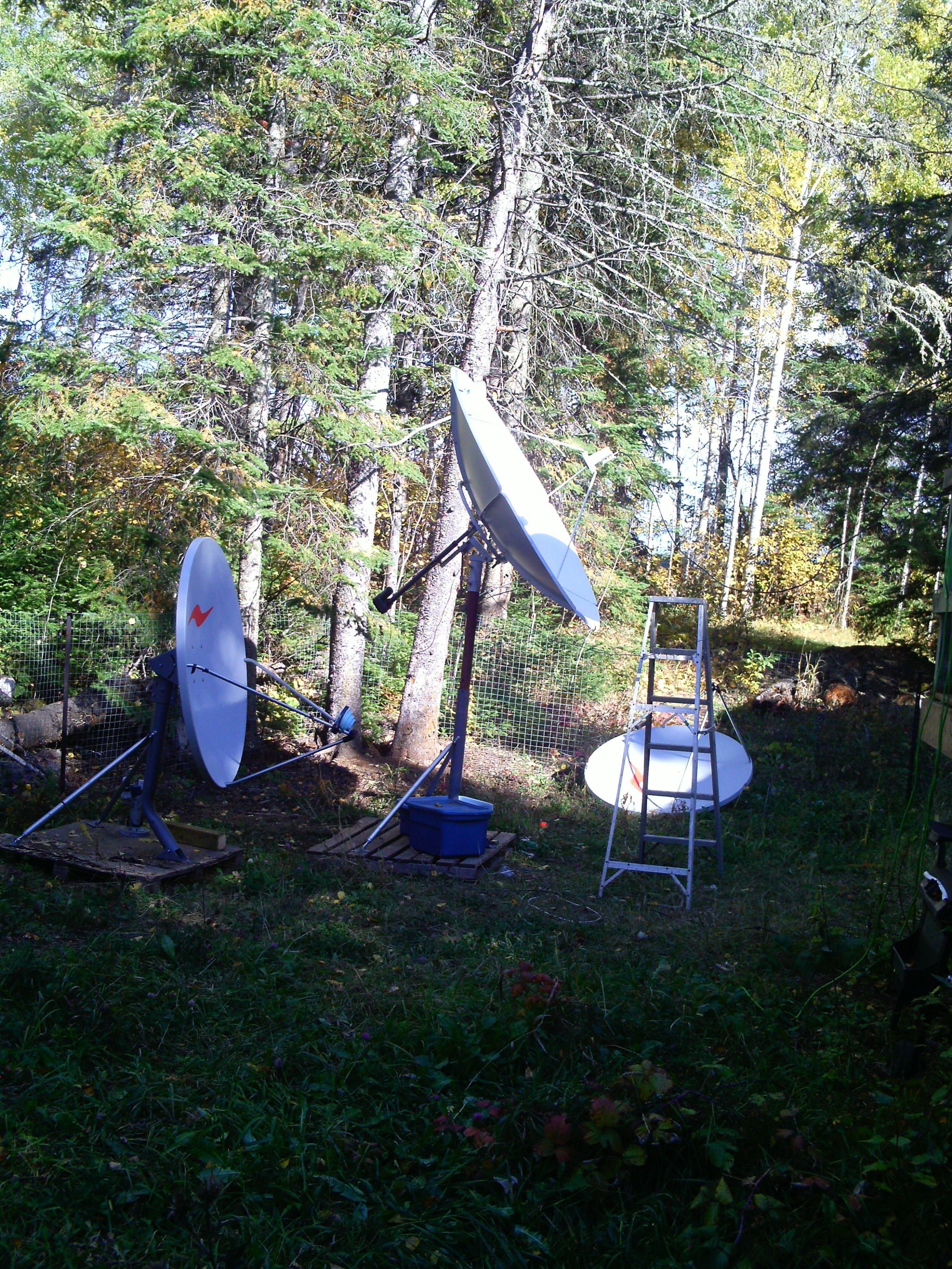

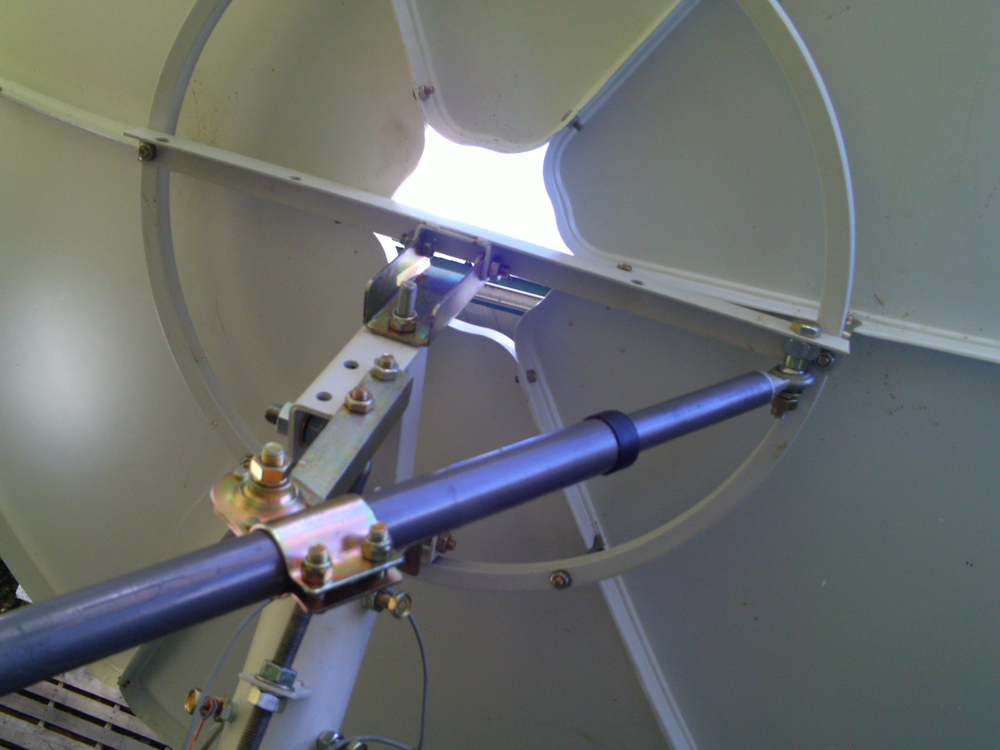

Ok, So its foto time! I just clicked a few. Ill get some better ones of the support arms & polar mount later today. For now, these should give you a better idea.
Its not a BUD, its a BBD..... Big Beautiful Dish :D

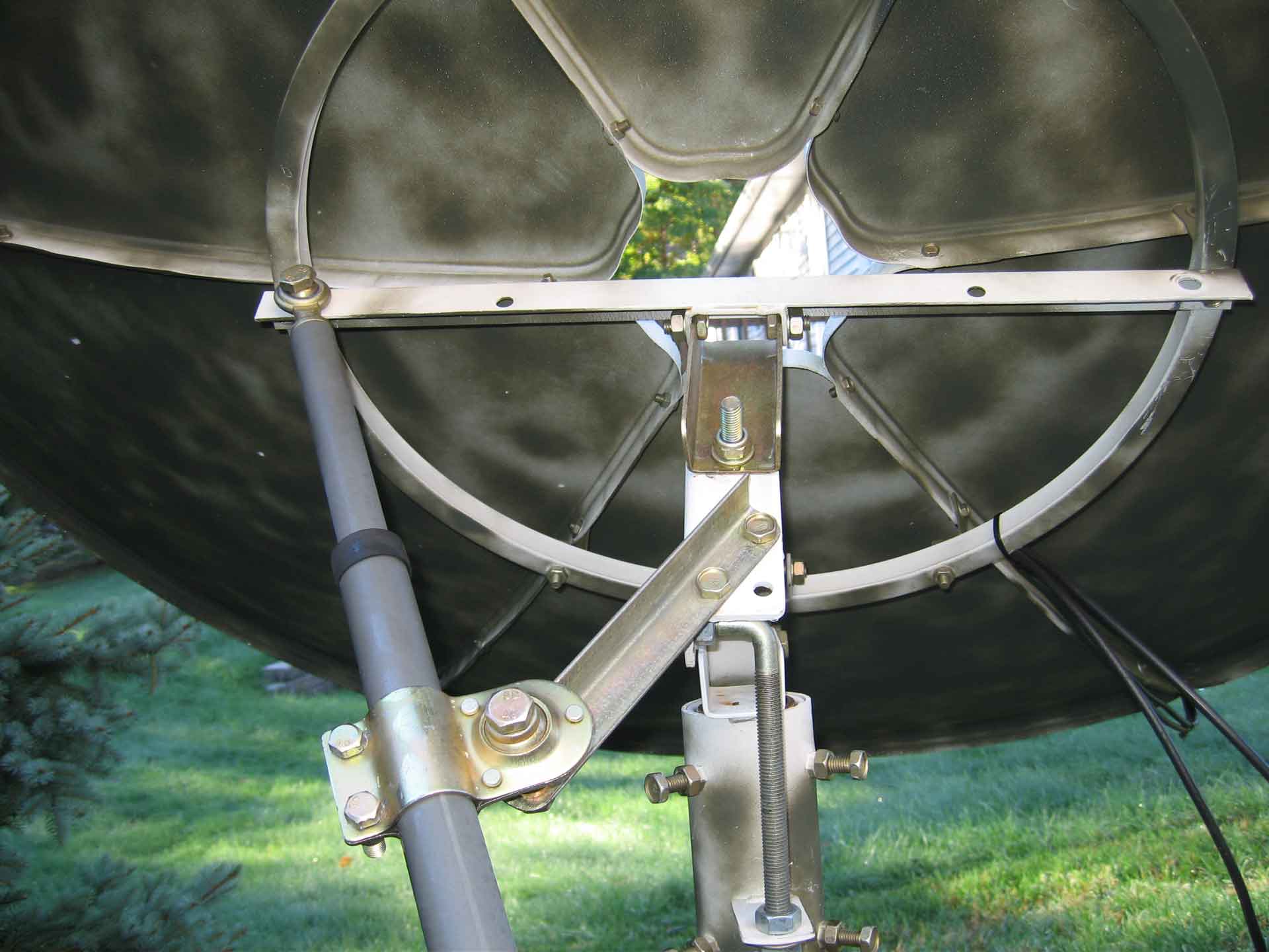

There is an assembly error on your dish.
Brent has it correct.
The short L bracket that is used to hold onto the middle of the motor is supposed to be mounted the way Brent has his.
edit: based on all the pix in 6 foot dish install - I didn't consult the manual
Don't think this has anything to do with your signal level, but worth fixing before going further. - :)

Hello, Yeah I know the bracket on the back is all screwed up. The screw holes dont allow me to put it on an angle like everybody else. I am going to go get some scrap angle from the shop and make my own anyways. That shouls make it easier on the actuator anyways, but for the time being, that should not effect the tracking of the dish im guessing.

I know that my bracket holes would not line up to attach the way you have yours, so I can't say that we even have the same hardware. :(

your trees
tuberadio, trying to figure out where you might be in my area based on the trees, :). But I'm just not that good haha.
