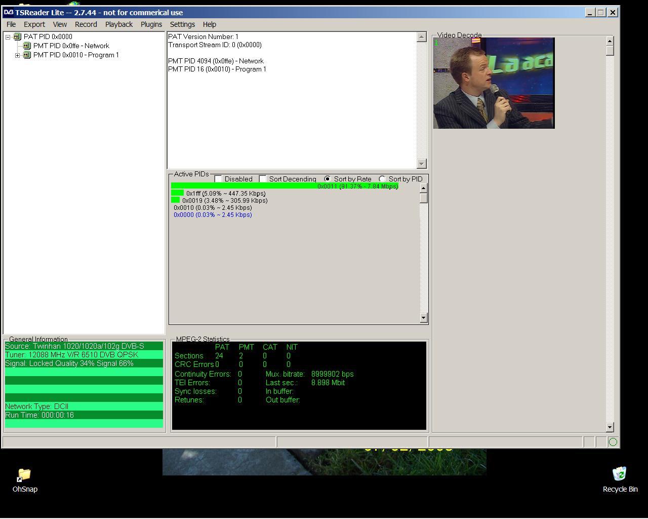

Hey guys,
Just wanted to let y'all know about TSReader.. I'm definitely surprised I am able to view Digicipher II ??? My PCI DVB card is Twinhan 102g.. I don't know how it happened..?! :eek: Still, it's awesome I can see it! :D Or is it possible bug from TSReader..? Anyone of ya's getting DCII from DVB PCI card??

It would be amazing if true, but that's not Digicipher II you're receiving. The Twinhan card can't receive it. It's probably not a bug in TSReader either. The Network Type is probably not set up right in the signals encoder. Digicipher II only uses a few symbol rates and 6510 is not one of them.
Yes and the reason it's not set up right might be because the network in question may use both DCII to distribute some of their signals and DVB to distribute others and on the receive end they probably use receivers which do both DCII and DVB. Anyway, it's not uncommon at all to see this but it doesn't mean this signal is DCII.
