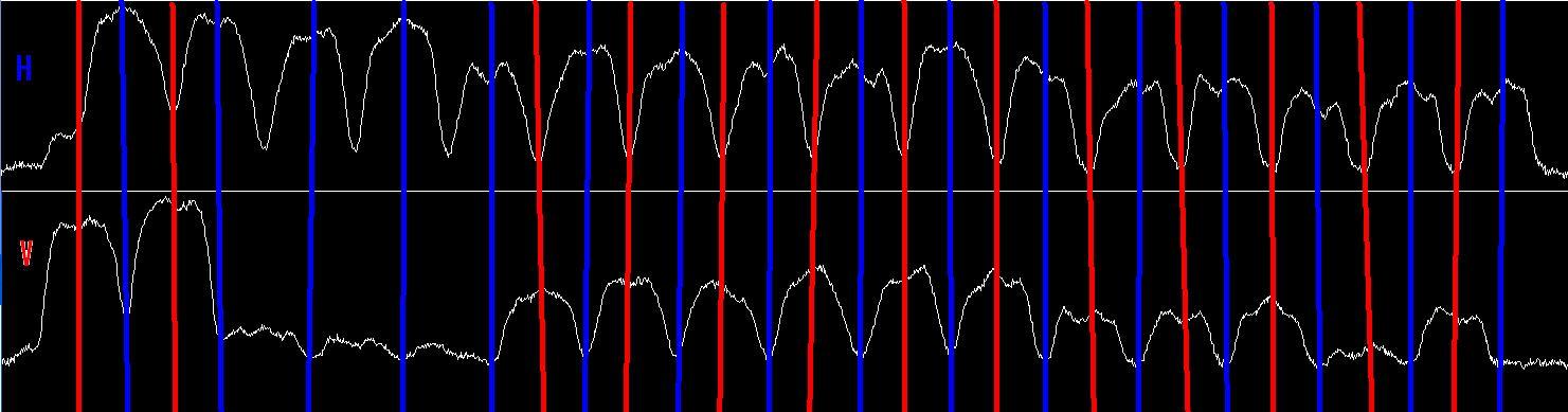

Here is my screenshot from my BLSA aligned to show the center frequencies shifted (Does not look nice since I used paint and I am watching the BCS Championship game at the same time :)) (Also because I have not calibrated the BLSA for circular signals since I don't use the circular LNB often)
I picked the 119 DBS satellite to show the shift(I labeled the polarities H and V when it should be L and R) :(

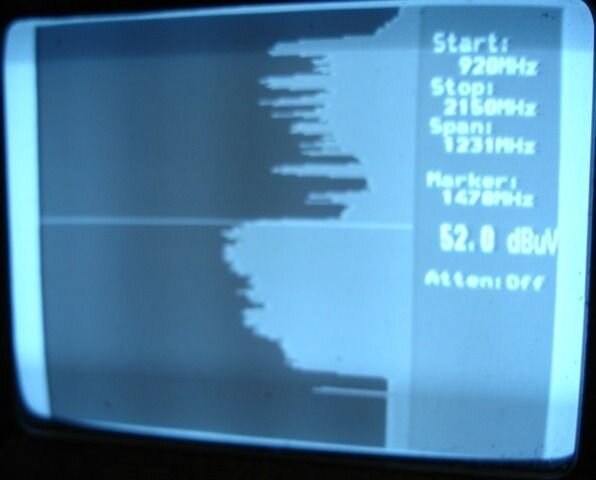

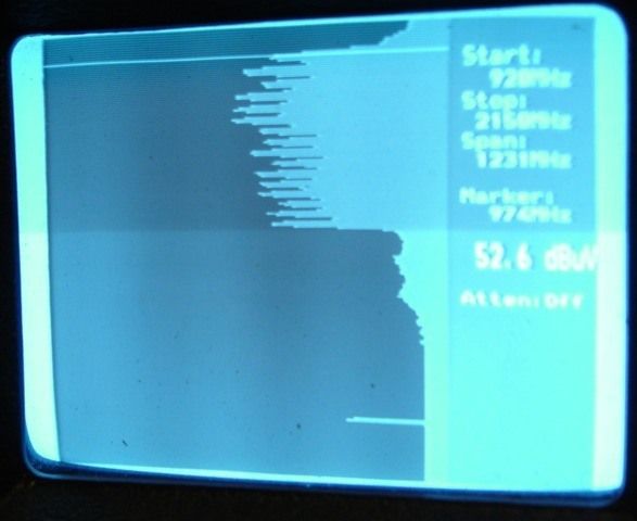

Ive uploaded two pics from my spectrum analyzer, first is 91.0w circular second is 91.0w linear.
my lnb has a lof/h of 10750 for linear and 11250 for circular. so lets do some math
12224 is expressvu's first tp
12224 - 11250 = 974 and you'll see that on the lband on my spectrum,its right on the first tp, with the rest to follow.
now 12224-10750 = 1478 and even on the linear side, you'll see that, 1478 and all the tp's follow that. you'll also notice that not only are they on the spectrum, but they are a complete mess, lol. anything in there would be totaly fubard and unlockable.
ignore the rouge blip tp down at the bottom of the screen, its not a hidden unkown tp, its a birdy on my satlook, its been there since they day I bought it.
