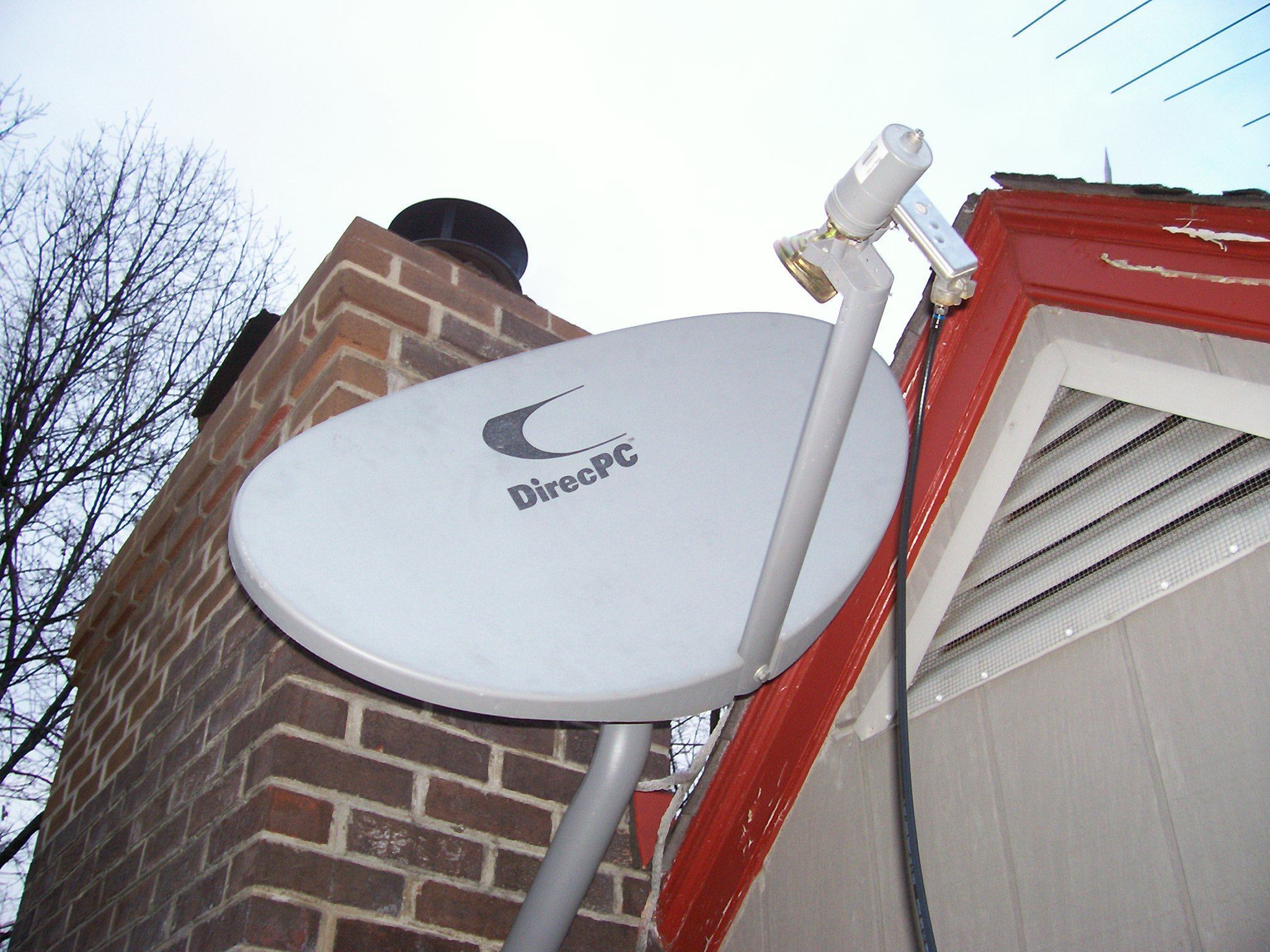

I could not wait to get my DirecPC dish UP so today was the day.
Installed DirecPC on chimney (See Pix) and started to try to point it.
I have SkyAngel with an old 3700 Receiver and hooked it up to that. My Fortec Star Merc II has not got here yet. The shiney LNB is currently hooked up is just for pointing purposes is a DISH LNBF (BS1H3UP210M) with the cover removed (so I could attach it)
I'm currently pointed to 129W but cannot find 121W which I was going to use to find 123W. Anyway good progress today.
Any and all help appreciated!!
Looks good, hope you got your vertical pole perfectly plumb and level on the top (do that before sticking on the dish). And don't worry about the paint, I have one that looks like it re-entered the atmostphere mounted on the space shuttle, and it still works fine on G10.
Alternately, I'd stick a chain-link fence cornerpost in the ground in concrete, lots easier to work on lol.
Although its Dish Network, 121w is not DBS, it is linear Ku. You will need to use the Hughes linear LNB to receive that satellite, L.O. in your receiver is 10750. There is only one channel in the clear on that bird, the "Congratulations you have a Superdish pointed at 121w" slate channel.
