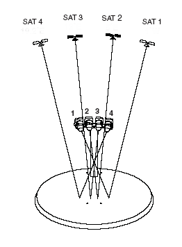

Hi everyone,
Is the LNBF for AMC5 (79w) to the East or West of the LNBFs for T5 and AMC4?
Thanks.
Cuong
AMC5 is east of the other two, but if you're mounting LNBFs on a multisat fixed dish, the LNBF for 79w will mount to the west of the others (or right of the others looking from behind the dish) due to bounce.
The below diagram shows that you always put the LNBF on the opposite side of where the satellite is...........
