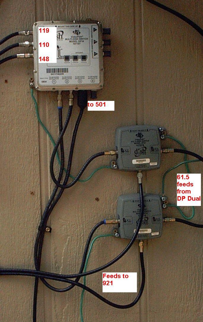

Iceberg's right - it works just fine. Here's mine:
