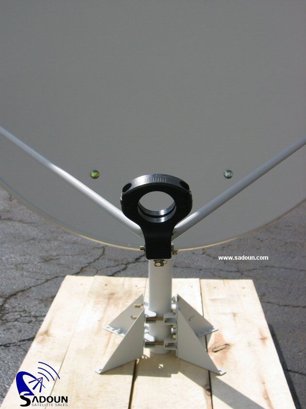

Yep Scott. Your Fortec 120cm dish should hold it fine :D
you might also consider a dish upgrade, guys what gain would someone see going from a 80cm fortec to the 100 or even the 120 ?? would it be worth it ??
i'm using the primestar round but its big enough to hold that big lnb out there, just like the bigger fortec's (have arms to hold a heavy lnb)

Fortec Antenna gain..........
80cm = 38.24 dB
100cm = 41.02 dB
120cm = 43.32 dB
