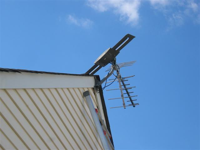

Call Robert @ ValueElectronics.com and see what he has in stock. Mention you are a member. Radio Shack used to have a great YAGI directional in the $25 range that boasted 75 - 90 miles and it had great gain. So give them a call.
they still do.. this is my second antenna
http://www.radioshack.com/product.asp?catalog%5Fname=CTLG&product%5Fid=15-2160
works well

they still do.. SNIP .. jim
Thanks Jim I have a buddy that was looking for that link. What range and do you get with that? Do you have a spec sheet listing the gain figures?

no specs are listed .. but I was able to get 25 miles in the attic with no problems (lower signal strength) but now that it is outside.. its even better
