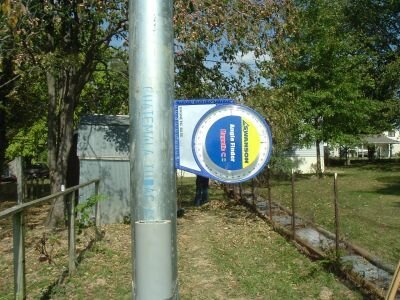

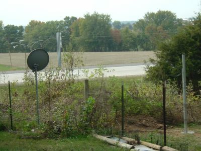

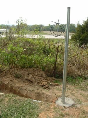

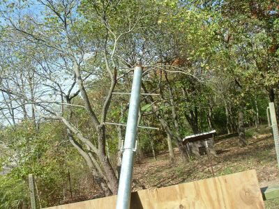

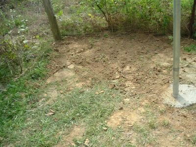

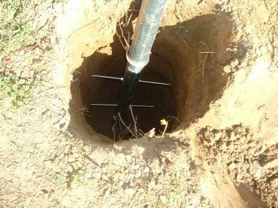

I am going to try and attach pics. Hope It works.

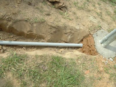

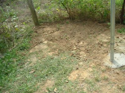

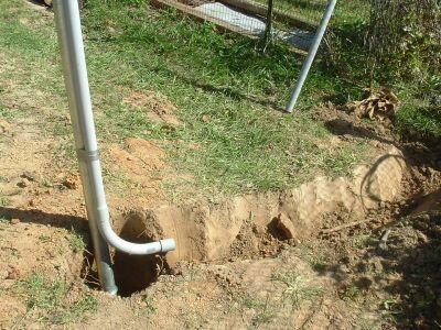

The hole turned out to be 43" deep and 14" wide.(I got carried away) took 6 bags of 80lb premix to fill it. I filled it to the top because I dont like to use a weedeater. Call me lazy.
I copied Cbandlover's conduit in the front to run the cable in. I think it looks better.
Thanks to all of you for your advise and suggestions.
Allen
