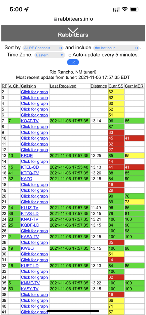

OK,
I have my external antenna on-line now so you should see some improvement...8 is lit, my antenna has LOS to Sandia so 10 is on the hairy edge of locking. 15 is also very close to lock but not 18. 20 and 21 scan like gangbusters but are not displaying so we'll see if Trip can get the code guy to fix...same with 26 and KOB.
Huh? Where that RF CH. 33 coming from since your tuner showing 100 %, false reading?
Not listed in the FCC's database.
I know there is one CP listed left I think it's for RF ch. 34 and have yet to go on the air.
Interesting readings on RF channels signals!:hatsoff
Probably just noise; there's no SQ %-

See RF39, 40 and 41 at 100%?
That's clear LTE/5G signals. He needs to put one of the new Channel Master LTE/5G filters between the antenna and the tuner. Per my spectrum analyzer, that one kills LTE/5G completely DEAD, NADA, gone!
