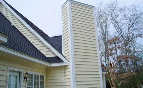

After 13 years of having my DirectTV dish attached to my roof, my condo association wants me to move my dish off the roof. They want it to be attached to wood facia or use a chimney strap. I had an installer come out to do the move. He took a look at my situation and could not find any wood facia that would allow me to point my dish to the satellite. He looked at the chimney that is completely vinyl sided said that the chimney strap is totally out of the question because of the vinyl siding. My condo association believes that the installer just didn't want to do the work. I on the other hand would rather rely on the professional. So the question is:
Can a chimney strap be used if the chimney is completed vinyl sided? There is no exposed wood currently on the chimney.

What is the chimny made of ?
They put siding on it, so it's probably made of wood, no reason they can't attach it to the chimney just like they would on a faschia.
They don't like to put them on siding because siding is suppose to be able to breath, expand and contract, but it's your chimney not the side of the house ....
Ask them how they feel about a pole mount in the yard.
You cannot attach a directv dish to a fascia board, its not structurally strong enough. Your installer is also correct about the vinyl siding. Almost certainly there is an air gap under the siding and an inch or more of foam insulation. If you apply a strap to it, it'll crush and wont adequately hold. Plus as Jimbo mentioned, depending on your weather, the vinyl will expand and contract considerably more than wood.
There may be studs or plywood sheathing under the vinyl and foam, but finding it and getting a good seating for the lag screws you'll need to mount the dish is really, really iffy. Not to mention its possible to puncture the chimney liner or otherwise make the chimney no longer fire safe.

A chimney strap is made for a brick chimney, not a vinyl covered chimney like the one in this picture.
