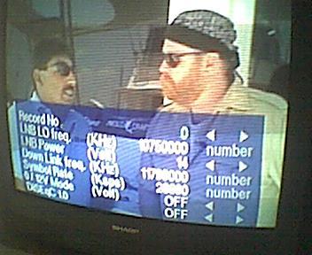

In the system setup screen, this is what you would see:
Record number is the channel # (0,1,2,etc)
LNB LO Frequency
LNB Power is polarity
Down Link Frequency is the frequency
Symbol Rate
0/12 mode
DISEqC (allows you to hook up 4 different dishes)
So in our example above you would program it as such
0 (1, 2, etc)
10750000 (make sure to add 3 zeros...C-Band would be 5150000, DBS 11250000)
14 (Vertical Polarity..18 is Horizontal)
12000000 (again, add 3 zeros)
9000
Off (if you have 2 dishes and a switch, change this to LNB1, LNB2, etc)

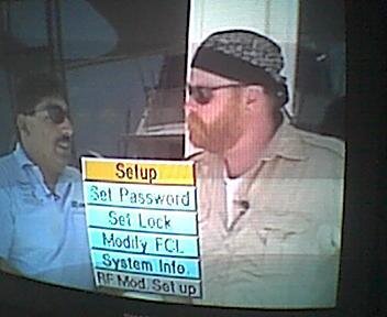

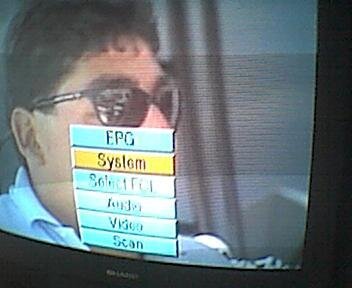

Added some pictures of the setup screen (for anyone with issues)
Don't be alarmed by the scary guy in the picture...looks like one of my relatives :D
