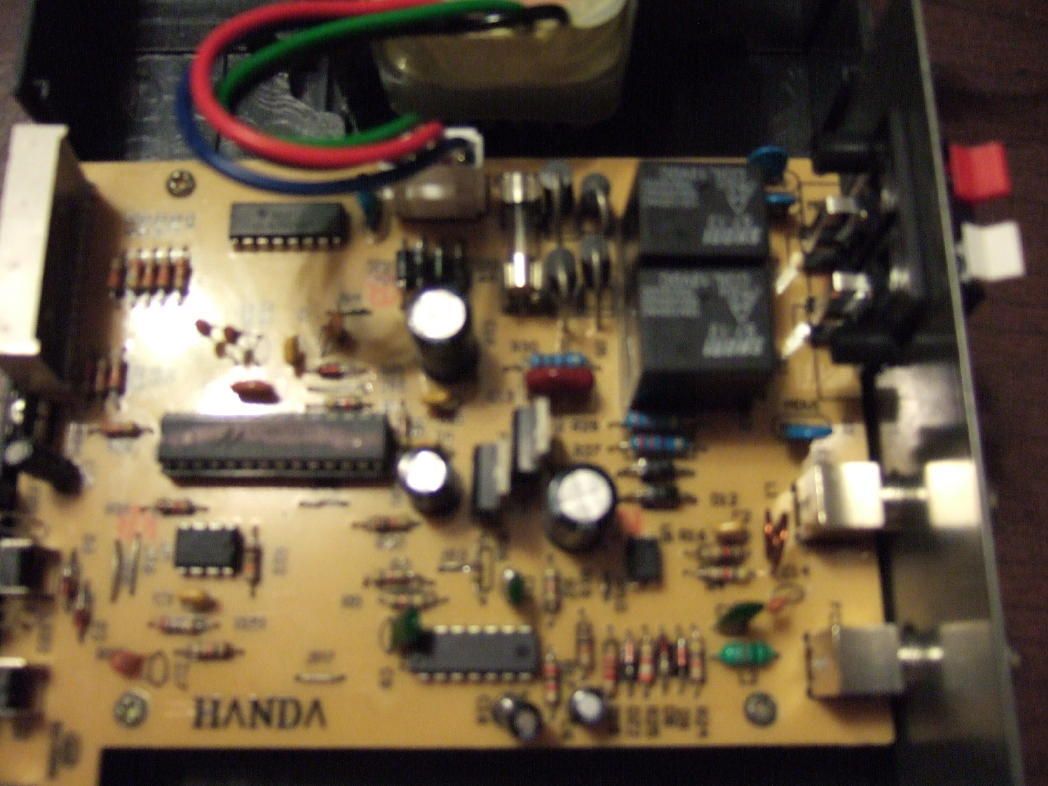

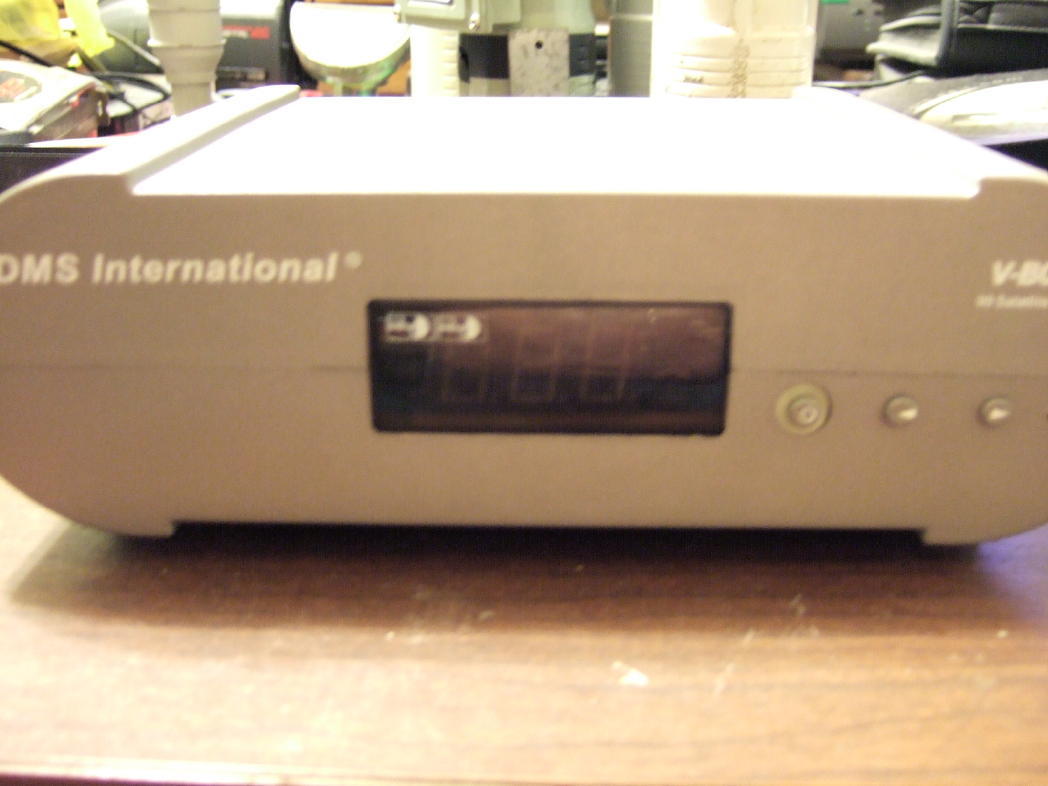

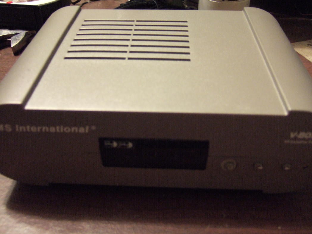

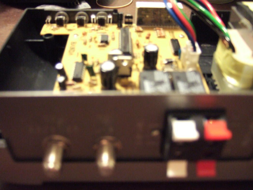

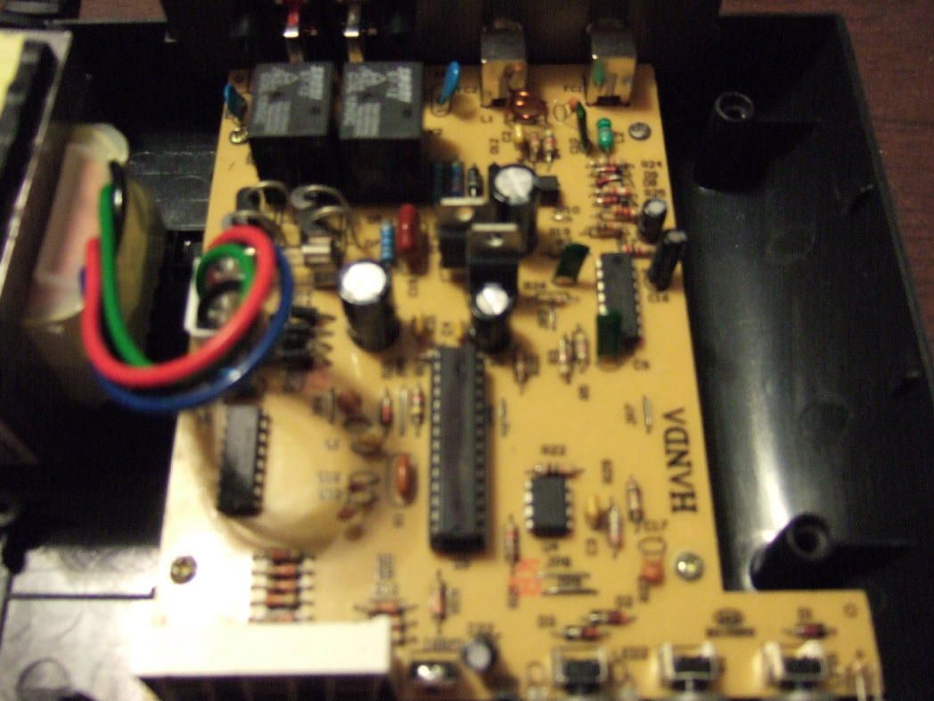

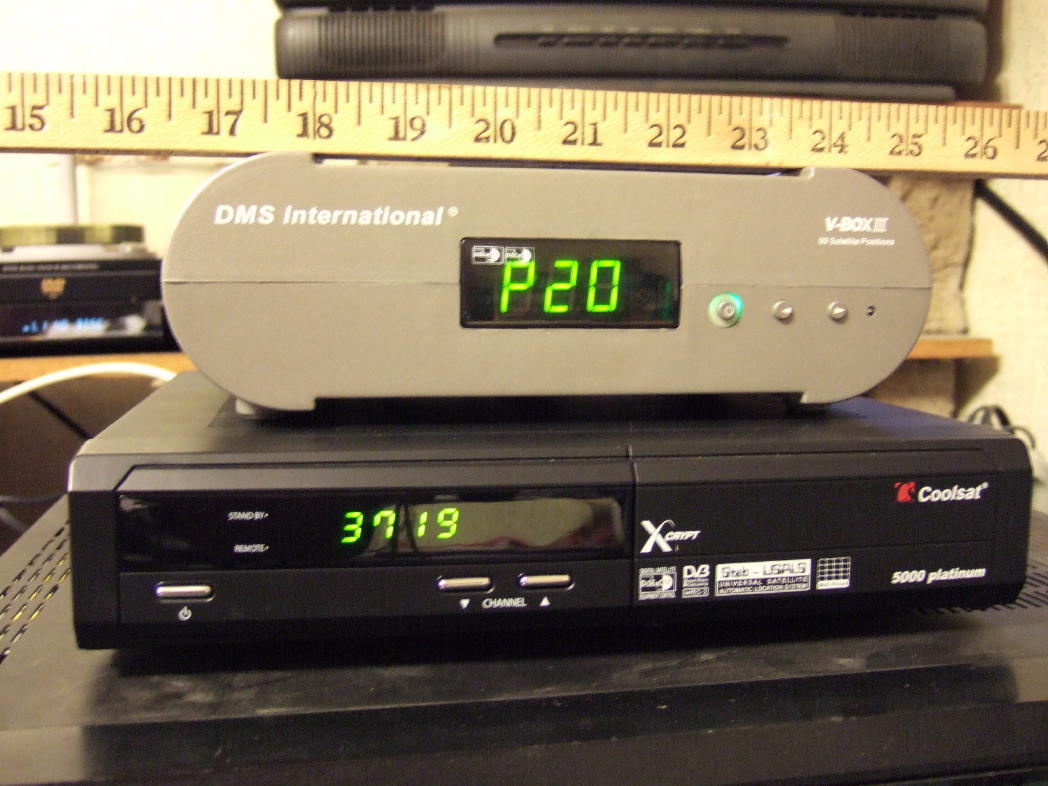

here are a couple of pictures enjoy oh yeah the unit is 6 inches Wide X 9 inches across the front X 3 inches Tall
