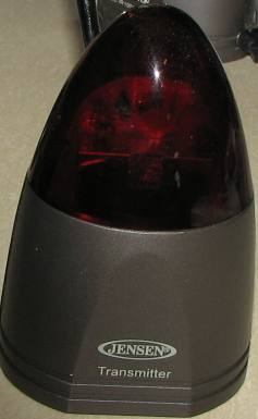

Jensen (yes, I see the letters IR) JDSC-IR100A
It sounds to me like that device (and most likely the one that receives the signal) has died. You could contact audiovox who now owns the Jensen name or you could just go out and buy a new set.
Thanks. Course I was hoping that wasn't the case. They're $50 a set at BB but I see I can get them on line for half that. OK, let's assume it's the receiver and not the DVR. There's still the question concerning DirecTV's stance that this particular box (R-15) doesn't support IR (or RF <lol>) Whatever it supposedly doesn't support, it's been doing so for over 3 weeks. if it's not the normal "clueless tech support syndrome", I've wasted $30+. They don't have an answer for why it DID work.
