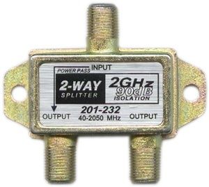

There are power pass splitters if you need them. see photo Powerpass_splitter.jpg

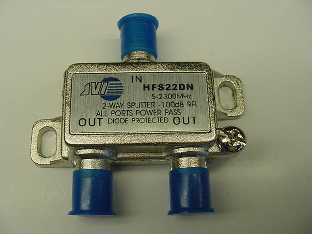

A splitter is a splitter, no such thing as an anolg or digital splitter. Som of the older splitters are only swept tested for 5-900 mhz, not good for digital signals. Go get a standard splitter with the amount of outputs you need that is rated 5-2300 mhz it should say on the front of the splitter and you should be fine.
could this splitter be used as a combiner also, lets say the antenna and an satellite tv 2?
Is that the amp or pre-amp that first cable is running into? I know I'm new here thats why i'm trying to learn new things.
Looks like the output of the power supply unit of a Channel Master preamp, like a 7777...
The only "dumb" question is the one the one you don't ask, dumb as in mute...
It can combine two RF signals, say from two antennas, although combining antenna signals is problematic becaus the signals from each antenna is out of phase with the other one - not good...but what you need to combine antenna with satellite is a diplexer. And you can't use those with DirecTV if you have a 5-lnb dish, the new satellites that launch in 2007 will transmit frequencies that overlap the signals coming from the antenna.
