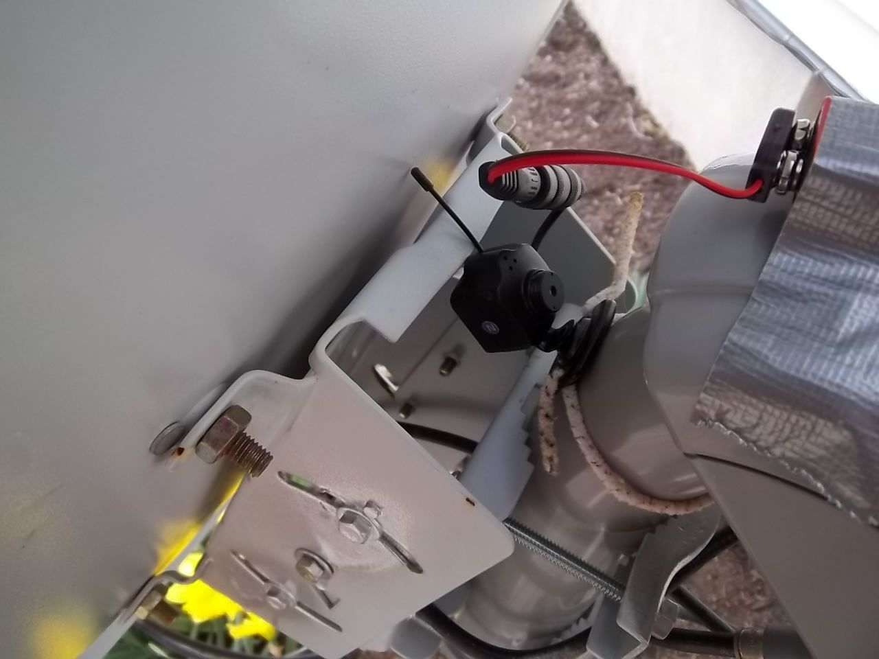

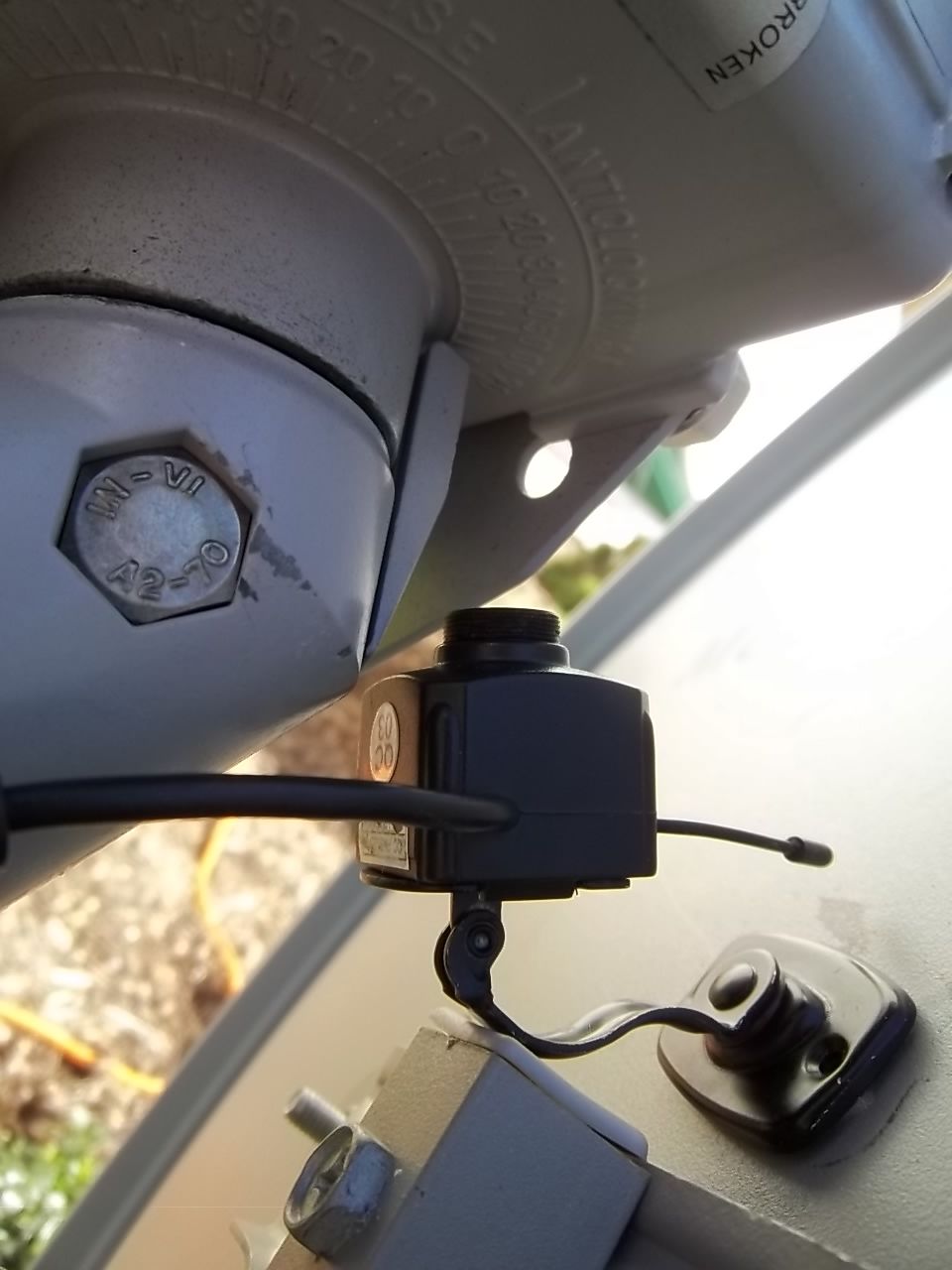

Mounted the camera on a motorized dish so I can see the degree settings on the H-H motor as the dish moves around.
Back in the house I set up the video cam receiver so I can see the degree setting on the motor. This comes in handy when setting DiSeQC for different sats,and also when troubleshooting motors gone awry.
It's a little tricky setting up the camera to get it located just right, do that by taking a small TV rcvr out with me. When you get back in the house you have a nice live video of what exact position the motor is for different satellites. It will also give you an idea of how your motor moves when making slight degree adjustments. Found that motors are not all the same - some move a fraction of a degree, others move a few degrees.
The camera can be held in place with a small magnet, or it can be mounted on the tube with pipe cleaners.
