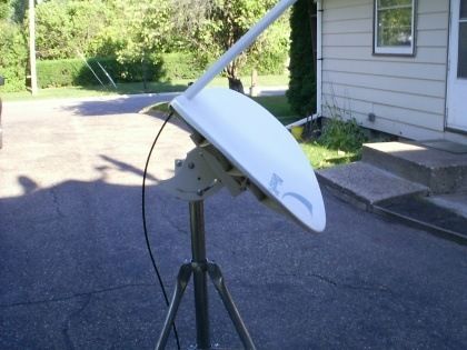

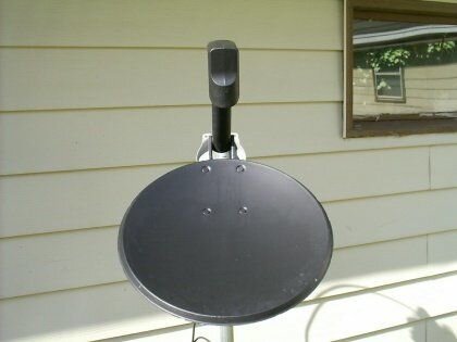

Anyone tried this with a dish before? I was messing about this afternoon and setup this dish, upside down, the signal is great its just the same as if the dish were the right way up! I don't know how it will work in the winter if/when snow collects on it, but this method can also be used as an under the eaves (of the roof) mount, where the customer does not want any holes in the roof, I have done it one or twice before, and they must still be working as I am sure the customers would have told me : ) I have seen a lot of dish inverted this way on ships and in the middle east, I think the army also use this method to keep the dish as low to the ground as possible.
The elevation for this dish is set at 37 deg. for the DirecTV 101w bird. The signal is screaming in at a 93 on the DirecTV receiver, and when its really hot outside you can fry an egg on it....but that would be crazy.......wouldn't it?

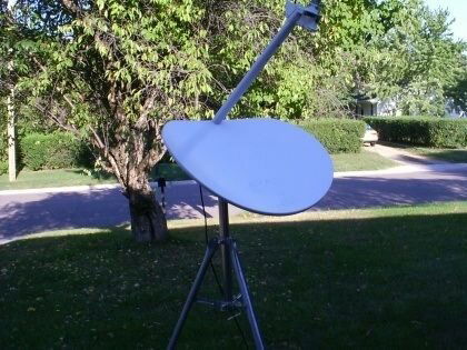

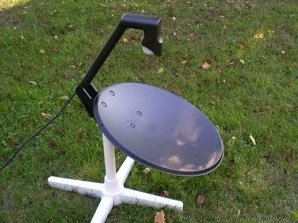

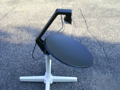

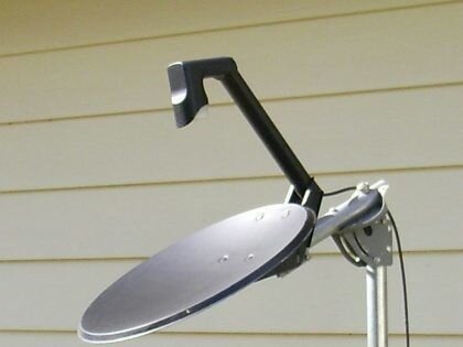

Yet another upside down dish this one I am using on a tripod base, pointing at the KU band satellites at the extreme ends of my viewable arc that my motorized dish cant reach.

I think they are really made for Horizontal polarization only, but work pretty good for FTA, they also came with the Dual LNB Ku/DBS. These white dish are DirecPC dish.
Over at the dbsforums site, some members have posted pictures of their setups and (dont know if it is still there) some guys had inverted an 18" dish in order to bring in a very low horizon satellite. Most of the 18" dishes are about a 24 degree offset so if the satellite is really low on the horizon the mount does not allow you to lower the dish enough to get a signal so these guys inverted it. They were in Canada somewhere.
the idea of mounting the dish up side down was used years ago. Nothing new at all. It helps when one aims the dish at low elevation angle. It actually disadvatange when the elevation angle is not low. Why?
Let say the elevation angle of a sat is 40 deg. With a dish with 20 offset deg, the face angle is 20. If you mount the dish up-side-down, the face angle becomes : elevation of the sat + offset deg = 60degs. The dish at 60 degs elevation for sure will turn out to be a swiming pool when it rains hard. I don't see why one would need to mount the dish up side down unless he/she aims the dish a very low elevation sat.
