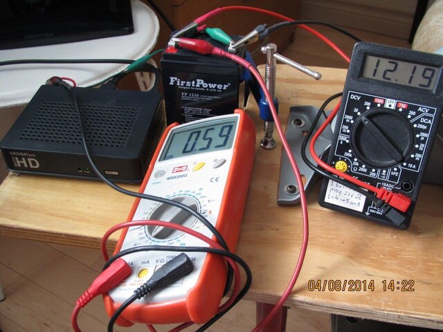

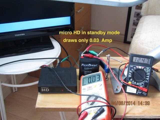

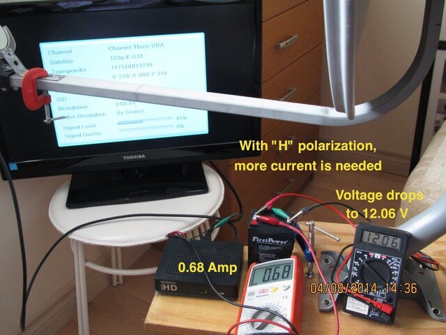

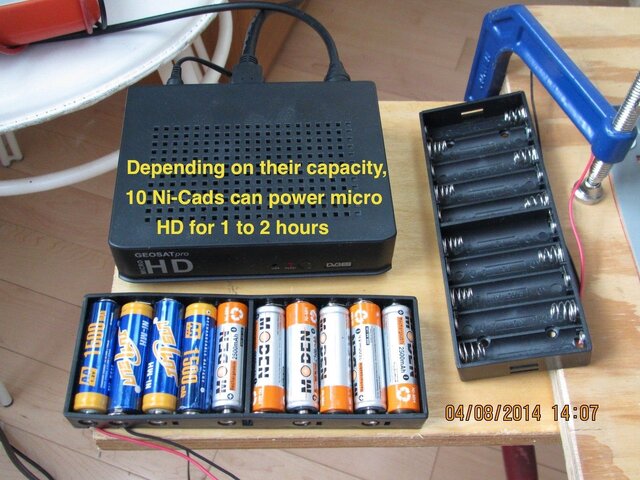

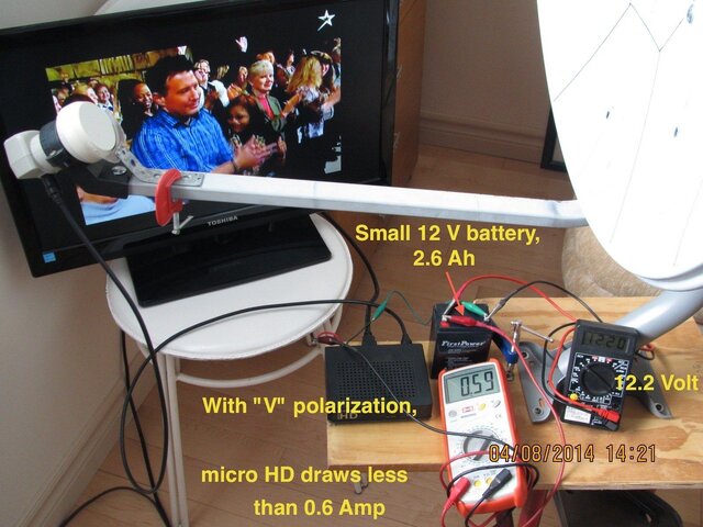

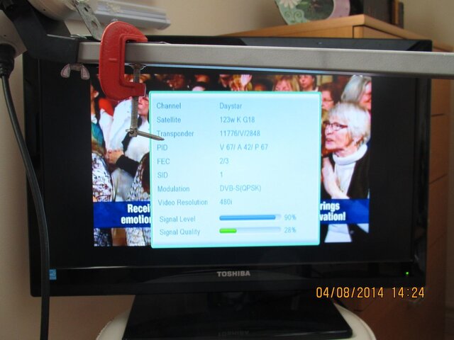

Current needed for micro HD:
Even small 12 V battery can do the job for 1/2 to 1 hour, as the micro HD needs less than 0.7 Amp to work. A few pictures follow.

Cool pics. Not only is it running off battery's but the dish looks to be inside aswell :)
