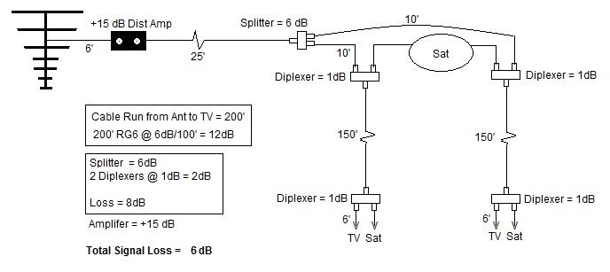

So if I replace the coupler with the distribution amp, I should get something like this:
I can't shorten the 150 foot runs because my satellite dish is a good distance from my house in order to see over the hills. I can probably shorten the 25 foot run by a few feet and get another .5 dB.
You could also upgrade the cable to a lower loss one like RG-11/U or even a higher end one.
You only need enough amp compensation db's to compensate for the approximate loss you calculate you have. In other words, if you think you have say 12 db loss due to connectors/splitters/diplexers, don't put in an amp that provides much more than that.

I think I finally got it. I hooked up the distribution amp as above, and fine tuned the orientation a bit. Now my signal is running a constant 85 on the Dish tuner, and 90-93 on the Coolsat meter. We've got some bad weather rolling in the next few days. If the signal holds I'll be really happy.
Replace the splitter with the distribution amp rather than putting it in line like in your diagram, that will save you 3db or so of loss.
