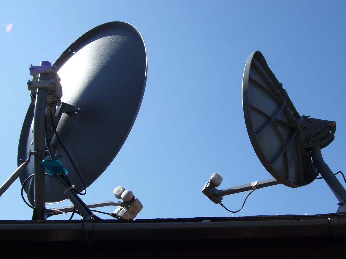

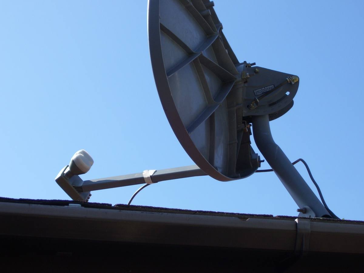

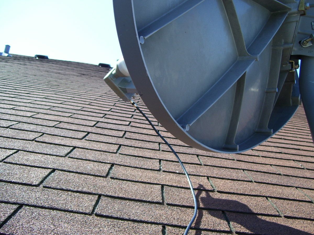

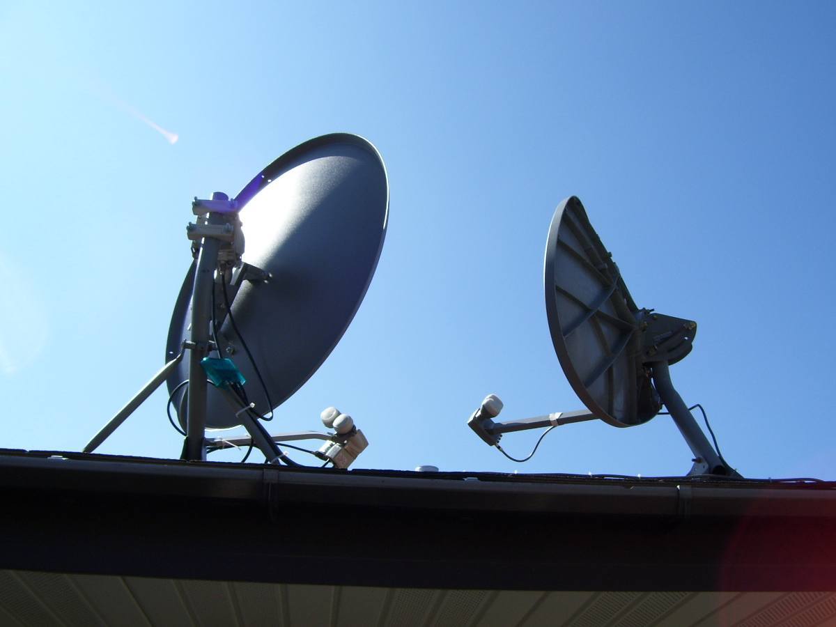

TV5 Monde is only available in Europe. There are a couple beams on Hispasat
-Europe beam
-North American Beam
and TV5 (which shows at 12092 V on Lyngsat) is for the Europe beam
Can Hispasat be picked up here? yes it can. Its very low elevation (9ish) but can be done. Here are a couple pics of my setup at the time for 30W

that is a Starchoice (Channlemaster) 75e dish...37x27". Its a Canadian subscription provider
The LNB is a quad LNB that sees 107.3 & 111.1 (the 2 Starchoice sats) with a integrated 22k switch. I had issues with 107.3 LNB going bad so I switched to a different dish setup (Primestar dish).
I used the 111.1 side since it is boresight (107.3 is offset) and aimed the dish at 30W. Worked pretty well for most TP's. The weaker ones either very low (15-20 quality) or non existent.
