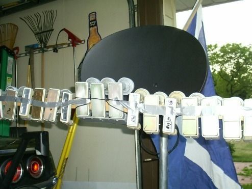

I was thinking of getting an 18in dish for dish audio and a very few channels. What is the best dish to get. Tripple lnb's look good (direct tv phase III) but can i use them with my fortecstar? I think they have a bult in switch. If the switch will not work can i bypass it and use my own?
A Phase III DirecTV dish defaults to just the 101w LNB when not used with a DirecTV receiver, so there is no real benefit to it over a regular 18" dish with FTA satellite, and the internal switch will not work with with FTA : (
However, a Phase II dish, is perfect, since it has no switching.. 1-2-or-3 lnbs, and with creative ducttaping, you can add a 4th, and perhaps 5th too!
Thats what I have in the background of my avatar, a 4-LNB Phase 2 dish for music from E* and BEV
Don't even waste your time with the Phase IIIIIIIIIIIIIIIII Dish!

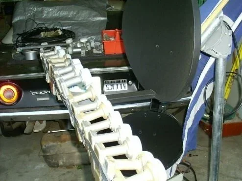

The Cuda is green, I will post some pics next time I pull it out for a wash : )
It works, had it running recently. Still needs some work to get it road worthy. (gas tank...)
