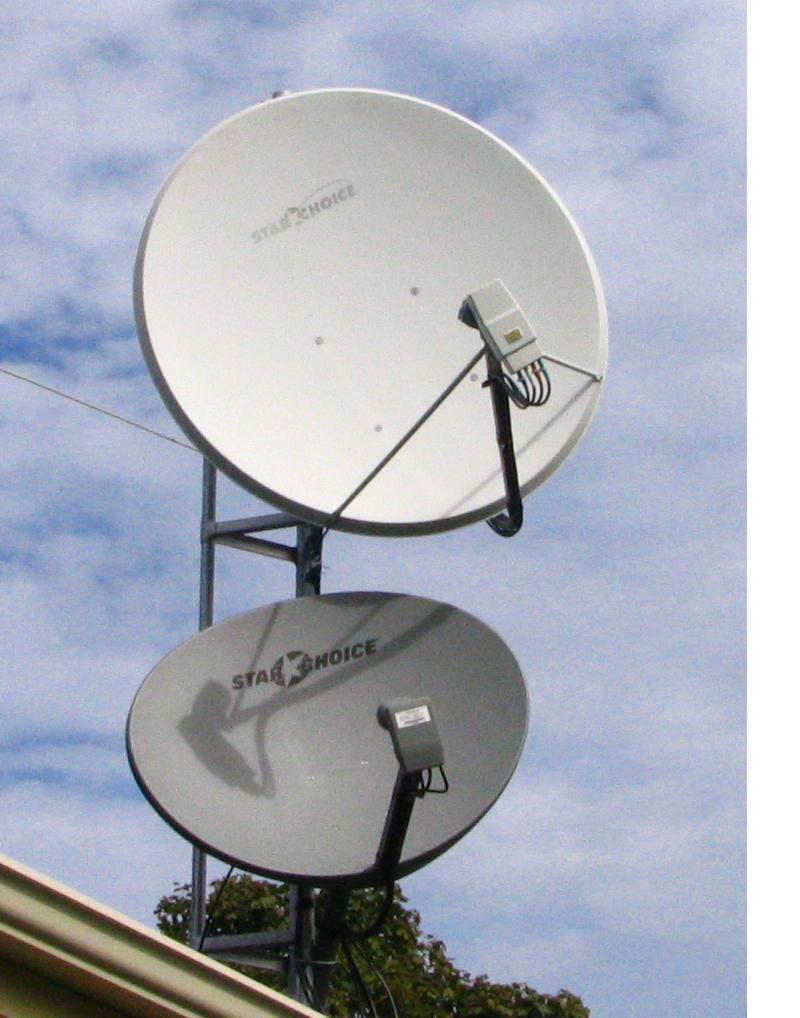

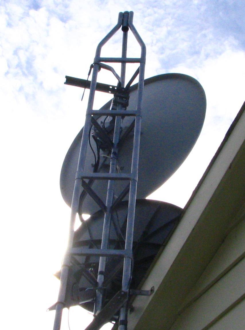

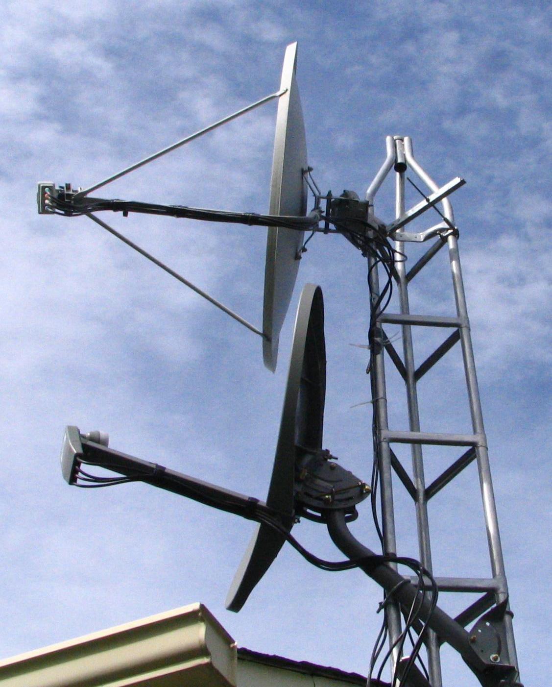

Here is some pictures of my satellite tower. The top dish is a StarChoice (made by Winegard) 1m dish on a motor. It has a universal mount so it took some fabrication to get it to attach securely to the motor. This dish has an invacom quad LNBF. The motor has an arm attached to the mounting bracket to help adjust the rotation on the tower precisely by a threaded rod. It also prevents it from turning on the tower during storms. The lower dish is my StarChoice 76cm elliptical. The tower has been secured to the house as there is quite a load on the tower during storm. There is some slight movement of the top dish during winds, but not enough to loose the signal.

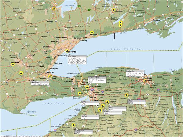

It was strickly a UHF only antenna about 4 ft. long. The tower does not have the height needed for my area, as it is only 2 sections. (approx 20 ft) I would need at least a 40ft tower to be above the trees to the south of me. (neighbours tree approx. 80ft to the south of me) Most of my stations come in from the south, and to my west. Unfortunately, I do not receive any digital stations from the west, but can receive the analog. I have a large hill about 1/3 mile to the west of me to go over. I am not wanting to put up another tower, as my StarChoice is working fine for the channels in my area. I would need a new tower of at lease 40ft (minimum) to get reliable reception of the stations to my south (over the lake). And then they would not there 100% of the time. I still would have trouble gettting my digital stations to my west, as they are just too weak. (see link http://www.remotecentral.com/hdtv/index.html )
Here is a link with the power of the various stations available to me.
Here is a map of my location attached.
With my homemade antenna, I did receive digital channels from Buffalo NY, Rochester NY, and one night from Syracuse NY.

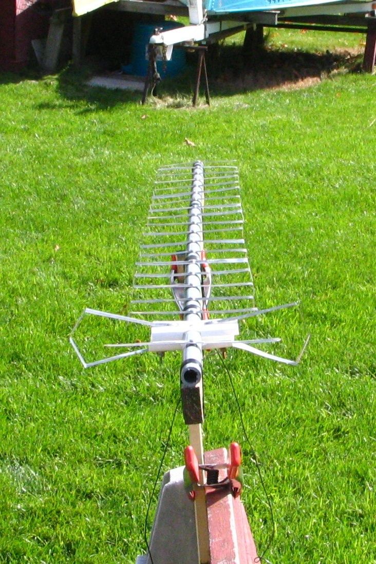

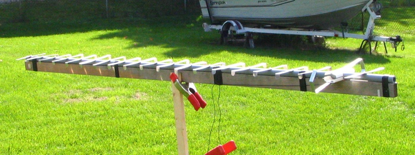

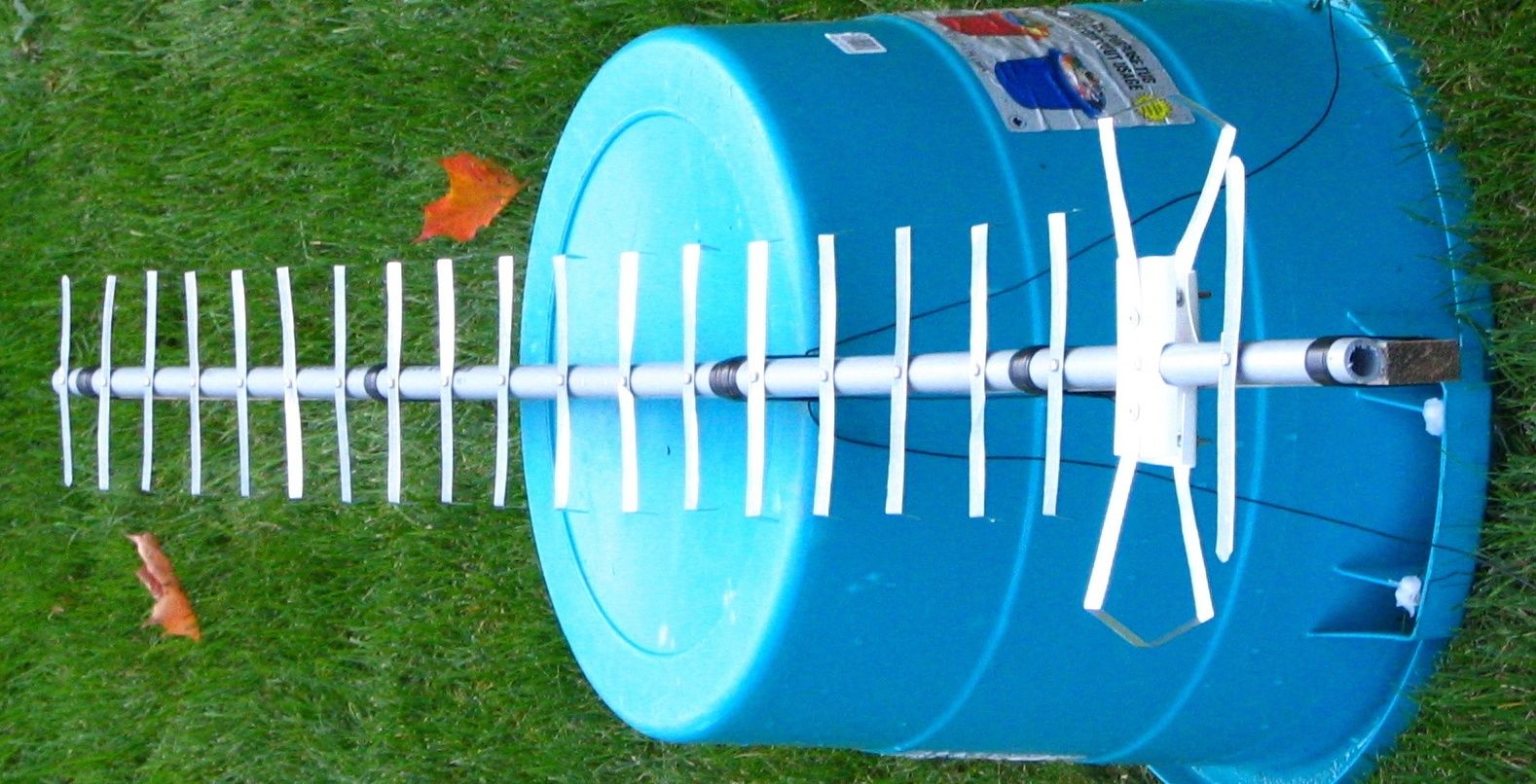

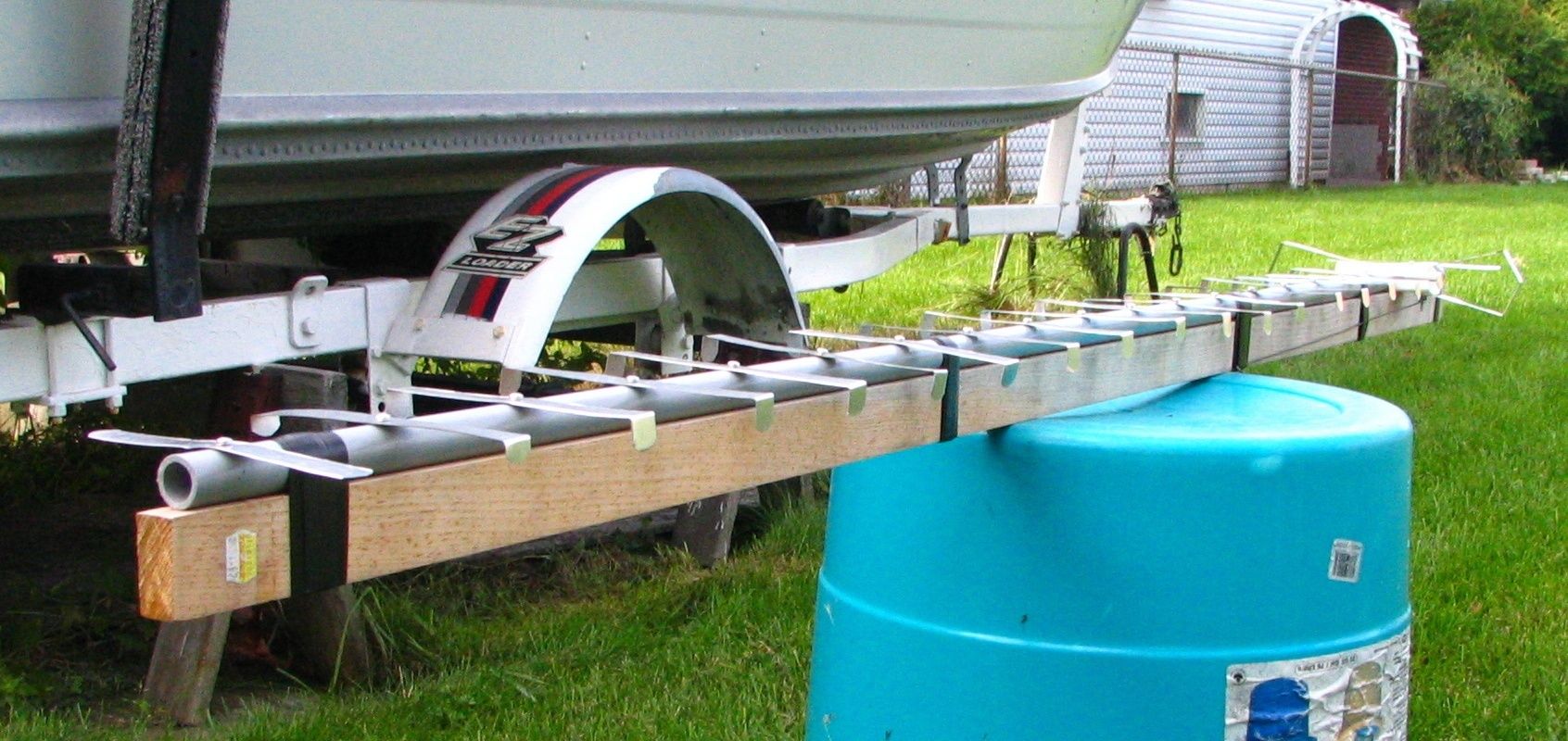

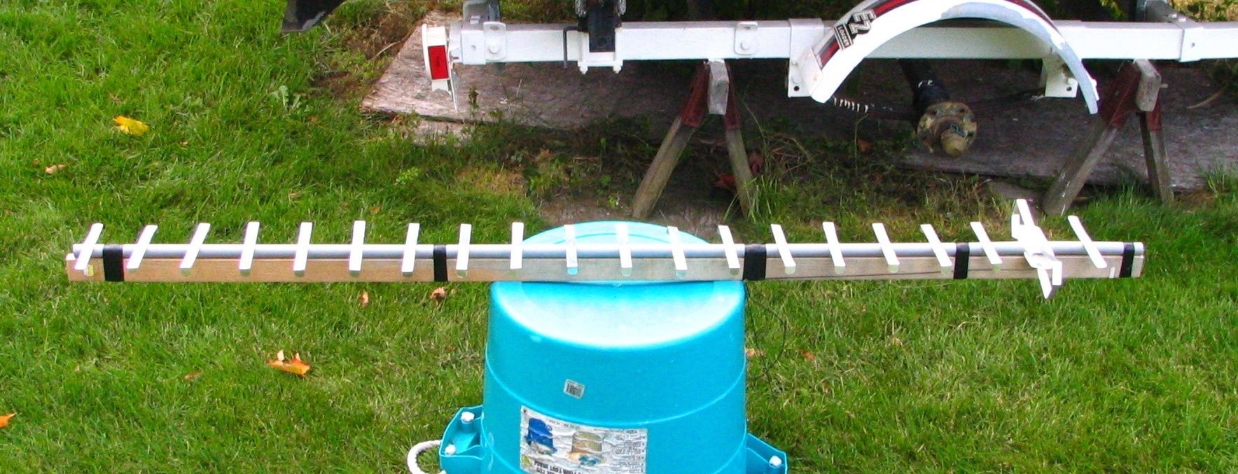

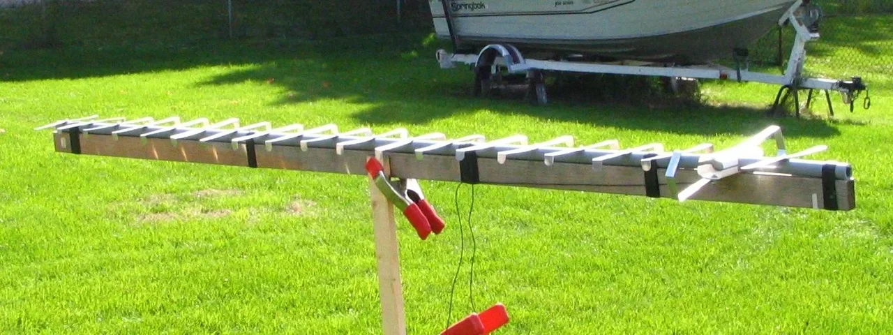

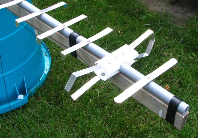

Added a few pictures of my experimental digital OTA antenna. I first constructed it on a piece of conduit, but found it did not have enough rigidity once the sun got to it so I added the piece of 1x2.
Worked good for my area, but without the height my reception was poor.
