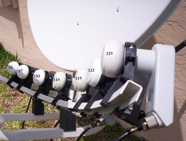

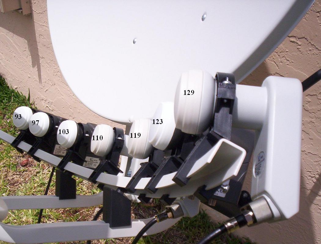

Ok, here's some pictures of where I'm finally at.. :)
Now I need to run a simple pipe into the attic to contain and hide all the cables that need to go into the house from the satellite.. It's easier than drilling a hole for each one and calking it up..
The top of the dish is probably 5 feet from the floor in that picture.. the thing is huge.. pain in the rear to adjust.. but gets some serious signal.. :)
I get around 80's on my dish 500 this thing gets mid to high 90's.. 129 which I'm not supposed to easily get from South Florida.. can get upper 90's with the right adjustments..
