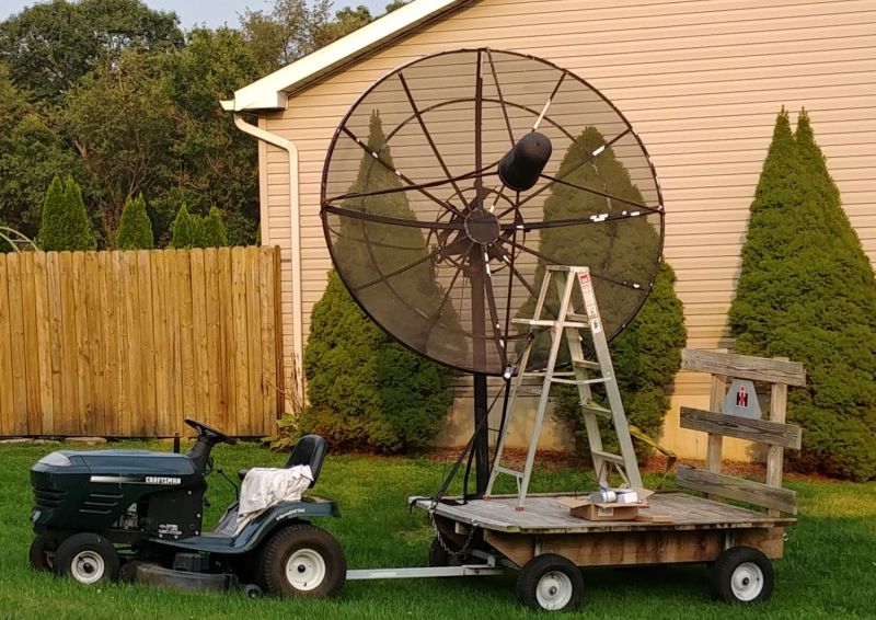

The C-band will have to wait until I can rig a ladder as my regular rig is ocupado. The first photo is my reg rig (trust me, it is strapped down tight). The second pic is Uncle Herkimer on duty for the season (which changes to a turkey Nov 1st and Santa Dec 1st). Here's some spooky, in keeping with the season, news on the C-band box; after 3 days it came on all by itself and a day later the clock started working so I started testing it every day and after a couple more days I was able to get into the menus. With the LNB dead that's as far as I could go but there's a glimmer of hope that box might be OK. Was that Rod Serling I just saw? o_O

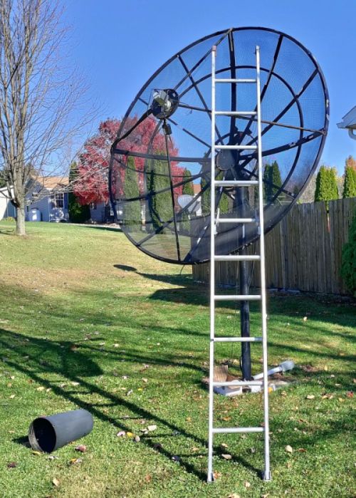

Got some nice weather so I rigged up a ladder I just picked up at a yard sale. It turns out both the box and the LNB were toast. I still had my spare C1W-PLL LNB from back when I installed the CK1-S so I stuck that in and tested it with the Amiko and walah, it's alive! Almost 4 weeks to the day and everything is finally back to working. I think I owe myself a Weihenstephaner (Bavarian lager). ;)
