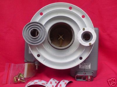

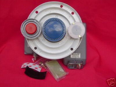

Now this is a creative way of making it happen with three LNB's and a big ole scalar ring...

I saw that yesterday and was thinking that it'd be easily re-creatable.
It looks almost like hot-glue :eek: was used to secure the DSS LNB to the C-band one.
A setup like this is why I was trying to understand how a scaler ring works. I understand what it does.... I want to know how it does. If the rings are insignificant other than for stiffening purposes it's all good. If they actually do something than a couple feedhorns poking through will probably wreak havoc.
That was my thoughts exactly... BUT
The scalar ring is designed to block interference from other sources. If this holds true, theorectically the other LNBs would not help or hurt the rings ability to block noise or so one would believe.
Looking at the positioning of the Ku LNB feedhorn to the waveguide opening for the C-band... I know my Ku LNB wouldn't put up with that. It's too close and forward of the opening.
It may not be a factor for the c-band wavelength though.

Another question, did C-band performance changed at all when you cut the scaller to attach those Ku LNBs?
Actually I noticed no difference at all in any signal reception after the scaler machine work.
It started as an experiment just to see how well I could get signals locked in on the extra lnbs' , and it turned into a serious project after I seen how well it really worked. I know this is a slight 'missapplication' of the hardware, but hey, it' working well so far. :D
