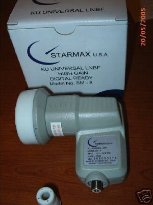

Hey guys quick question can I use this LNB for fta sats.
Brand new in Box, Starmax Brand KU UNIVERSAL LNBF
Model: SM-8
INPUT : 10.700 - 12750 GHz
NOISE FIGURE: 0.3db
I'm using my Nexus card cant find T-5. I'm using progfinder and a sat meter.
Can this lnb be used and what are the settings lof settings that is.

Yes you can
Yes it is a universal linear fta kind of lnb ....... As of getting something off of t5 you are giong to have to input a live transponder and s/r values into you;re software that you are using to work you;re nexus card You can do it in progdvb etc... Go to scan transponder etc... settings are in there I wish I can help more I personal have twinhan card etc.. and use the twinhan software with it .... Something that helps alot is a signal meter a cheap one And setting up elevation and aiming the dish and getting some signal off the meter and then connecting to the card and scan that transponder if you are on the right satellite channels will show up... It is hit and miss but a signal meter will help a lot I personal was not able to get anything with out a signal meter... as of lof setting you can input 10750 and turn off 22khz tone not needed for that satellite....

It is a Universal and you can set it up 2 different ways
you can set it up as Universal and then the LO frequencies would be 9750 & 10600
or you can make it a Standard and LO would be 10600 (as doc noted). Make sure to turn the 22K on
