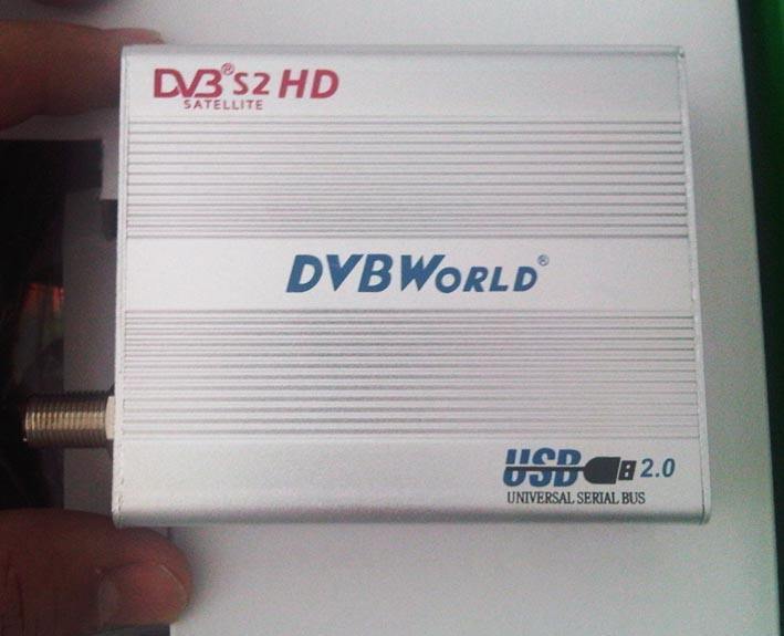

I have the same problem with SADOUN. I paid for a DVBWorld 2104D CA&CI USB Box and the sent a Box similar to the 2104C but HD.
Observing the DVBWorld Page, they show the two products as DVB-S2 USB and the description of the first one includes BLIND SCAN, and the second one omits those very important words.
The Sadoun page shows the second product as if it would have BLIN SCAN. I didn´t even use the box because the most important feature i need is the Blind Scan. I have read the first one uses the Montage Demodulator, i don´t know which one has the second one.
I couldn´t have the product changed from Sadoun, what you advice me to do?
I'm surprised they didn't clear up this mess between the two units. I complained and got $20 refund. I hadn't really intended on using the card system. Rather, I just wanted the blind scan.
It might help if you attached a photograph of what your were sent. The new 2104D looks like the old 2104C with the exception that it has no ventilation holes on the side of the box and there is no LNB output. I believe it works slightly better than the 2104C, so the chip set could be different.

Those ares some pictures of what Sadoun deliver as DVBWorld CA&CI 2104D USB Box:
According to the description gariac gave you have the one that does blind scan.I am not sure which chip the non-blind scan unit uses but the one that does blind scan uses the Montage M88DS000/2.
Yes, I agree that looks like the blind scan version. You can tell if you have blind scan just by running the dvbworld software. You can't get to the blindscan feature if you don't have the hardware.
To elaborate a bit more, there is only one flavor of the dvbworld software. It drives all the usb devices. If you have the blindscan feature, you will be able to access it. If you don't have the feature, you don't get the option.
