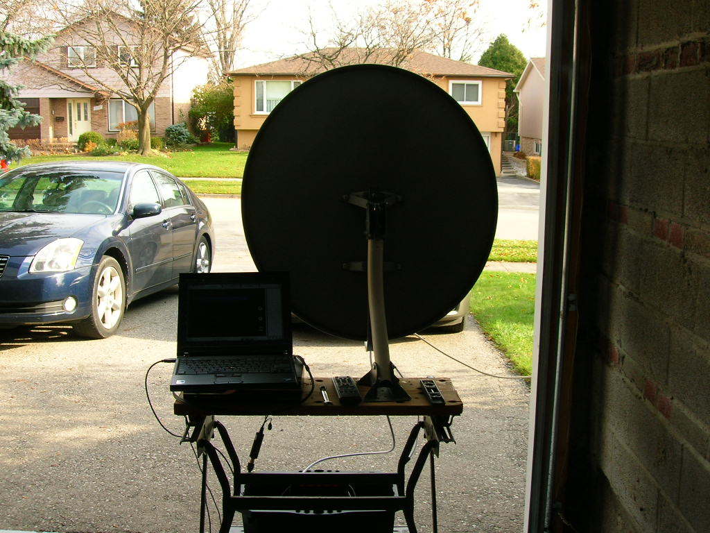

Great day to sat hunt. The temp is 50F and all the leaves are on the ground. Finally LOS to Telstar 12.

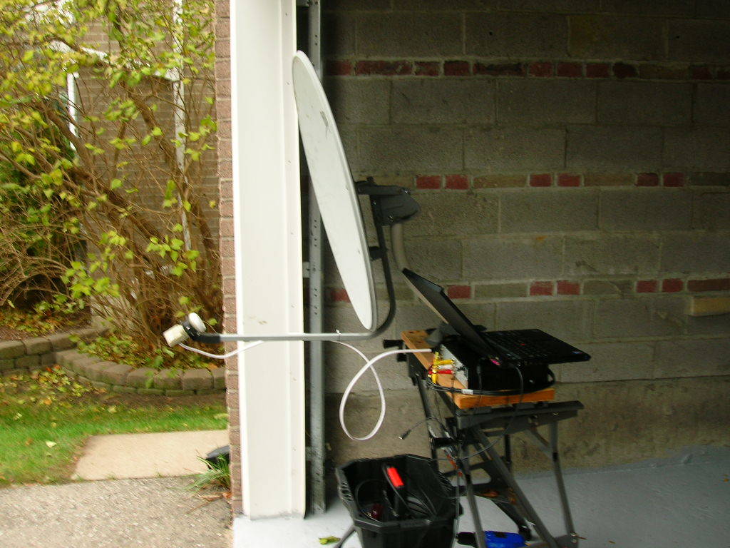

As promised I setup my 33" in the driveway and scanned in Telstar 12 @ 15W.
Took longer to set up all the gear than to find the bird. Took about 10 minutes to home in on the sat.
I have to give credit to Dishpointer.com for helping me.

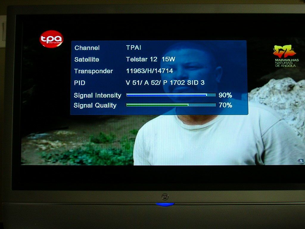

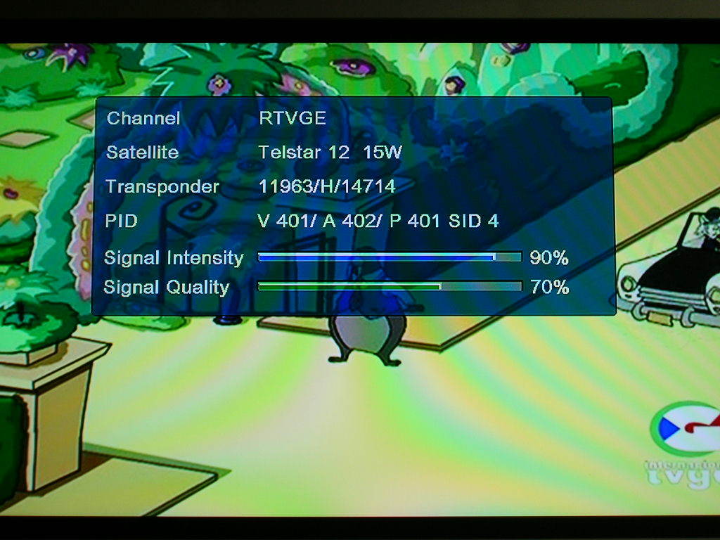

Scanned in 79 channels of which TPAI and RTVGE are ITC.

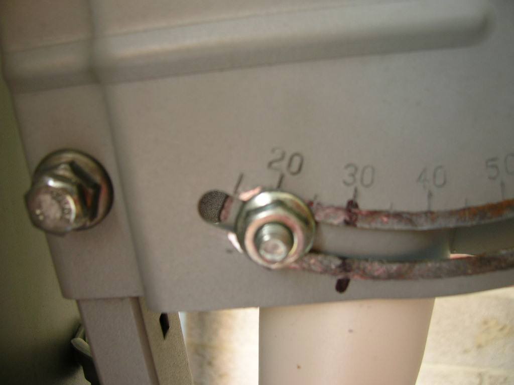

Forgot to mention the elevation markings on my dish are spot on. Dishpointer was 9.5[SUP]o [/SUP]and the elevation tab is just below the 10[SUP]o[/SUP] mark!
