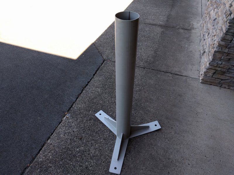

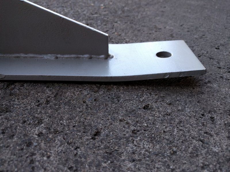

Important Note: In my case the mounting pole was damaged or manufactured incorrectly. Two of the three mounting feet were bent. When placed on a flat surface the mount rocked back and forth. I have no idea where this damage occurred, but since I wasn't planning on using it, for me it didn't matter, but I wanted to report the issue here. The photos below show the issue.

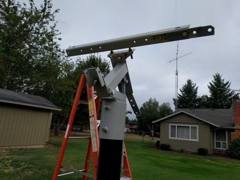

Photo 1: The full mounting pole, you can't see from this view, but the feet are bent, the next photo shows this.
Photo 2: Shows a closeup of the bent foot:

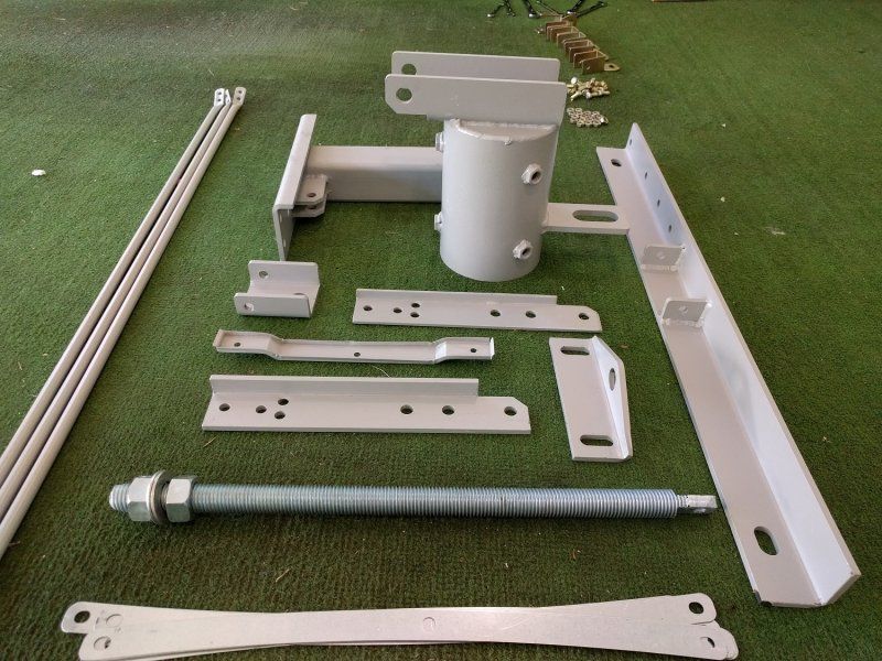

Photo 3: The various brackets and pieces for the mounting hardware

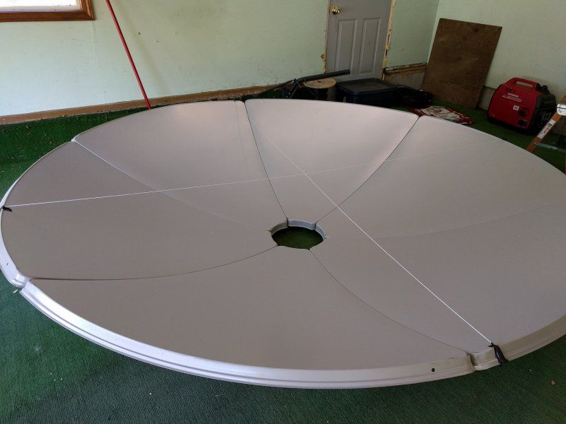

Photo 4: The finished reflector undergoing the string test on my garage floor

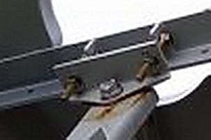

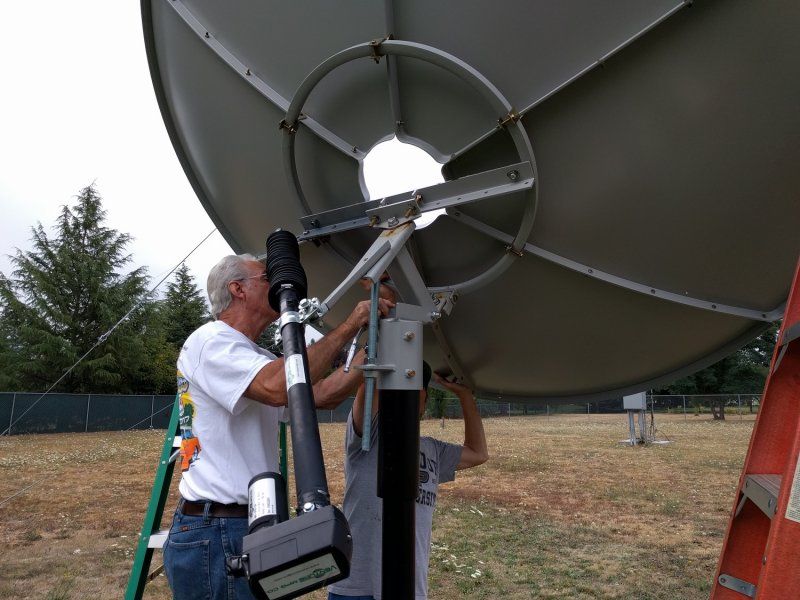

Photo 5: My helpful neighbors assembling the reflector to the mounting hardware

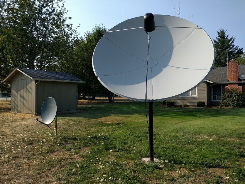

Photo 6: The completed dish, also showing the Geosat 90 dish

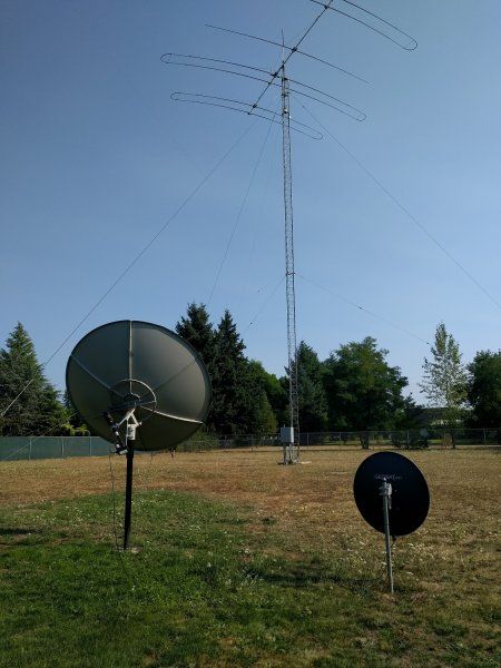

Last Photo: Overall picture showing dishes and my ham radio tower in the background

Performance wise I'm happy so far I'm receiving all sats from 87W to 137W. I could point further east but there doesn't seem to be much of interest there.
I think you made a good decision not to use the supplied mounting pole. It looked like it was a bit thin walled, and the the 3 mounting flanges I feel, just aren't enough, especially in a high wind situation. Unless the anchor bolts were installed in the concrete at the time it was poured, I'd be really uneasy using inserts in holes drilled after the concrete was set up. During the 30 years I installed dishes, I've seen some pretty amazing things happen to dishes and poles.
The dish itself appears to be pretty well made, and that little extra signal gain over wire mesh can make or break reception on some satellites. I made an exceptional find last weekend when I stumbled onto an absolutely perfect 12 foot wire mesh dish made by Perfect 10. The screen is perfect, nothing is bent and even the paint is flawless. Looks like it's been kept inside a garage all its life.
It's on a non-penetrating mount, perched on top of a guys garage on a pole that's just tall enough to allow the dish to clear the roof. The guy cut the hill away and built the garage 4 feet from the bank, and we should be able to put a couple 4x4's across the gap and slide the dish off the roof and onto the ground behind the garage. He even has a road within 10 feet of the garage roof. Can't get luckier than that. :)
The guy's going to build another story on the garage and want's it out of his way. I have a pole just waiting for that baby. We're going after it this weekend. :)
That's a good point, the supplied mounting pole was thin walled, maybe 3-4 mm. I don't know if you can see in the photos but my neighbor welded a 4 1/2" sleeve over an existing 3 1/2" pole, and got it to within 1 degree of being plumb.
It works well the other way too. I've taken 4 1/2 and slid a piece of 3 1/2 inside it and welded around the joint. A 2 foot stub of the 3 1/2 driven inside the 4 1/2 makes a very strong pole for high wind situations. If you don't have a welder, you can drill a hole through both pipes, put a nut and washer on and tighten it down and it prevents the inside piece from spinning inside the other. To cut either pole square on the ends, you need a Ridgid 2 blade commercial pipe cutter. It makes a perfect cut for the dish mount to sit down on.
A cutter that will cut up to five inch pipe cost upwards of $500 now, but I've had mine since 1983 and paid $350. I planted a pole last weekend that had been cut with a band saw. Rarely do you see a band saw that cuts square. Too much flex in the blade. I'll trim 2 inches off it with the pipe cutter tomorrow so I can set a dish on it this weekend. I did see the welding job on yours. Looked like a great job.

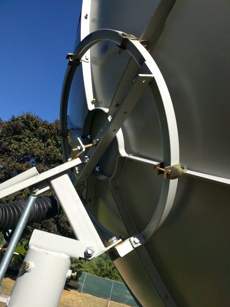

In Miami, when you're standing behind the dish looking at the back, the actuator arm will go on the right side of the dish. When the wires are hooked up correctly, the dish will get lower when moving West, and higher when moving East. On some actuator control boxes, like the Pansat I have, the East & West limits are backwards, which means that box was designed for the West coast. You have to remember that when programming one of these boxes.
With the limited number of control boxes available today, you're not likely to run into that unless you purchase a Pansat. It's better to take your time assembling the dish than hurry through it and make mistakes. Good luck

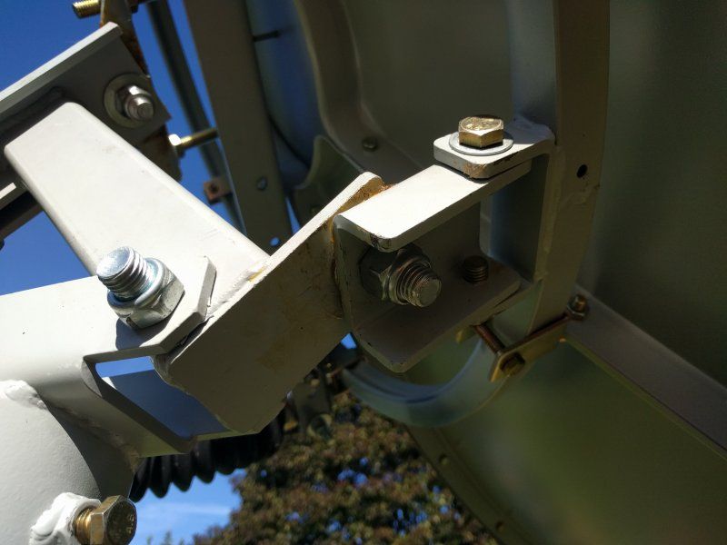

That's an interesting mount, the dish looks like the generic Jonsa/Fortec Star but I've never seen a polar mount available for it so is this something that Tek2000 manufacture themselves? Just one question if I may, is declination set using the two bolts in this pic?
Correct, the two bolts you highlighted adjust the declination offset. The bottom of the dish has a small pivot point and the two bolts adjust the pivot.
