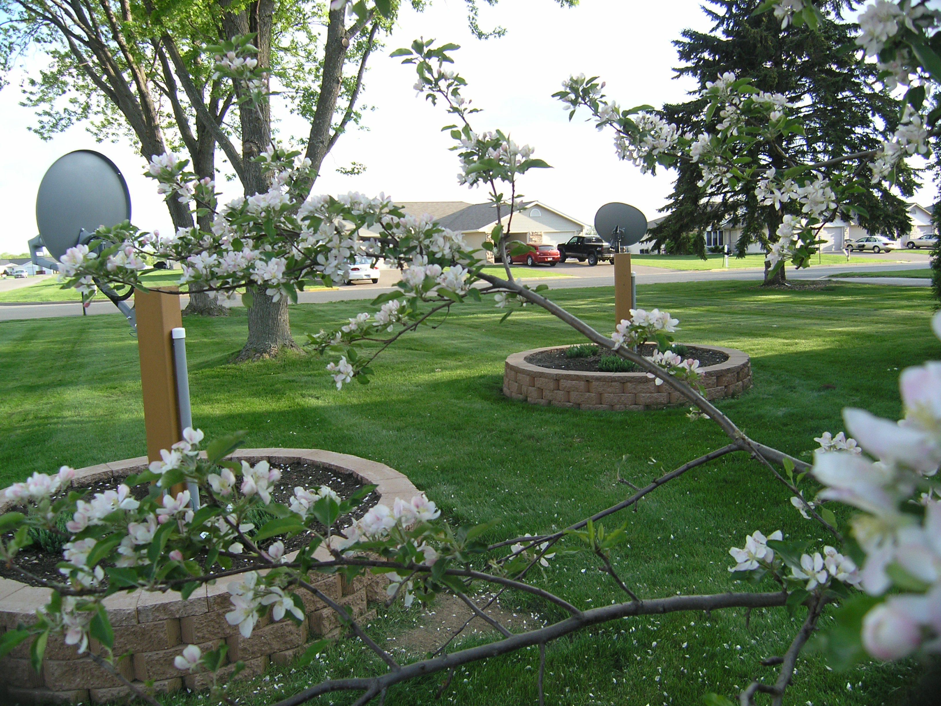

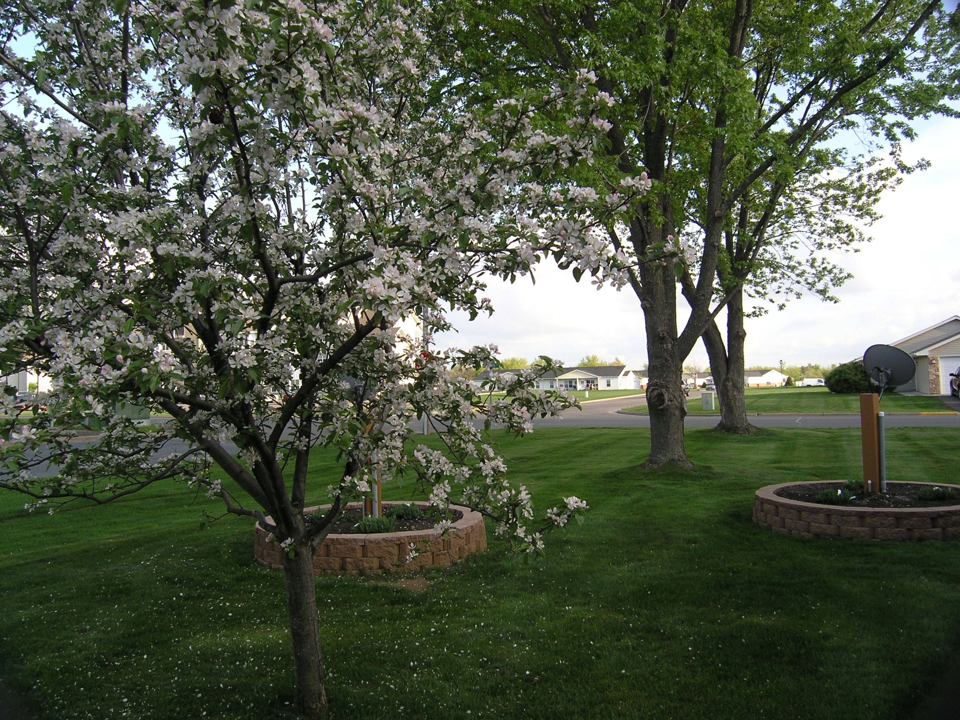

Well I solved my problem with just putting another "satellite shrine" next to the other one. I had the first one up and then wanted to get 61.5. No dice with the large tree in the way. Only way to get it up was 1, cut down tree, or 2, put up another planter. I did # 2.
Hope this helps.
My avatar shows some of what I did. I will add some other photos of the "farm"
Lyle
Hope this helps.
Lyle
That's so cool..I wish some of my customers would allow this type of install..Too many times a customer will insist upon a roof mount where I must climb like Sir Edmond Hillary.
Thanks for the comment.
I've had some interesting conversations with people who come and ask what those things are in the yard. Especially the one with my wife!
The installer that came and put up the Dish 1000 was really happy to just be able to stand next to the post and only be 2 feet off the ground. I know this isn't the only solution to the problem, but, I was able to get mine solve this way.
Good Luck:
Lyle
