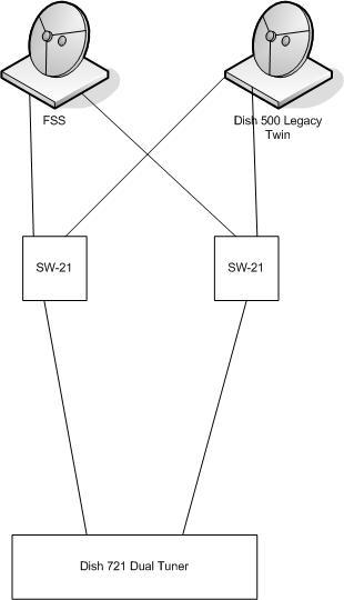

Iceberg: Don't dual output voltage-switchable FSS LNBFs exist? If so, Legacy Twin, Dual switched output FSS, and a pair of SW-21's will git-r-done. ;)
yes they do. I have a dual on my FTA system.

OK, here is a .jpg of what I think you are telling me I can do. If I'm on the right track, the best thing is all I need is a FSS dish that has dual switched output that opperates like the Legacy Twin 500 LNBF's. Is this right?
If so, Iceberg, can you tell me where you got yours or point me to a website with a picture so I can make sure I'm getting the right thing?
