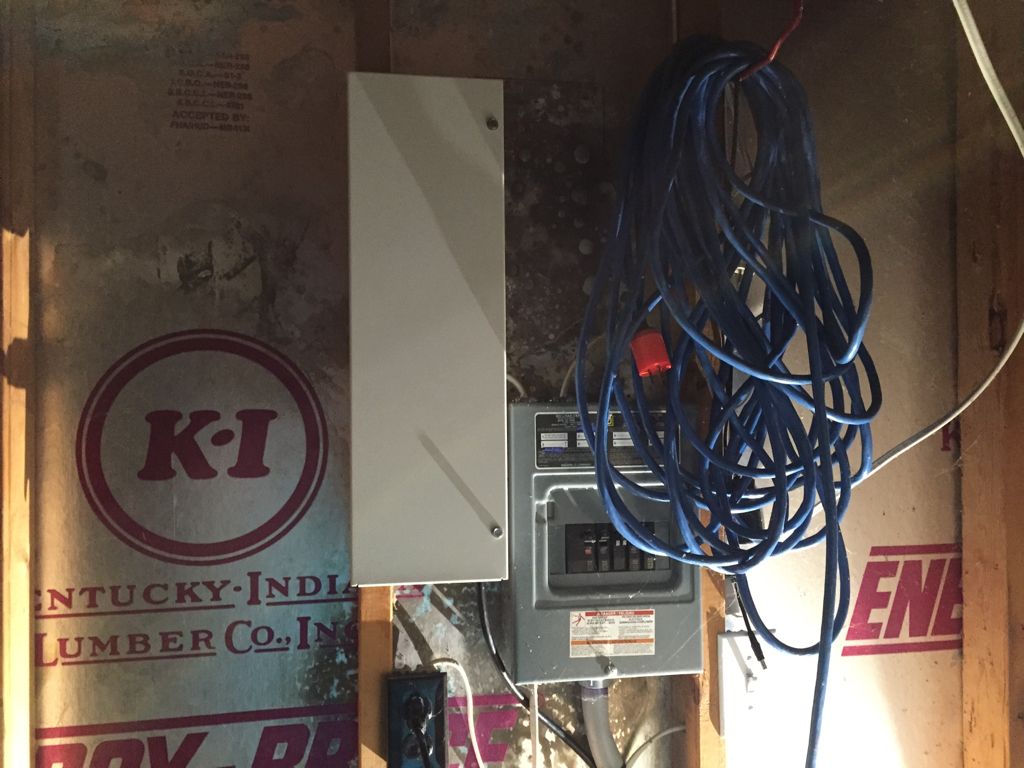

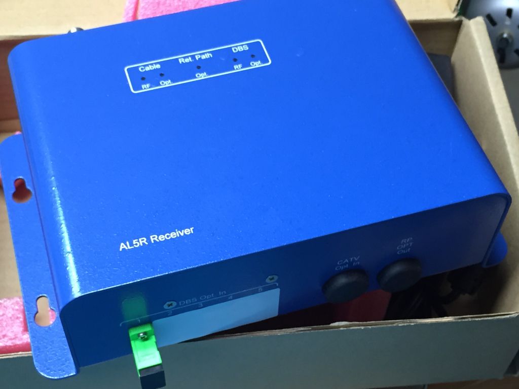

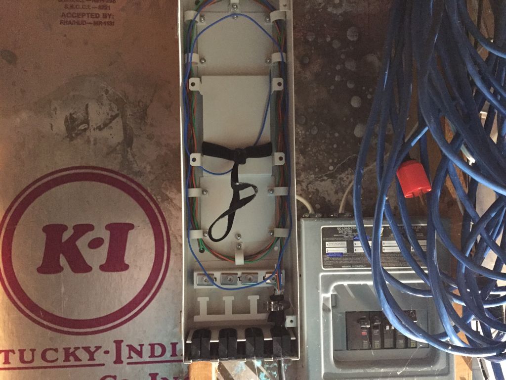

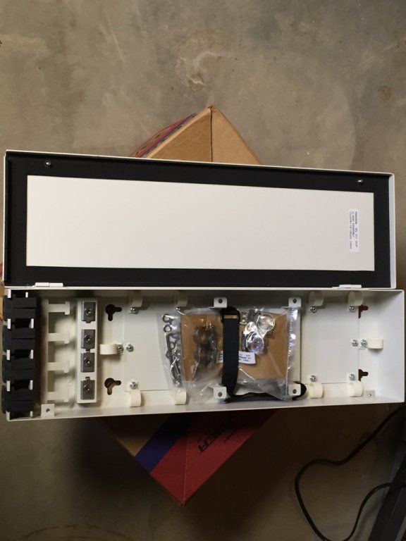

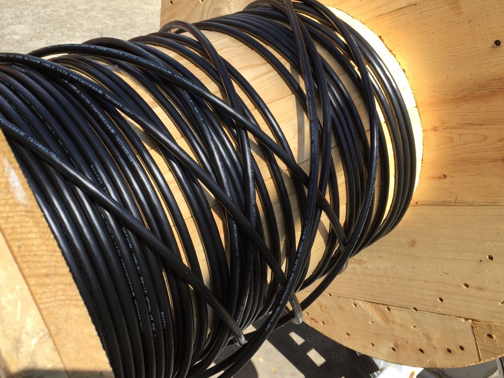

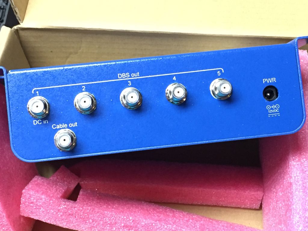

Ok, so got some extra 48ct Single Mode (SM) going to run from back garage to house about 80 feet away. Going to hook 5 different birds from different lnb's up to just one fiber then break them back out to RG-6 behind my TV. Going to use 6-ct SM from basement to family room. Both enclosures mounted inside will splice in SC APC ends from pigtails.
Breaking it up into parts.
Part 1

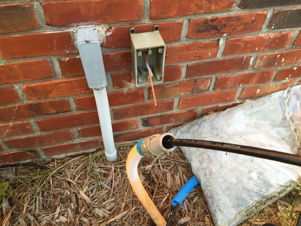

Put the conduit underground 4 more feet in flower bed. Pull the cable 48ct cable into both areas.
That's my goal for today.

Being able to not have to run (5) RG-6 cables :) Just having fun really :)

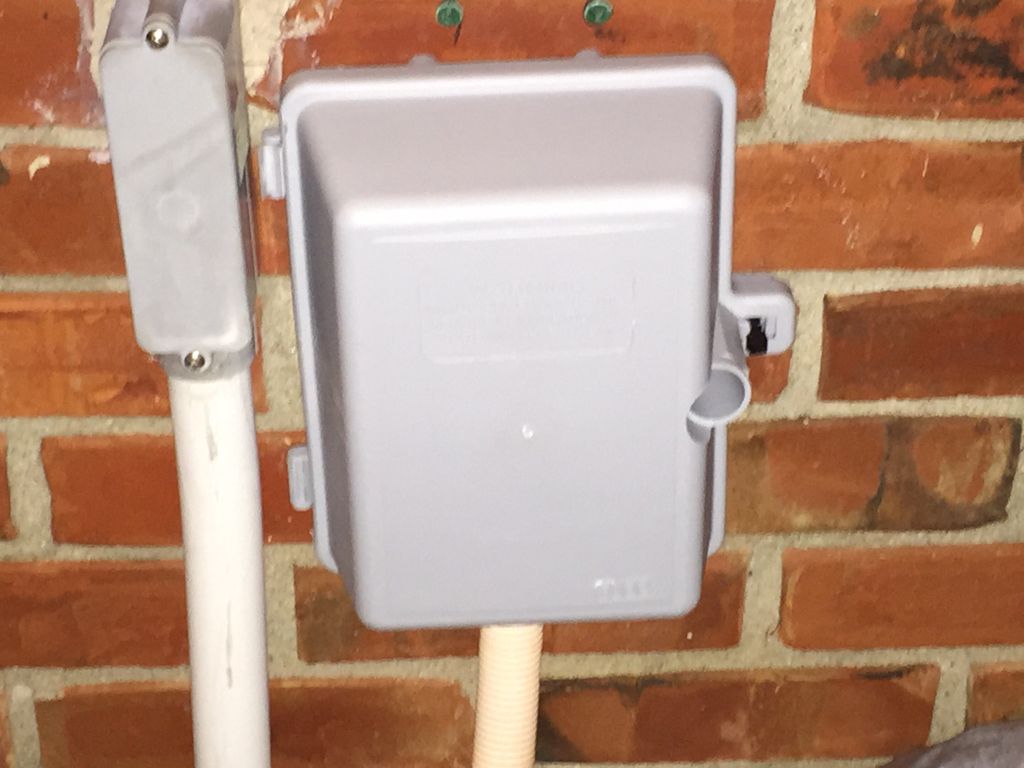

Part #1 halfway done fiber is pulled one hole drilled one more hole and bam.

Box is mounted had to leave an angle on pipe so the bend into garage would work.
Reactions: KE4EST

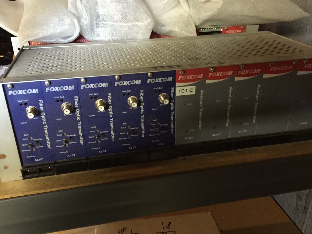

I just looked up the cost of those Foxcom fiber optic transmitters and AL5R receiver. WOW! Great project, but I think I would install 5 RG/6 coax runs to save money. No update since last Sunday, what's taking so long? :)

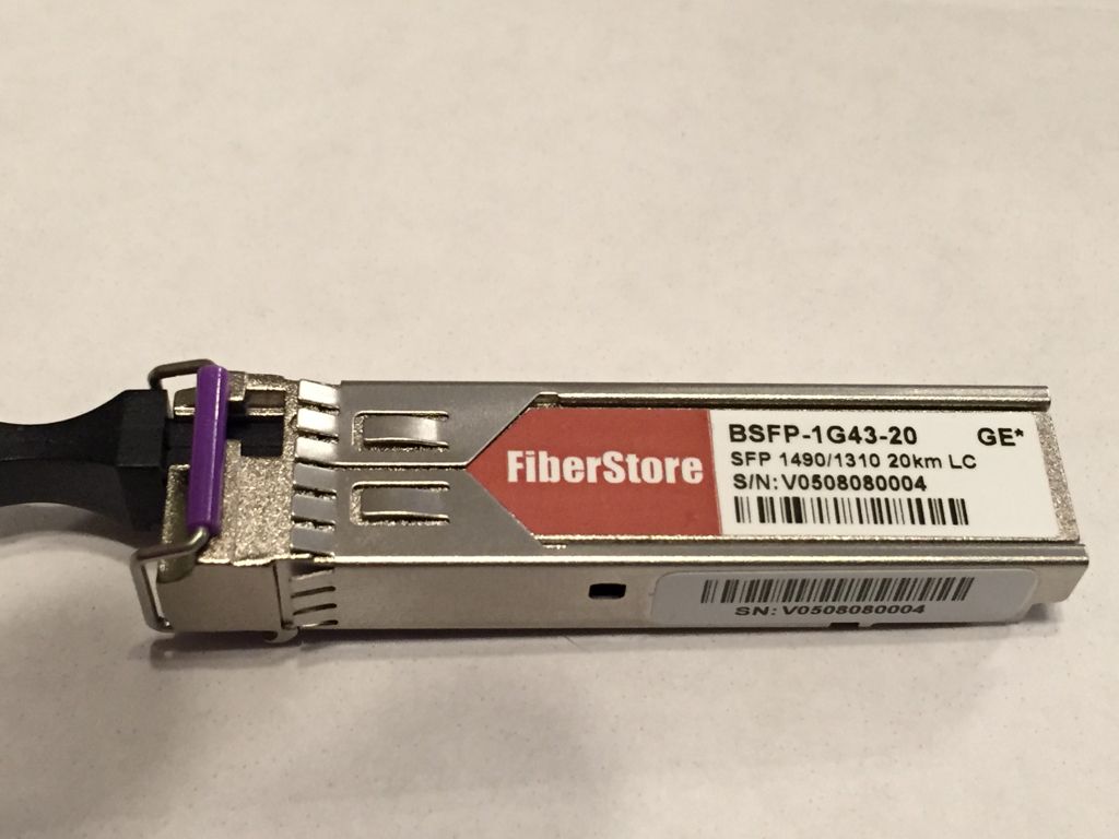

I got some BiDi SFP's also so I can run Gig between basement and back garage over just one fiber :)
