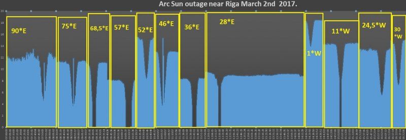

Biannual periods of Sun outage are nice times to check whether your antennas properly placed and maybe need some relocation.. It is also possible to do some experiments. Good site to see dates and times of the outage is here.
I've recorded strength of signals from 12 satellites (in Ku band) 2 days ago. From all the data (> than 5000 independent measurements) build this graph. Vertical axis is signal strength in dB, horizontally- time. Had some fun :bday

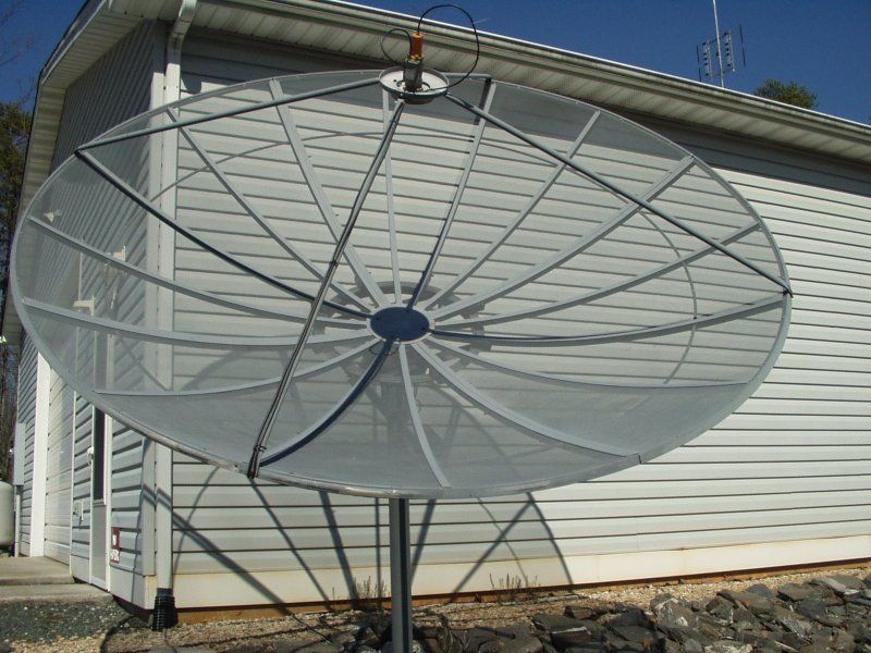

What's been happening is I set it to record the Cops Reloaded show on KRBK @ 1pm Eastern and the past few times it hasn't recorded all of it and what's there is pixelating and it just stops recording?? I'll try to remember to check today to see if the shadow is near the center of the dish.
Thanks
Well, just went outside a few minutes ago and took this picture around 1:55pm. So this explains it. I guess I could take that plastic piece off that the old feed horn cover fastens to and see if that "might" stop it?
Reactions: toucan-man
I don't understand what removing the feedhorn cover support will do? It is RF neutral and shadowing the center of the dish. The shadow in this photo indicates that the sun is directly in line behind the satellite.
The DVR recording is stopping due to loss of signal as the sun passes directly behind the satellite position. The noise generated by the sun is stronger than the satellite signal.
