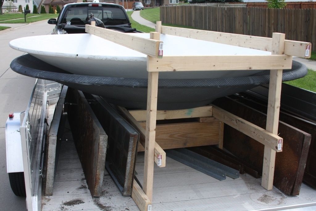

Because the sides of the borrowed trailer were so high, I had to fabricate a box mount underneath the dishes to raise them up, so the dish edge would protrude out over the fender wells. 2x4's across the top keep the dishes down on the base. In the picture below, the feet of the NPRM are also loaded in the pickup at this point, on either side of the wood base...

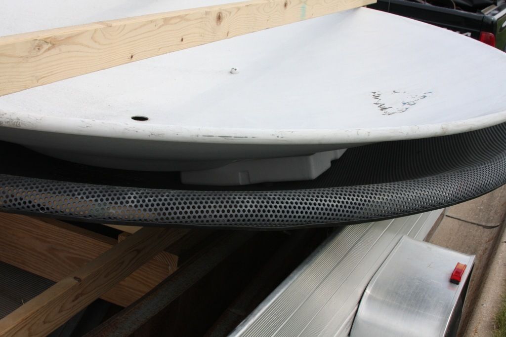

The dishes have two pieces of styrofoam between them, so they don't bump into each other on the ride home. With this setup, the dishes are secured in the wood frame, without the top of the frame touching them. This allows the whole crate to be strapped down very tightly, without bending or damaging the dishes.

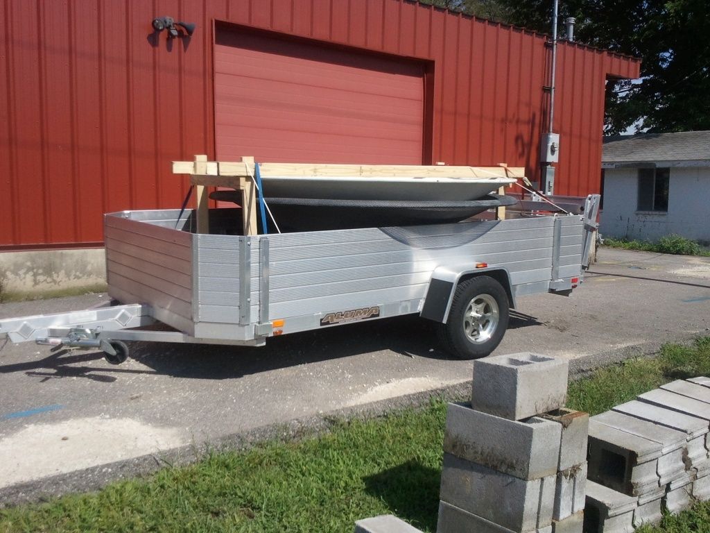

There's a picture of the whole thing loaded and ready to hit the road from linuxman's house at 4:30 Monday afternoon. I thanked him and his son, who also helped load the motors into the pickup, started up the truck, and crept carefully out of the parking lot.

Very creative use of lumber.
Interesting seeing the two dishes stacked one inside the other, too!
