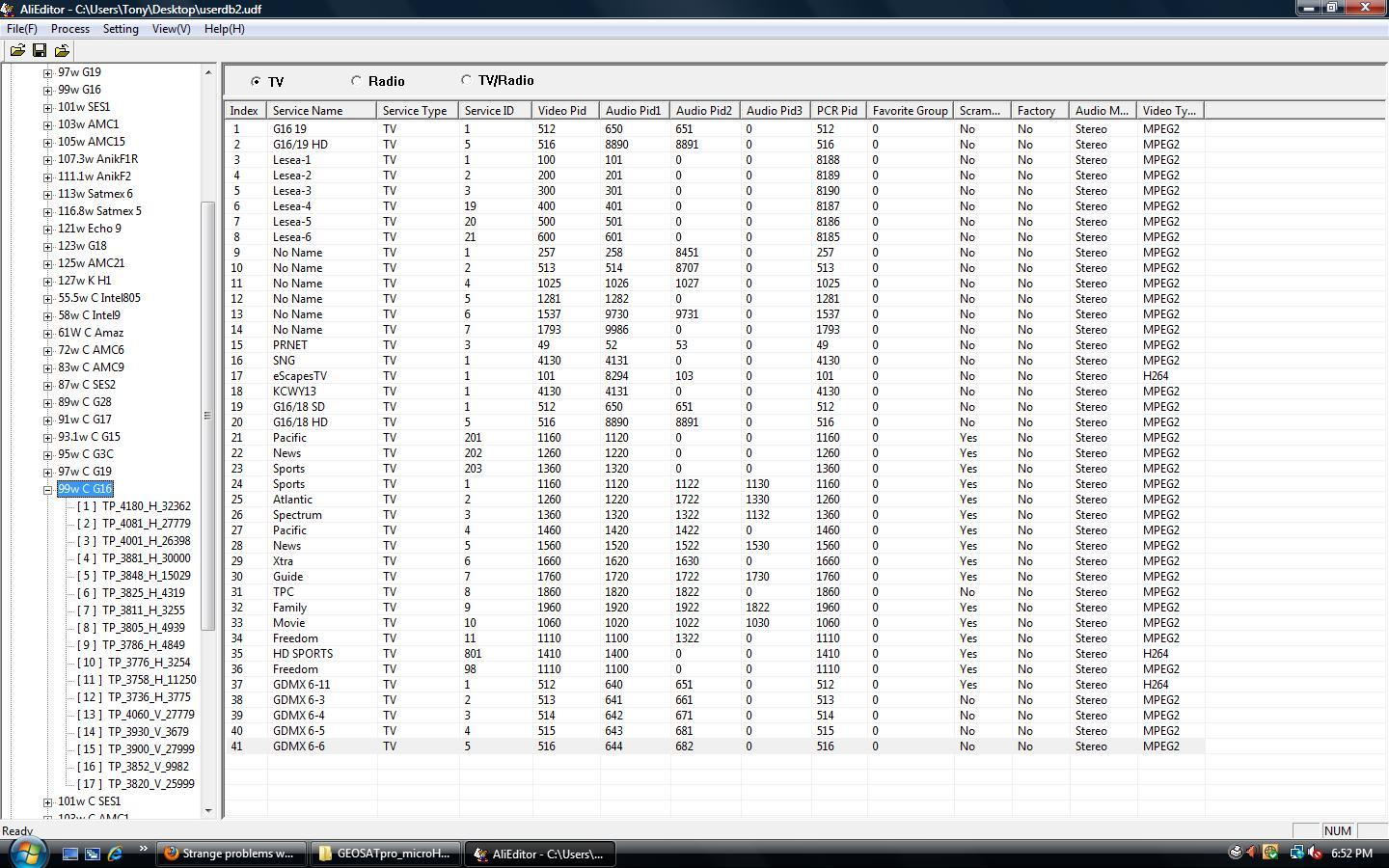

Here is a pic from the editor of what I got yesterday.....I had some bleedover from 97W so those channels were removed
