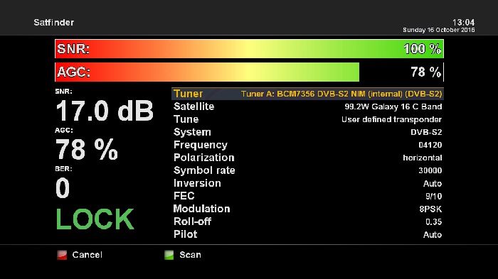

There is no doubt in my mind what we are dealing with is dish size.Rest assured a 10 footer will keep a lock on this 8psk 9/10 signal...Ur doing good John with the 7 1/2 footer...Here is a screenshot from a 10 foot KTI with an ortho feed using Cal Amp PLL`s....Nothing ur doing wrong..Just dish size!.

Hockeynut,
Thanks for your words of encouragement.
Aside from dish size...why is this feed sometimes working for me and other times not ?
Is it the varying strength of the signal or just plain luck ?
John

You are right on the threshold for those particular signals.To confirm just click east or west with the ASC1 and see if the signal completely drops.
