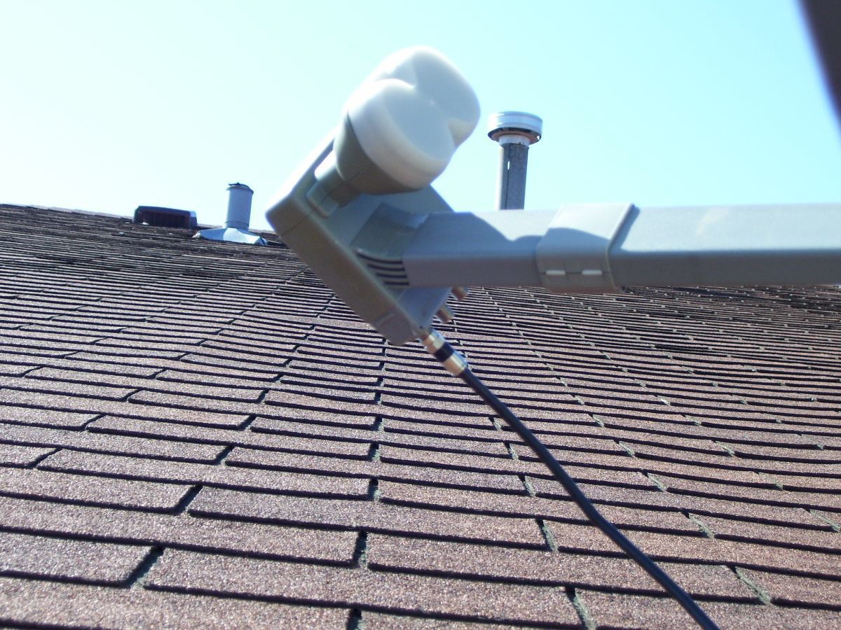

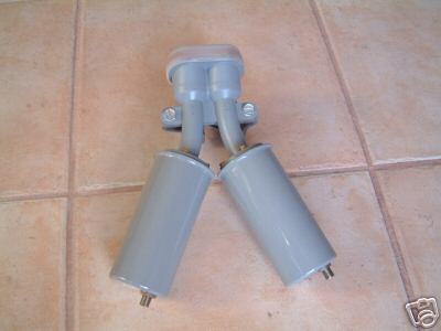

Never heard of goodyear but here is the info. Ask what dimensions the dish are. If its 37x27 that is the 75e (the 60e is I think 32x20). Here are the numbers. Also ask what the LNB looks like. There are 3 types...pics are below
-single (this is the old style LNB that looked just at 107.3)
-beer cans (these are 2 LNB's that have a single connector output and had an external 22k switch to combine 107.3 & 111.1
-quad (most common)...2 LNB's built into one with 4 outputs.
Here is where to get the aiming numbers...if the dish is for both satellites use the numbers on the right.
global-cm.net/CAN/SC/point/USAangskew.html
pics are in order
single (flashlight), beer can, quad

Thanks for the quick reply guys!
He said it was a 73cm dish, which leads me to believe its the 75e because 73cm is ballpark for a 27" wide dish.
He states he has the service currently in Canada and that they have a snowbird program so I doubt address issues will come into play.
That link you gave me shows a skew of 89 degrees so I am assuming that there would be no other polarization adjustments.
After posting this I started to do my own research and found which satellites to point at. Then came the fun part of trying to determine look angles. The ones I came up with coincided with that link you provided, although my skew was -2.85 degrees. I was suspect about that though considering that the two satellites are pretty much dead south of here. -1 is definitely more reasonable. In any case, I figured they were close enough and dead south enough to play with skew pretty easy.
