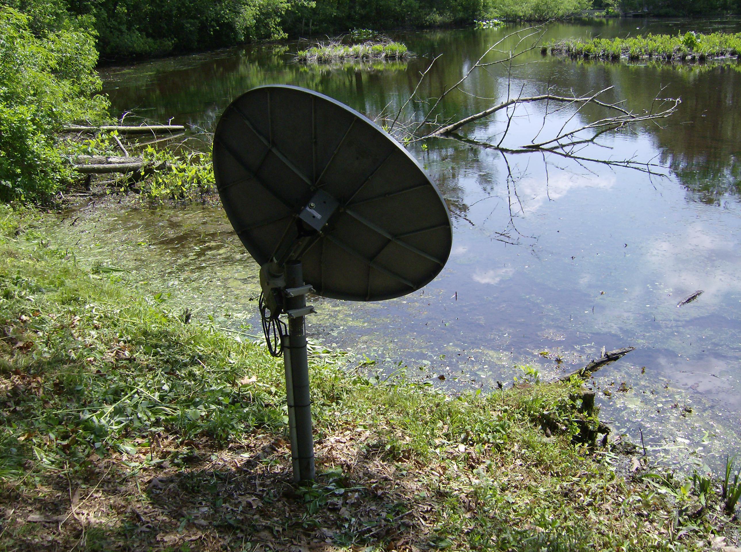

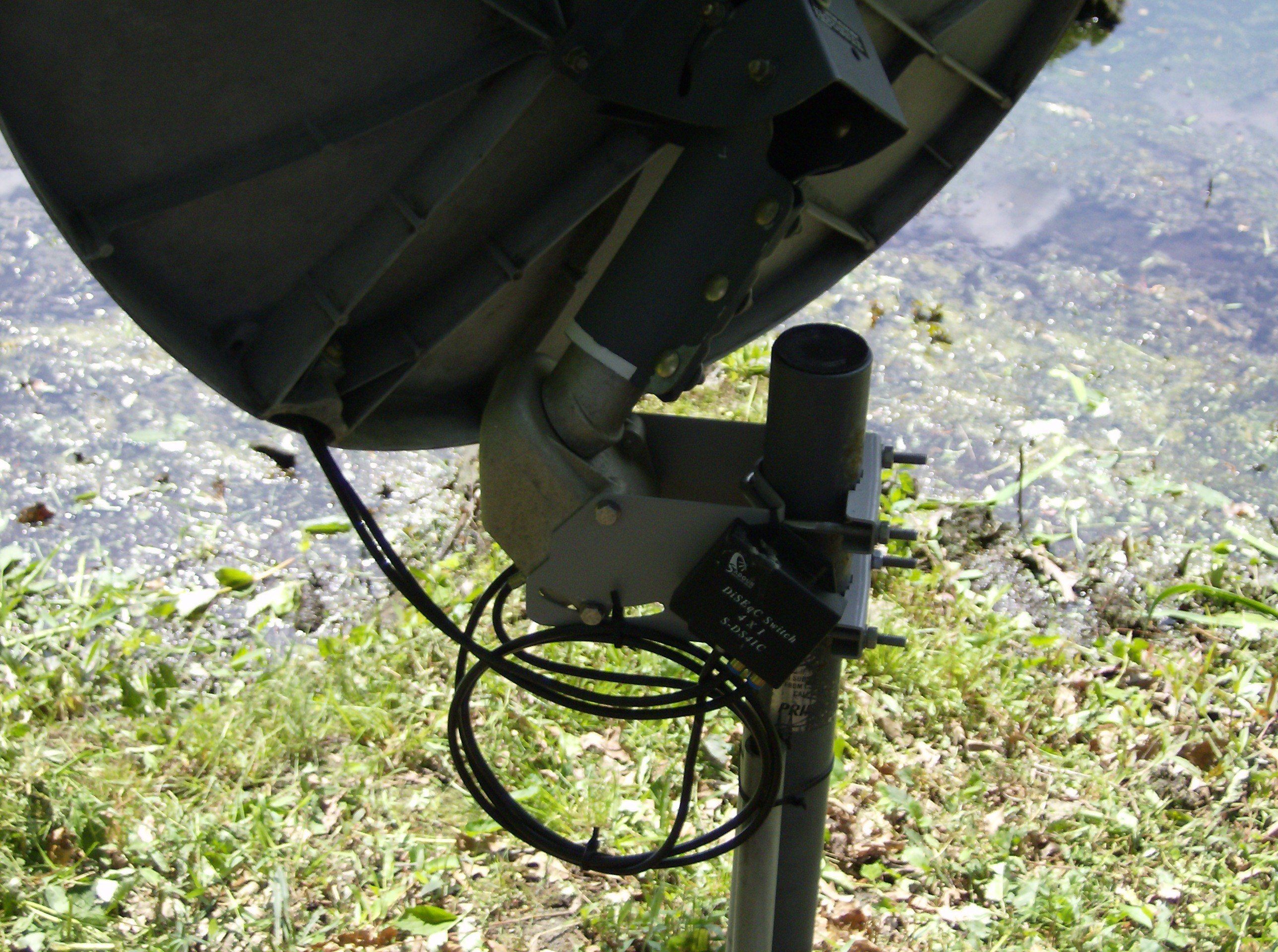

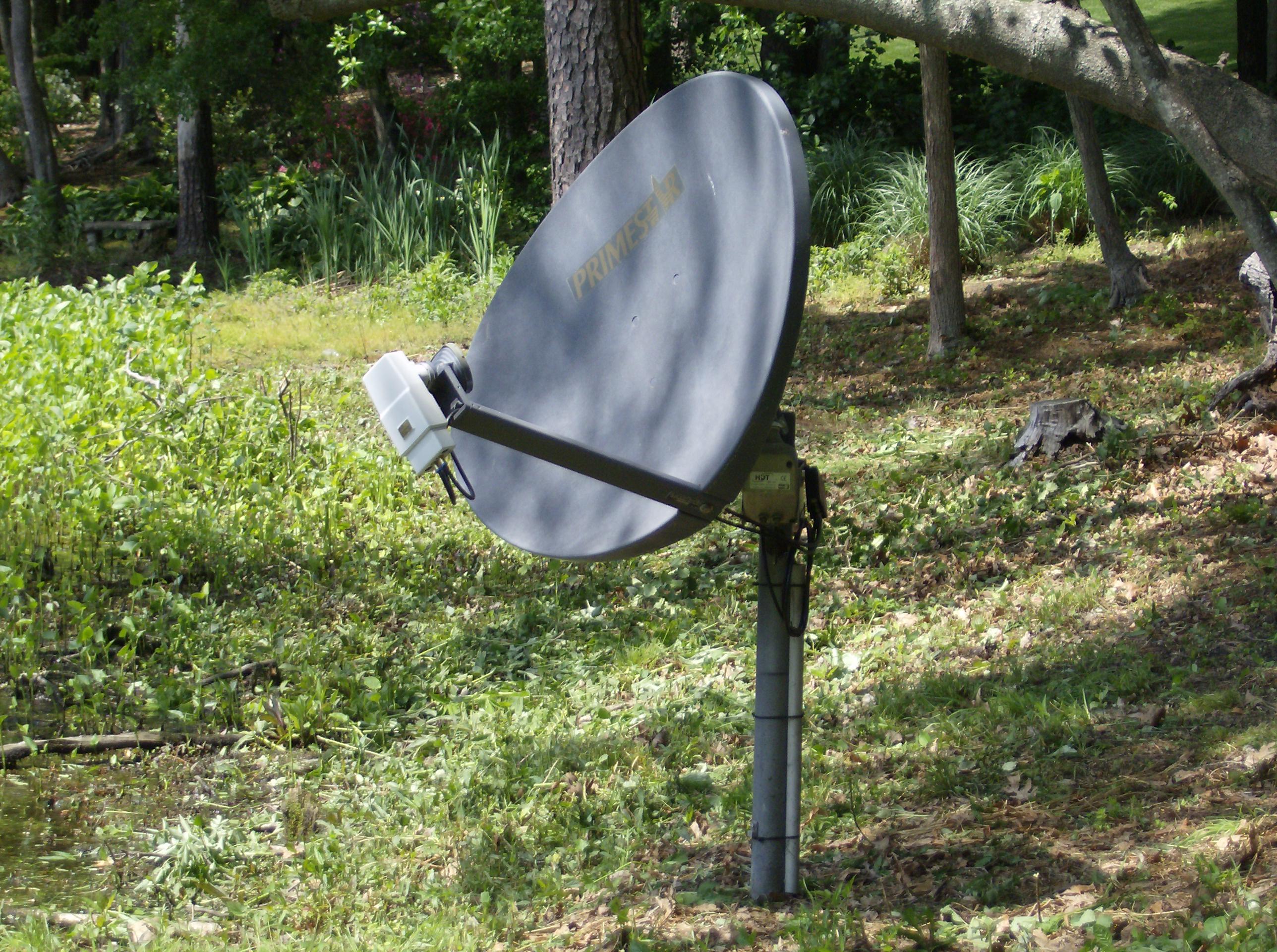

Been using an HH100 with my Primestar 84E for about 6 months. Shimmed up the mast with a piece of PVC pipe - works great!
