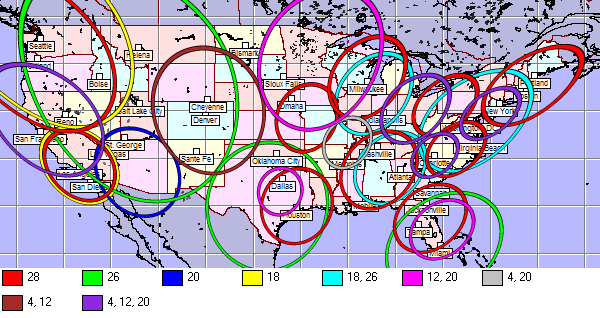

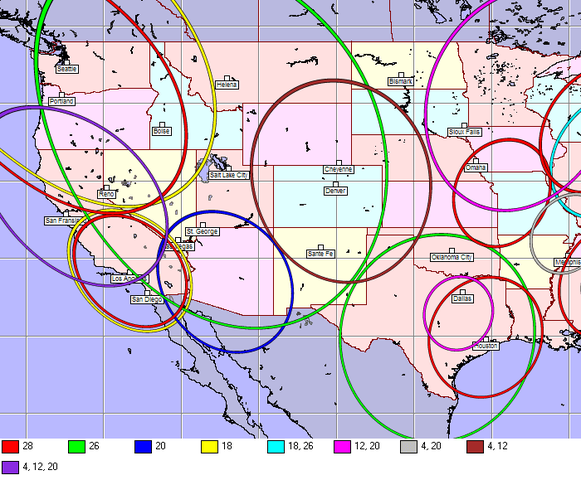

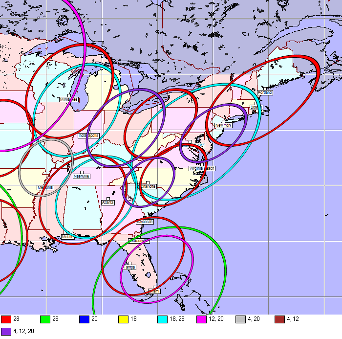

Please note that I said the size of a spot was "general" and "not perfect". Some DMAs overlap, some are much larger than others "depending on the DMA". Use these older maps as a sample reference; maybe someone can post some updated ones.
