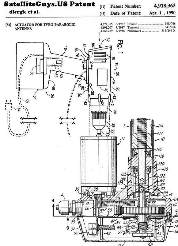

I pulled the end cap off of the motor on one of my actuator's, and hooked drill to the armature... but you might want to wait until you are sure the motor is bad and not the wiring... hook some lamp cord to the motor and touch to a Car Battery and see if it moves...
See attached illustration
