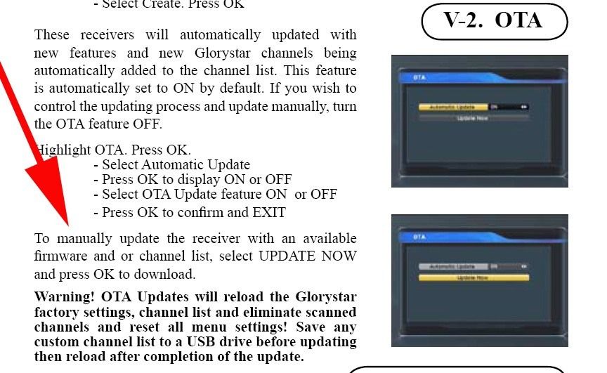

Sorry, but I believe that our team did not give proper advise on this issue. Channel 106 is the strongest channel on AMC4 and 107 is a strong channel on Galaxy 19. If all other channels are coming in with at least 50% quality, then there is no reason that these other two are not.
We would suggest performing a factory reset. Once performing a factory reset, if these two channels still are not coming in, perform an OTA update. Open Menu> Utility> OTA> Manual Update. The step by step instructions with screen captures are in the Installation Guide / Owners Manual and in the attachment below.
If you do not have a manual, you may download it here:
http://glorystar.tv/portal/11/documents/DVR_DSR_Series_HiResV1.pdf
If these channels still do not come in, we might suggest bypassing the 22KHz switch and directly connecting directly to each LNBF to test the channel reception of each channel. We would also suggest a Master Firmware Reset procedure before taking any RMA steps.
