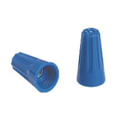

I think he's referring to something like the below. You can get them at any hardware store. Read the box to see which gauge you want- e.g. 1 22 & 1 16.
Soldering would be better, but would be overkill. So long as the connectors stay tight, you'll be fine. I wouldn't worry about it- you only have 22 gauge anyway, which is kinda small.
Thank you very much for the electrical cap (wire connector) suggestion! After a trip to Lowe's and a mere $14 worth of wire, connectors, and wire strippers, my system sounds great with no more hum. Problem solved!
